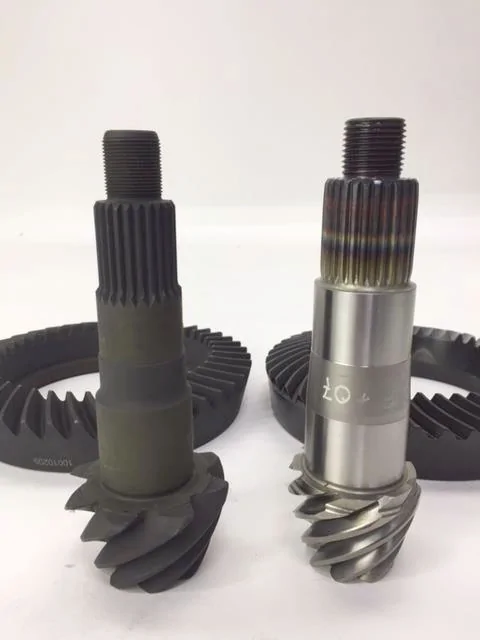

Now one thing that does become a problem can be pinion gear size on deep gearing that could become a issue and the weak link. I wouldn't go to a 4:88 or lower with old D44 axles due to pinion gear size maybe with the "new" D210 in the JT's I'm not sure. That was a big reason many go to D60's not just axle shaft size but for larger pinion.

What I'm hearing from guys that do the installation is that they recommend up to 4.88's but that the pinions get a bit small for their comfort at 5.13 and up. But each has also said they've not seen anyone break 5.13's, either. It just makes them nervous.

You do lose a pinion tooth from 4.88 > 5.13 I believe but I'm not sure I'd be worried on 35s or even 37s as long as you're not going full send all day long. The pinion shafts are massive compared to the JK D44 (see below, those are both 5.38s) and the teeth are wider/shallower than in the past which adds a lot of strength against shearing.

So I believe this was true for the JK D44 axles, but I'm fairly certain the AdvanTEK D44's in the JL/JT all use the same 8 tooth pinion for 4.88, 5.13 and 5.38. Only the tooth count on the ring gear changes (39, 41, and 43 respectively). 4.56 has a 9 tooth pinion and the 4.10 picks up 10 teeth. Don't quote me on that as Dana has updated their site and it no longer lists the specifics for any ratio above 4.10, but you can count the teeth in the pictures lol. Agreed thought... you should be fine unless you are going crazy. In that case, take a look at dynatrac or currie axels.
https://spicerparts.com/parts/axle/...ring-and-pinion-gearing-for-jeep-gladiator-jt
