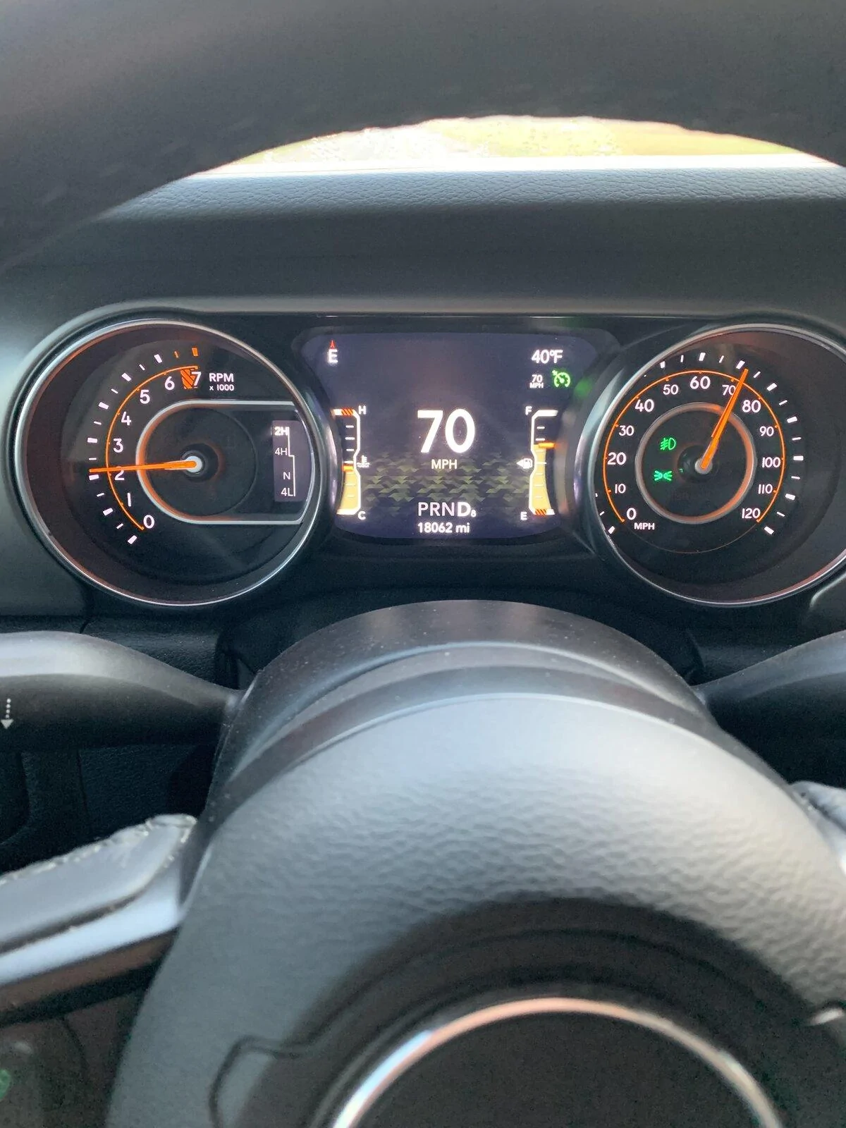

How are you liking the 488's and 35's? What rpm are you turning at 75mph? I've got a manual JLUR with the 6 speed and am deciding between 4.56 and 4.88's. It's not bad now with 4.10, but I just want 6th gear to be more usable without making 1st too short. Right now I'm thinking 4.56's are the sweet spot, but haven't heard from anyone running 4.88's until now. I'd love to hear your feedback after living with it a bit.
Loving it. I’m finding I’m in eight gear at about 42-45 mph usually. Rpm at 65 is 2k
I just ordered 4.56's. I know if I had the heavier Gladiator I would have gone 4.88's. I'm really looking forward to being able to pull 6th gear like it should instead of limiting to flat land or down hill. It'll also turn 5th into a better hill climber on the highway, particularly in the mountains.

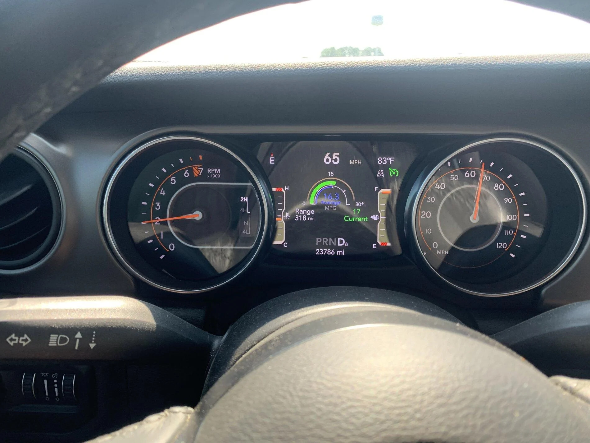

I’m running 315/70-17 with 4.56 and I’m in 8th around 43mph as well.
Right at 2k at 65mph

I see 8th is 0.67 ratio, which is a little taller than the 0.72 in the manual, so it should be pretty close.
