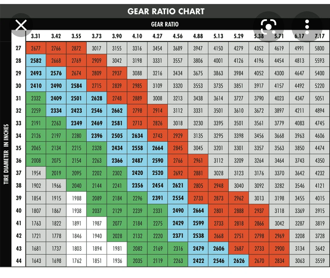

I also have to remember to set the Tazer to the new ratio.
