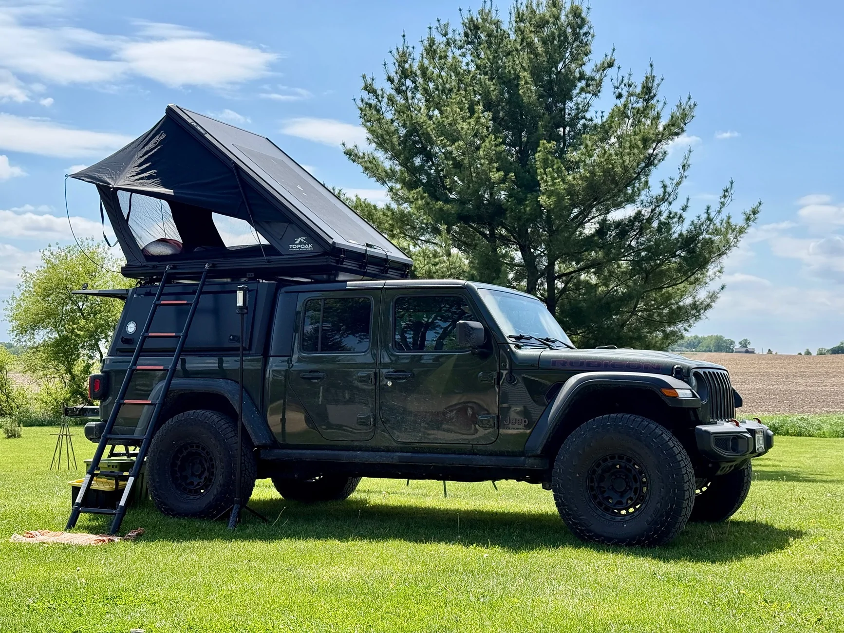

here's a few older pics of it on mine before upgrading

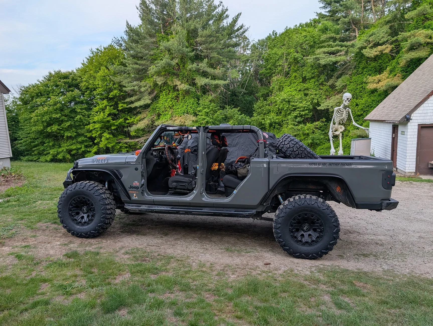

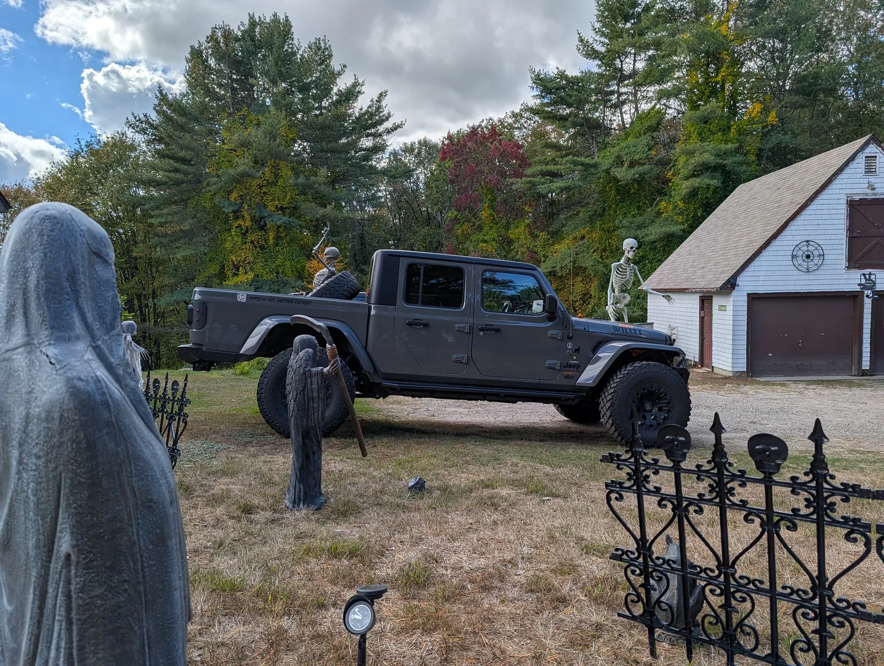

It leaves the factory rake. Here's mine with 37's. Billstein shocks

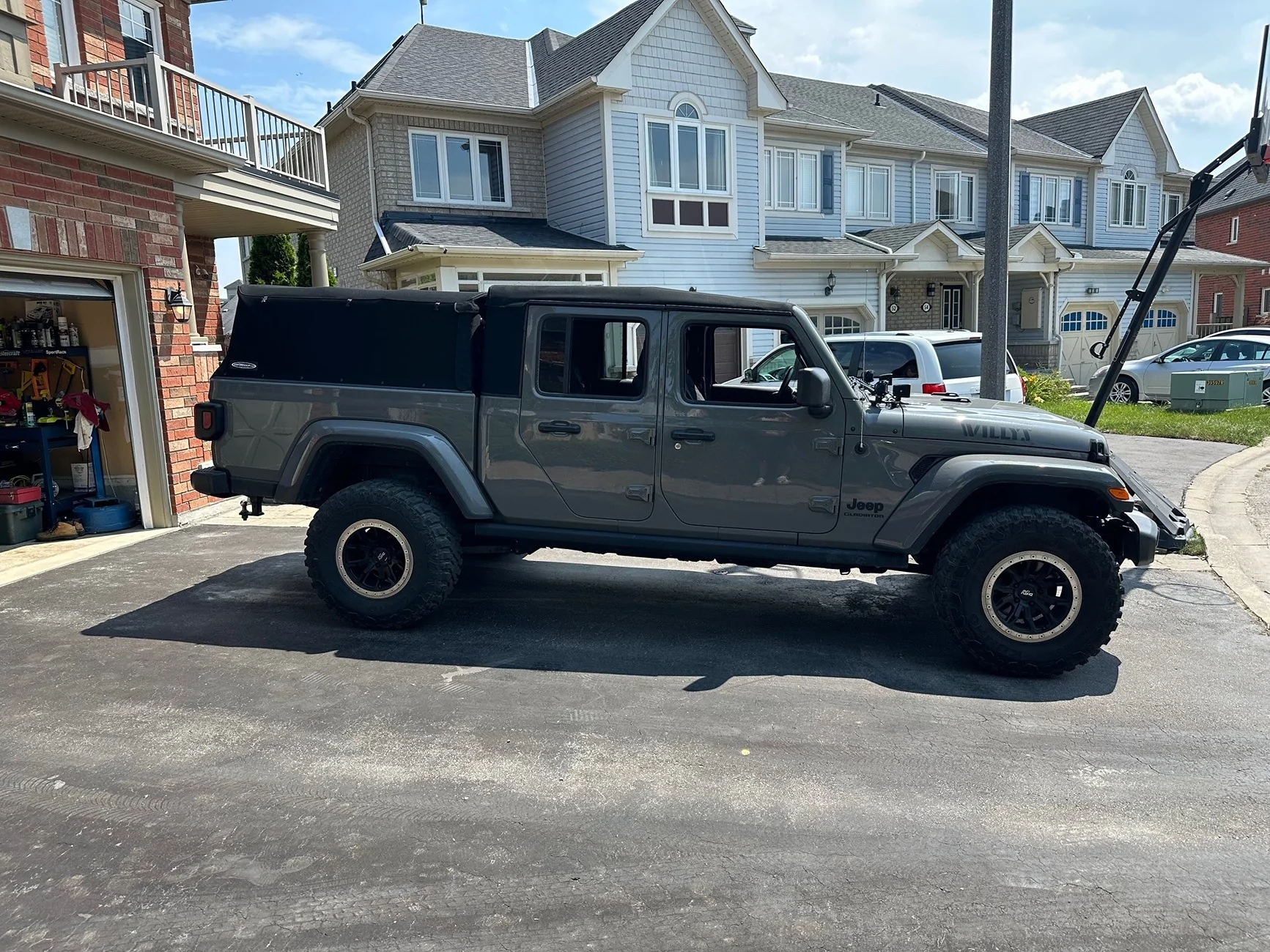

Willys shocks. No problem with them.
35" and heavy rims on 3.73 gears and still hit 8th.
