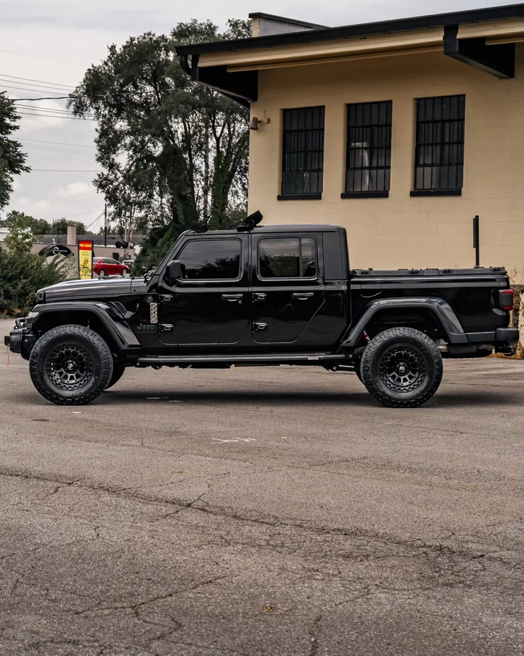

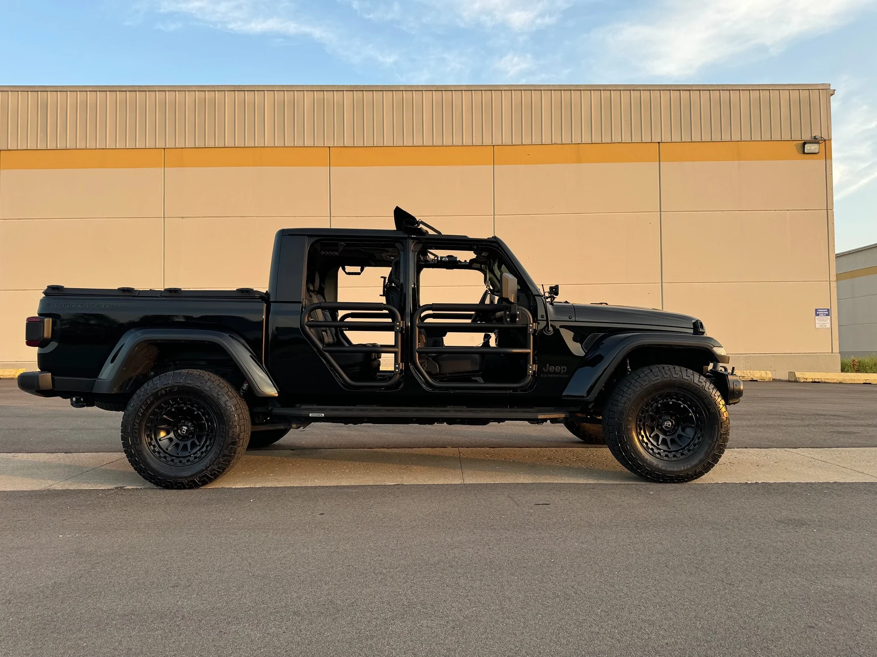

I ran the AEV 2 inch spacer lift for nearly 2 1/2 years before recently upgrading to AEV's full dual sport 2.5 suspension.
But solely speaking of the spacer lift itself I think it's an awesome kit for the money. I wouldn't say that it's absolute necessary to upgrade the shocks as well since this kit is meant to work with the stock shocks however, if you are doing the install yourself, you could do like I did and pick up some Rubicon shocks and a couple that with it.
but nonetheless I can't speak highly enough about that kit. I even purchased one for my son's Wrangler recently. Off-roading I never had issues but at the same time it's only a 2 inch lift so I knew/know my limitations.
here's a few older pics of it on mine before upgrading
Jeep Gladiator AEV Spacer lift DSC00973
Jeep Gladiator AEV Spacer lift IMG_3314

Man what a nice rig. What size tires are you running here?

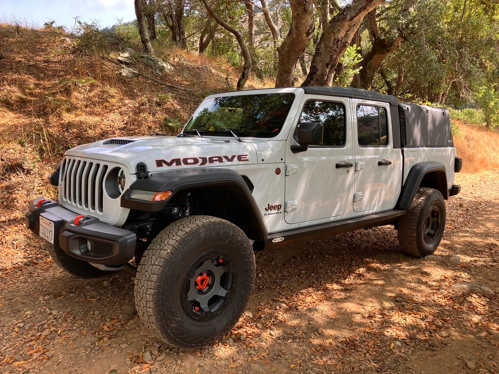

AEV 2" spacer lift on my wife's Mojave X. Love it. Make sure you purchase and install the geometry correction brackets also to correct the caster.

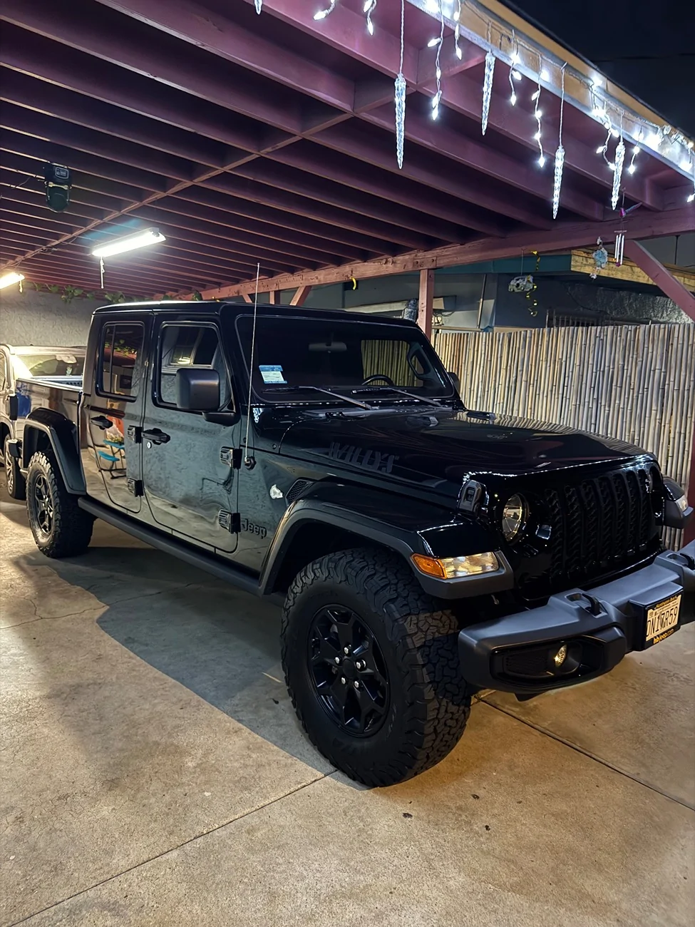

Hello, just picked up a new to me 21 Gladiator Willys. I am looking at getting some feedback on anyone running the AEV spacer lift. Would it be beneficial to upgrade to no lift shocks at the same time? Any off road input with the spacer?
I have the AEV 2" spacer lift on my 21 Mojave and I used their shock relocation brackets to retain the shocks and im running 35x12.50s. Very happy with the set up as my daily driver and light trails and camping. You didnt mention how many miles are on the Willys? Maybe time for new shocks anyways
It’s a 21 with 45k miles. It does drive pretty smooth on road, actually was kinda impressed with the drive, Ive driven a jk before as my pops has one. This definitely drives and feels a lot better. It has 285/70/17 K02s. Only had it for 2 weeks now and been loving it so far.
appreciate it. It's changed slightly since those pics from a suspension standpoint.
but the tires are Cooper Discoverer AT3 XLTs in 295/70/18 which is basically a 35 equivalent
