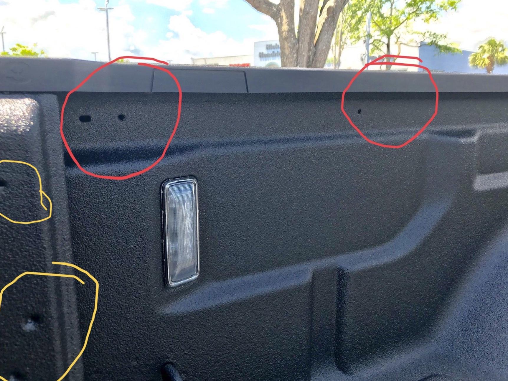

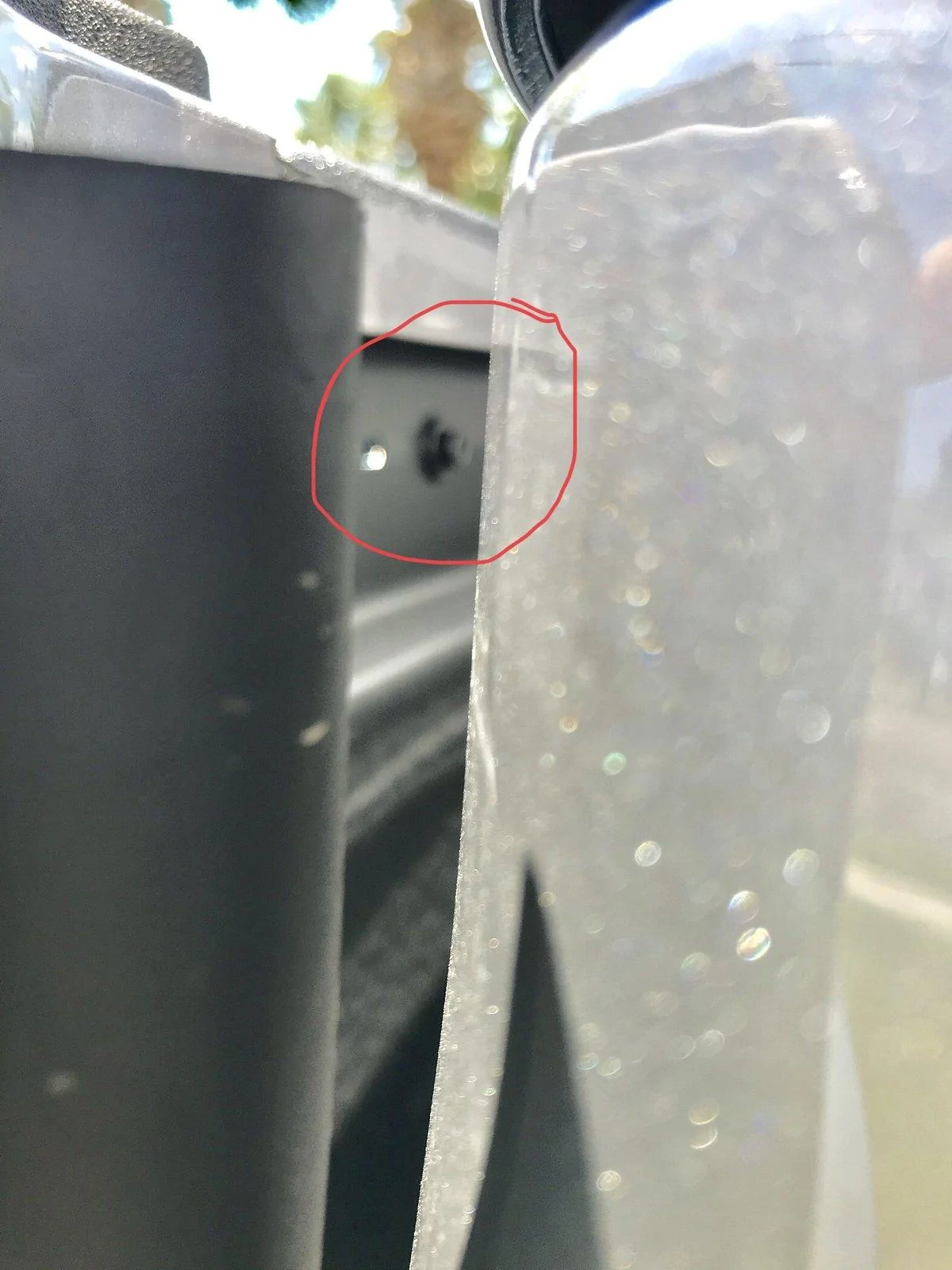

I use the L Track. I had to mark and drill countersink hole in rails to match exactly the holes on bed, and purchase eight bolt that are 6mmx1inch SS for countersink hole, since the ring stud fitting doesn't slide in the track very well I dont think countersinking the mounting bolts was necessary but that's just my thinking

How well has this stood the test of time? TIA.
Pretty well. I've hauled furniture across the state with the tailgate down, picked up lumber, and hauled two refrigerators in the upright position. Also moved (i.e., house to house belongings and furniture/appliance) for a couple people with the tailgate down.

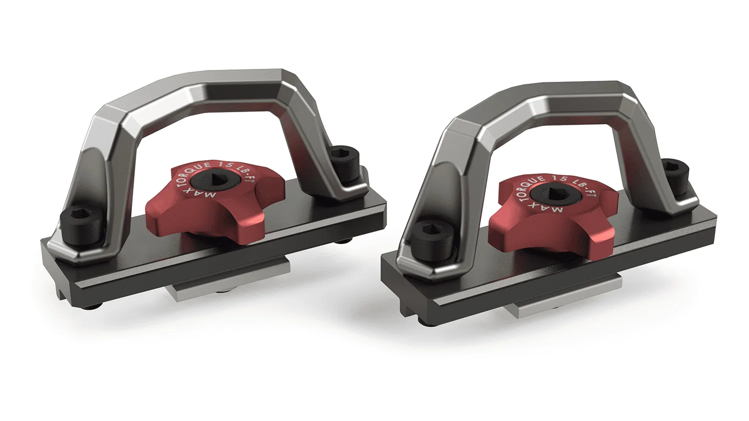

Rebel Off Road has a rail system as well. The TeraFlex bed hook kit works with too.
