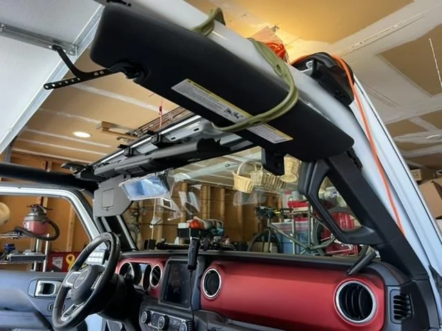

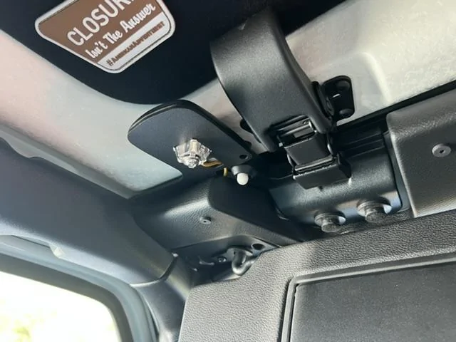

Finishing up a few more tasks while I impatiently wait for Tiny Rig Co to get an install date scheduled. It’s somewhere between NJ and CA. Anticipation is high.
So I relocated my XM antenna using the Maximus-3 Bracket. I found one video on YouTube for this and it was helpful. Took three hours start to finish, and required removing the interior roll bar trim panels and sound bar. Freedom panels need to come off, but did not need to remove the back part of the top. So this could be done if you already have the camper installed.
I also took the opportunity to install the mirror piece from the Brandmotion FullVue camera system. This is my second time installing one of these, put one in a JK a few years back. The instructions are still terrible.
One question for those who have installed the FullVue kit. Where did you connect to power? Did you follow Brandmotion’s instructions and tap behind the media controls or did you go for sources in the passenger footwell if you have the factory AUX switch option? Considering that route.

How bad is the reception with the camper? (Before relocation)
Either on this thread or the other AluCab Roll Call thread, some have reported issues with the camper covering the XM antenna. I do know that roof racks cause interference so I went ahead and preemptively addressed this. The bracket moves the antenna to the drivers side, by the windshield.

@LAJEEPR i might try that. I let the radio service lapse after having the camper installed due to reception issues. Usually it is not an issue because I can run Pandora or Amazon music, it is only when driving at Windrock and a few other places where I lose reception.
I can answear this firsthand now… Pretty bad. It receives sometimes, but mostly not. And when it is receiving, it drops out under every single freeway overpass. I don’t recall it ever doing that before the ACCC went on
