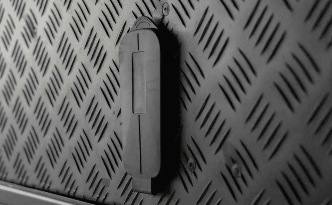

Alu-Friends! Man do I hate the locks/handles that came with our Toppers..... One of them I cant even get the key in to lock anymore.
Anybody found any solutions to lube the lock, make the spring more powerful so it opens when cold? 4 out of 6 of mine don't like to open when its cold, and all 6 suffer from moisture freezing in them, so when the weather hovers anywhere near 32 during the day I know I may experience issues.
Its come to the point I don't even latch my rear 2, the gate stays closed (on mine anyway). The rear two froze one day rendering my truck bed unaccessible.... =(
Hope ya'll are doing well. I've got some more updates to do on my truck, hoping to share later this spring/summer. :sun::jk::turkey:
I'll have to agree on this. I haven't run my Gladiator thru a Maine winter as I've put it up the last two winters. But just thru late fall, early spring I have had issues withe the canopy latches freezing up. I'm sure they work great in Australia but not in freezing weather with precip.
Being a black top it warms up pretty quick in the sun and thaws. I carry a can of deicer spray in the cab. A few blasts frees things up in short order.
I wonder if a rubber flap glued to the cap covering the latch would help any?
It doesn't take much moisture to freeze up the latch though so I dunno.
I like the flush mounting of the latches but it freezes up way to easy.

I'm up in Michigan and am totally with you guys. Pretty much the first bit of winter precipitation and it wasn't working. Ended up picking up the Alu-Cab Latch Covers because I needed something. They're pricey for what they are and honestly a bit of a pain to actually get to seat completely after use, but they do their job and freezing/rusting hasn't been a problem since. Might take them back off now that it's warming up.
While installing them though I noticed something; if you tighten down the single nut on the inside of the latch assembly too much, the spring won't have enough force to pull the latches out after you press the button. Loosened them up again and it's much better now.
Either way if they came up with a v2 of this push button latch, they'd definitely have my attention!

Yeah I liked the flush mount of the stock setup too. This bulbous solution is going to anger me for months every time I look at it.
Kinda ugly, but probably would fix my weather issues. https://ok4wd.com/brands/alucab/canopies/alu-cab-push-button-lock-cover-each-alua-pb-cov
