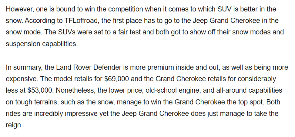

Depends on the Land Rover. I've owned 4 of them, and they all kinda sucked on-road in the snow. But, in their defense, they were 1963, 1969, 1971, and 1974. :)
That's fair, I should have specified lol
I miss my '13 LR4 quite a bit, thing was an unstoppable tank
250
40,605
54,300
There's an article from a year or two ago where a Grand Cherokee was pitted against Land Rover.
Jeep won.
