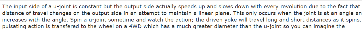

You have speed differences all the time, so there's always a certain amount of binding unless any wheel is on snow or ice, then it can slip and take the tension off.
What can't be relieved is the u-joint severe velocity changes.
So you have a combo in some conditions, but let one wheel slip and all of the drivetrain binding goes away. What's left is that joint turning at one speed and the wheel starting, stopping, starting, stopping, because of the joint action. it's literally a start/stop situation.

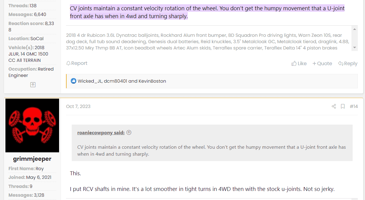

A lot of truck and some Jeep people have done the conversions and noticed the difference - smoother turns in 4H.

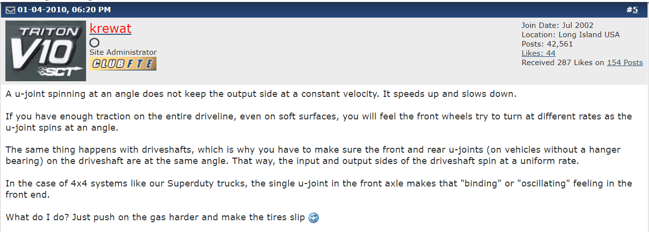

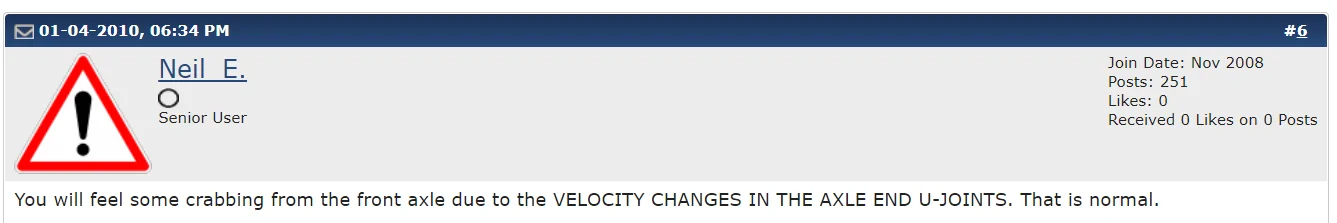

Here's another example showing it's force on those front joints and the associated RPM cycling - for every rotation, the tire tries to speed up to roughly double axle speed, and slow down to roughly half axle speed.

The problem is - no one understood the "u-joint effect" so it has for years been explained other ways

But the Jeep guy who said he switched to CV joints up front and the jerking motion disappeared, that pretty much lines up with what the science says.
