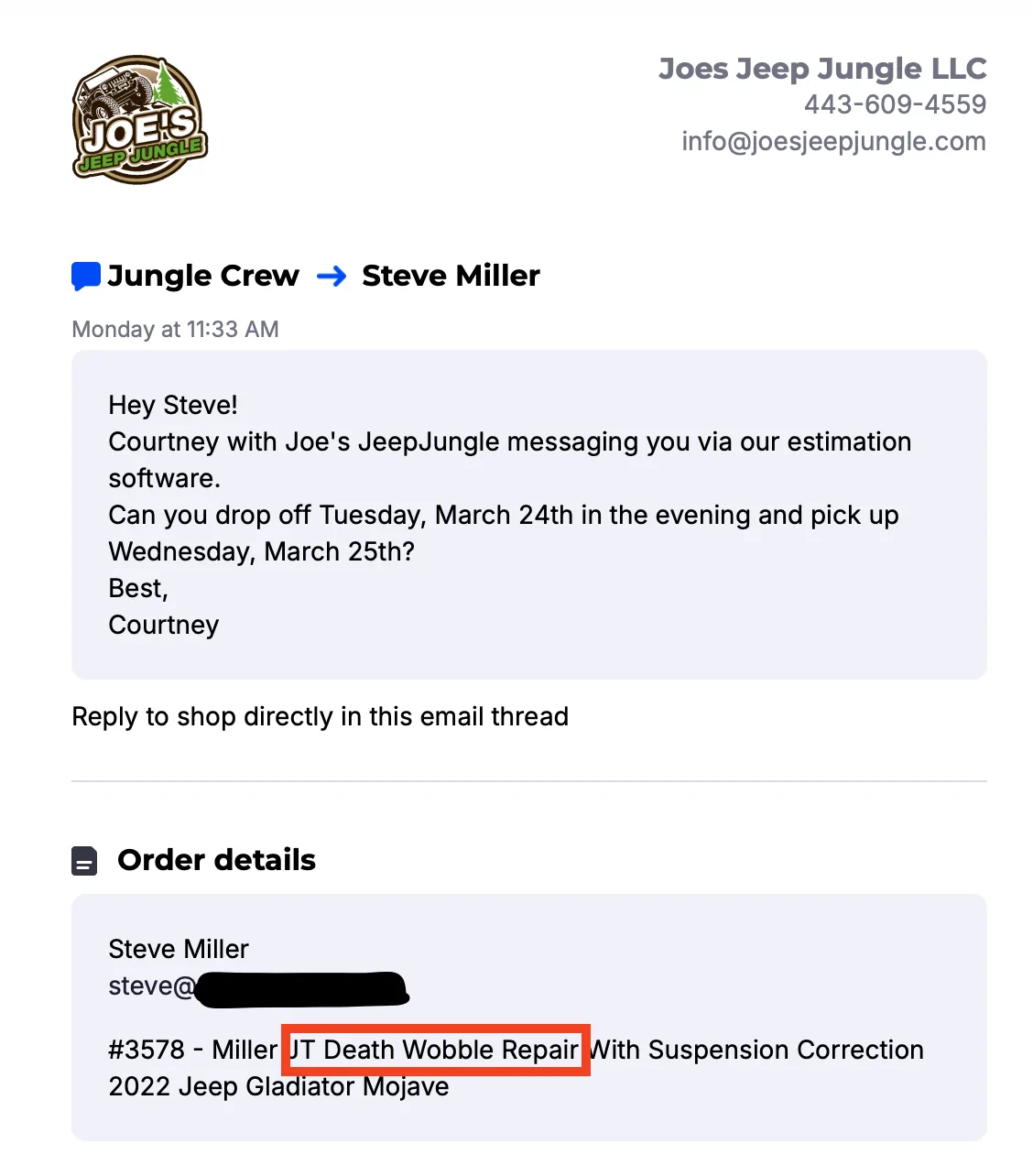

I'd think since the warranty is still valid you should get that into the shop before you install the stabilizer. Dealers (not just Jeep) love to play the modified and not covered game.
That said, typically an inch or so of back and forth on the tiller to keep it headed in the right direction isn't out of the ordinary. Mine was more of that and headed towards Death Wobble so I'm taking care of that before it tap-dances across the highway. Note the repair itemized below. 😂
(Joe's is an AMW dealer and the best Jeep specialist in the region)

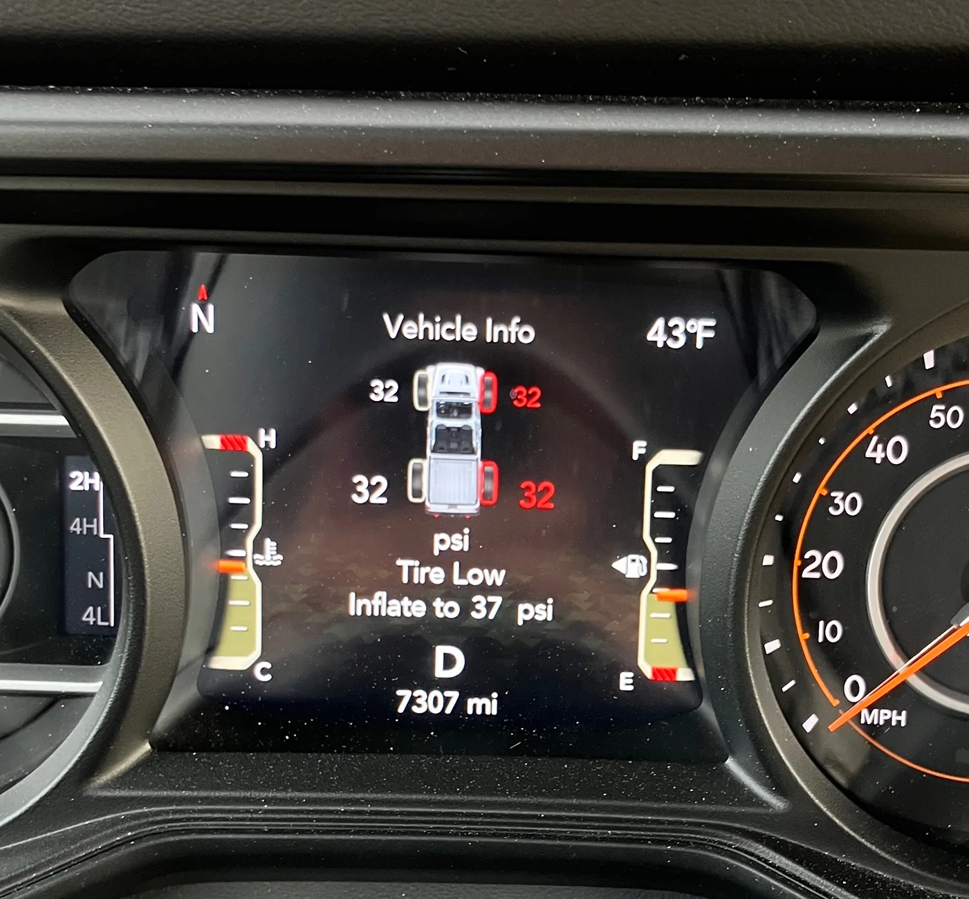

I installed the Bilstein steering stabilizer. The short report is it seems to have no noticeable impact on drive-ability on pavement. Maybe if the front end had a lot of miles on it, and/or wear/tear, maybe it would have, but not on this ’25 JT Rubicon with 7,000 miles.
It is a stout gas charge in that thing, but it didn’t seem to push the steering left (or right) as far as I could tell.
It was 85 degrees yesterday when I adjusted my tire pressures down further than I already had, to around 33lbs “cold”. It was 42 degrees this morning so they were all at 29lbs and I got the TPMS warning. Interestingly it only lit up the tires on the right side of the info screen. Maybe that’s normal? They were at the same pressure as the tires on the left.
I ignored it all knowing the day will warm them up, as will rolling friction in the 30 mile round trip I needed to make to the dump, and I wanted to see how the TPMS warning would behave.
I got up to 32lbs all around just driving and the warning remained. I’ll keep an eye on it today to see at what pressures the warning turns off.
