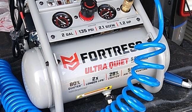

Got a large inverter, and might "rearrange" this compressor to fit inside the JT. It is absurdly quiet, and should fit my needs quite nicely.

Those aren't compression fittings, are they?
I watched a soft copper line explode in a shop once........I heard a sound and looked just in time to see it rip open........
and have seen the compression fittings blow out.
Under 100psi probably ok.
Ya they are compression fittings - never had one blow as you have.
Still I will plan on replacing with the same type as is coming off the pump
