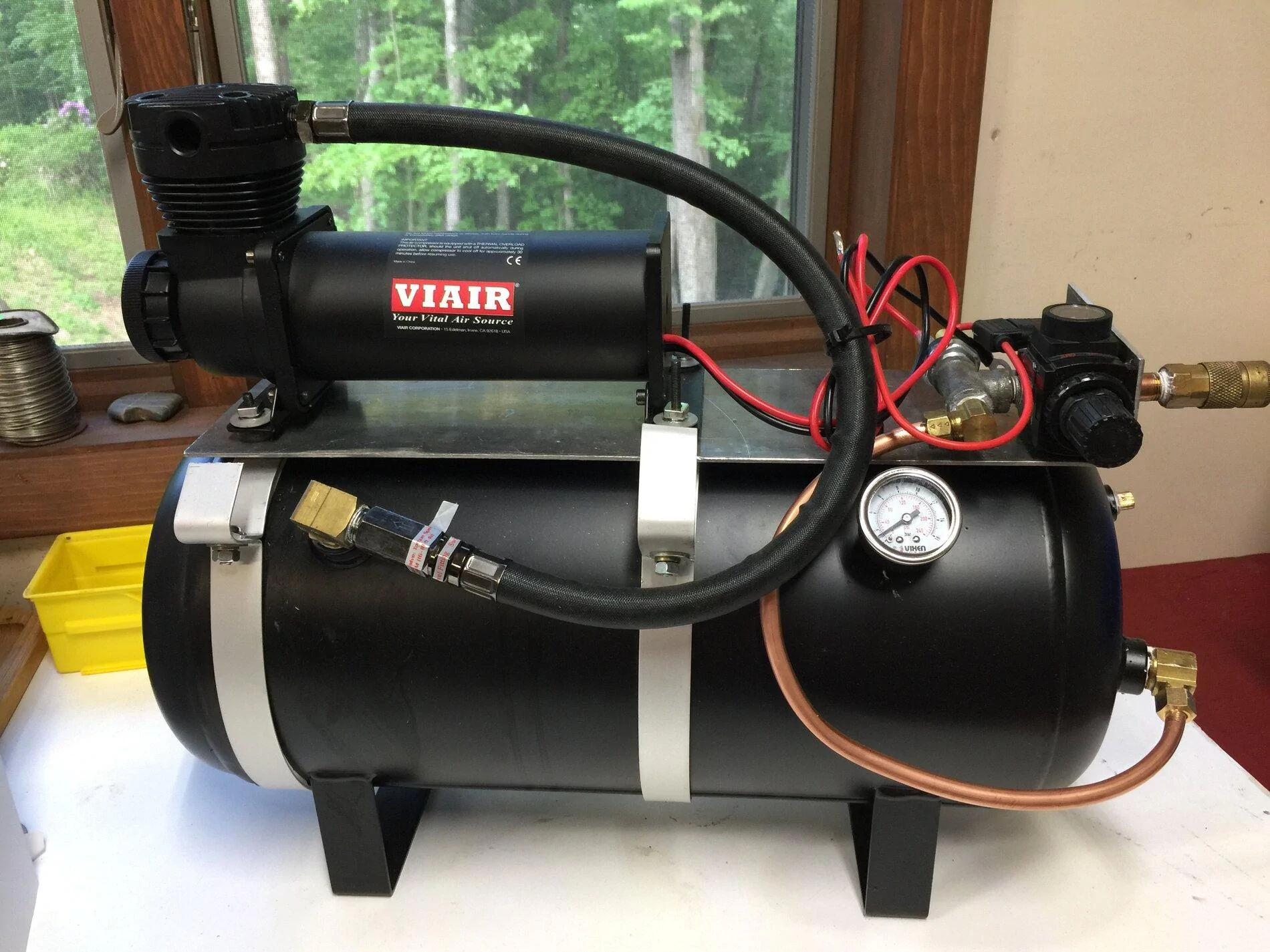

I mounted a VIAIR 48042 200psi compressor on a Vixen horns 5gal tank. Cost me about $350 in parts but works fantastic. Compressor is 12v/22Amp and needs a direct battery connection. Has a 100% duty cycle at 100psi/72°F. Not quite finished and a bit of an overkill for my needs but is not heavy. Fits on the floor behind the seat.
Jeep Gladiator Anybody carry a compressor in their JT? IMG_014429
40,465
53,924
Those aren't compression fittings, are they?
I watched a soft copper line explode in a shop once........I heard a sound and looked just in time to see it rip open........
and have seen the compression fittings blow out.
Under 100psi probably ok.
