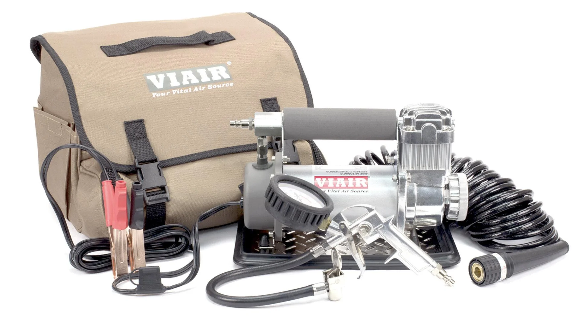

I carry a Viair 400P-RV which also serves as a backup to air up my RV tires. Fits in the storage area under the back seat.
