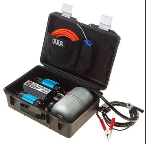

The single cylinder ARB is 30% more and not portable, at least at the pricing I could find. Throw in the cost of a mounting plate and the price diverges even more, let alone duplicating for another Jeep. The Smittybilt compressor airs up all four tires at once just fine, never gets to thermal overload even for two Jeeps worth of air. You pays your money, you takes your chances.

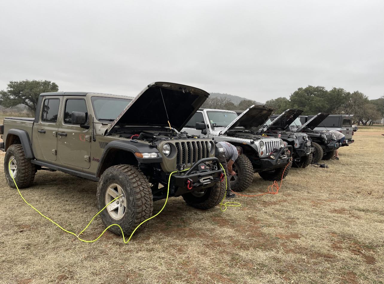

Agreed. I aired up 4 Jeeps without overheating, from 25psi to 35psi on 35-37" tires. Thing is a great value, under $200 on sale I believe when I got it.
I’ve seen it used in the field a lot. It’s a decent value but nothing is better than ARB. It’s simply worth it. Nickel and diming over it isn’t worth it IMO. I have both a single and dual (2 Jeeps) and they’re exposed to the elements under the hood and have never missed a beat in the years I’ve had them there, and to hear is bad. I air up 4 tires at a time and then often 4 more+ for friends.
Portable stuff is nice and all but it gets old loading crap up and it’s also a risk if you don’t strap them down.

I have a little compressor like the smitty in my 4runner. Worked well for years, still running strong. Takes some time to air up all four 33" tires.
Now with Jeep on 37s, I installed the ARB twin with a 4 hose connection system to air up all 4 tires at once. This thing is quick! I'm more likely to air down with the Jeep than the 4runner since it's just so much quicker.
ARB twin is as good as it gets for this type of compressors. It does cost a lot more than my old portable.
