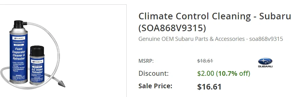

I've never used it, but I was looking for kits to use on my 2017 CX-5 and I found this Subaru kit. I have no idea why it is so reasonably priced:
