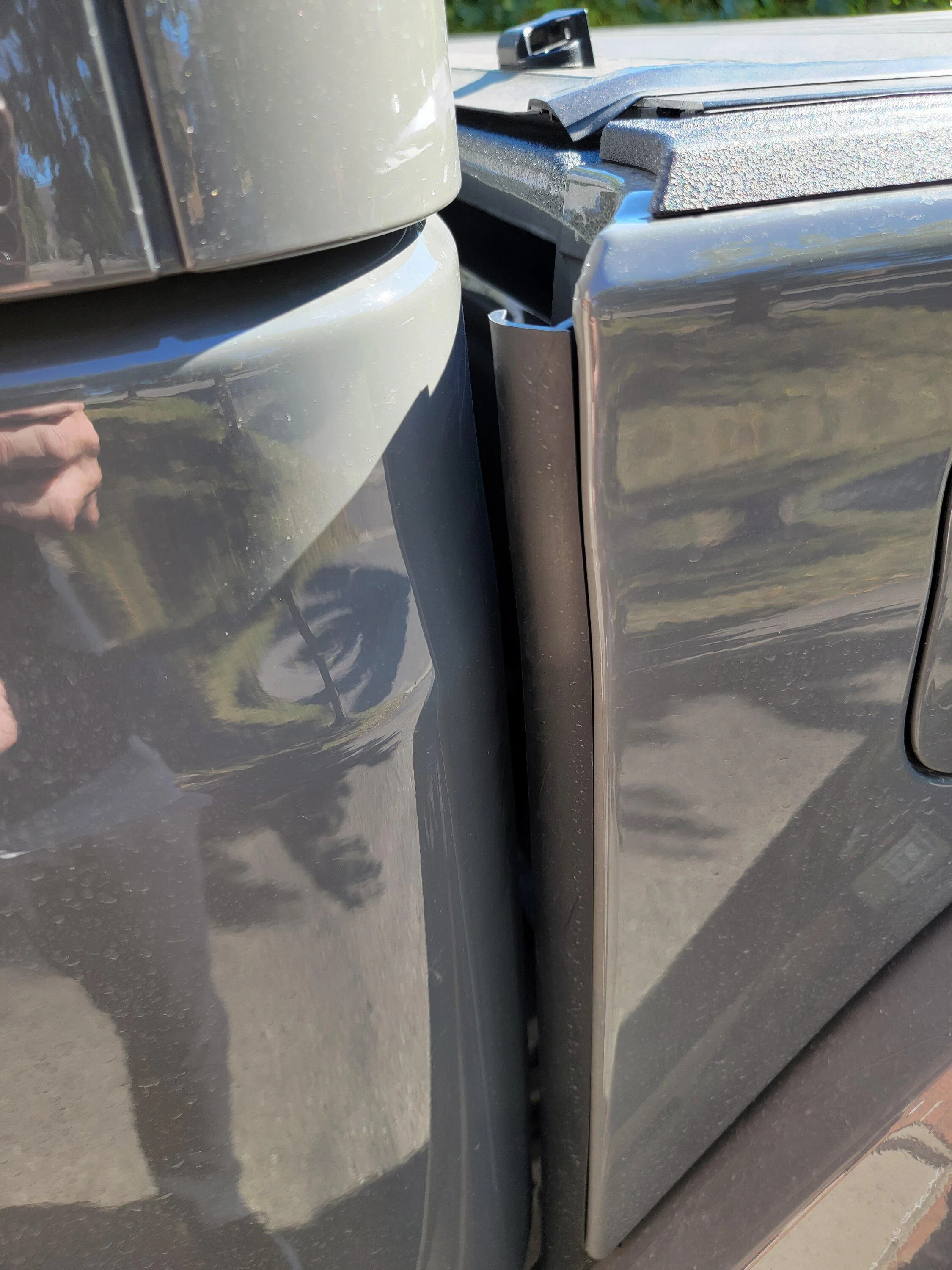

On mine, the bed is 'shifted' slightly relative to the cab. I was going to loosen all the bed hardware and shift the bed to correct it. But, I decided to take some measurements relative to the frame rails first. I found that the entire cab & front end assembly is slightly shifted to one side and the bed is centered. IMO, way too much trouble to try to shift the cab.

That is how I noticed mine. The rubber gab on my driver's side is much larger than my passenger side. I can stick my finger between the rubber and cab on my driver side and there is no gap on the passenger side. I will take a picture of both sides tomorrow to compare, but this is my drivers side.
Driver side is where my gap is, too.
Mine doesn’t seem that off left to right though

I had this issue. I noticed a squeak and found it to be the rubber rubbing the cab. Took it back to dealership and after a little back and forth they sent me to body shop. They aligned it betted that factory.

Thank you for your response, that will be my next strategy to get it resolved. Do you know if the bed is attached on the bottom or the top?

If I were me, I'd measure the frame in relation to both the cab and the bed before adjusting anything. Only then would I make any alignment, unless of course you are a masochist... if that be the case, have fun!

If youre worried about it there appear to be 3 15mm bolts in each framerail. Loosen them up a couple turns and square the bed up to the tub and bumper. Then remeasure and see if the tub is still square with the frame :rock:
