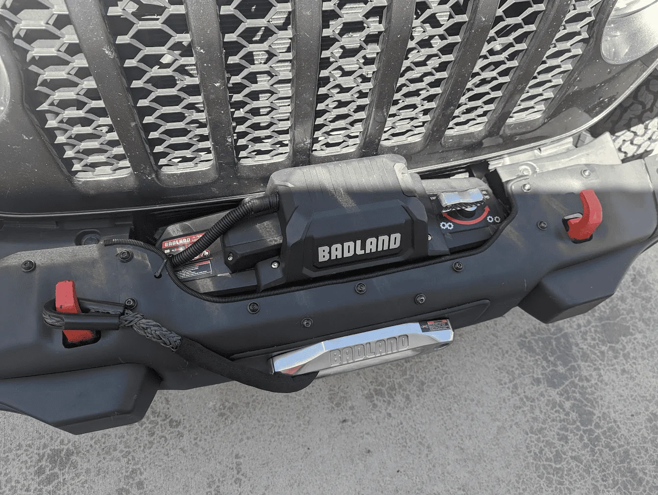

How did you get the control box to fit on top. I just put on the arcus and was trying to install the winch but the cables out of the back were hitting the grill so it wouldn't fit.
Granted I am installing on a wrangler .. figure it's the same
The badlands is the same. I removed the cables from the rear, redrilled on the side and ran them out the passengers side.
I'm not the smartest guy... Have any pictures of your process?
I have it set up for return but if I can make it work I'll keep it. Was looking at a smittybilt x20 gen 2 10k since the wires look smaller but worried I'll have the same problem.
Really just upset I have to take it all off again to install

I don't have the pics when it was apart but here is one I found. The bandland only has the B+ and ground for wireless coming out the back. I think if you do some searching here on the site you;ll find better pictures from a couple other guys. Thats how I got the idea. I think if you search @ShadowsPapa he had some better pictures for his install.

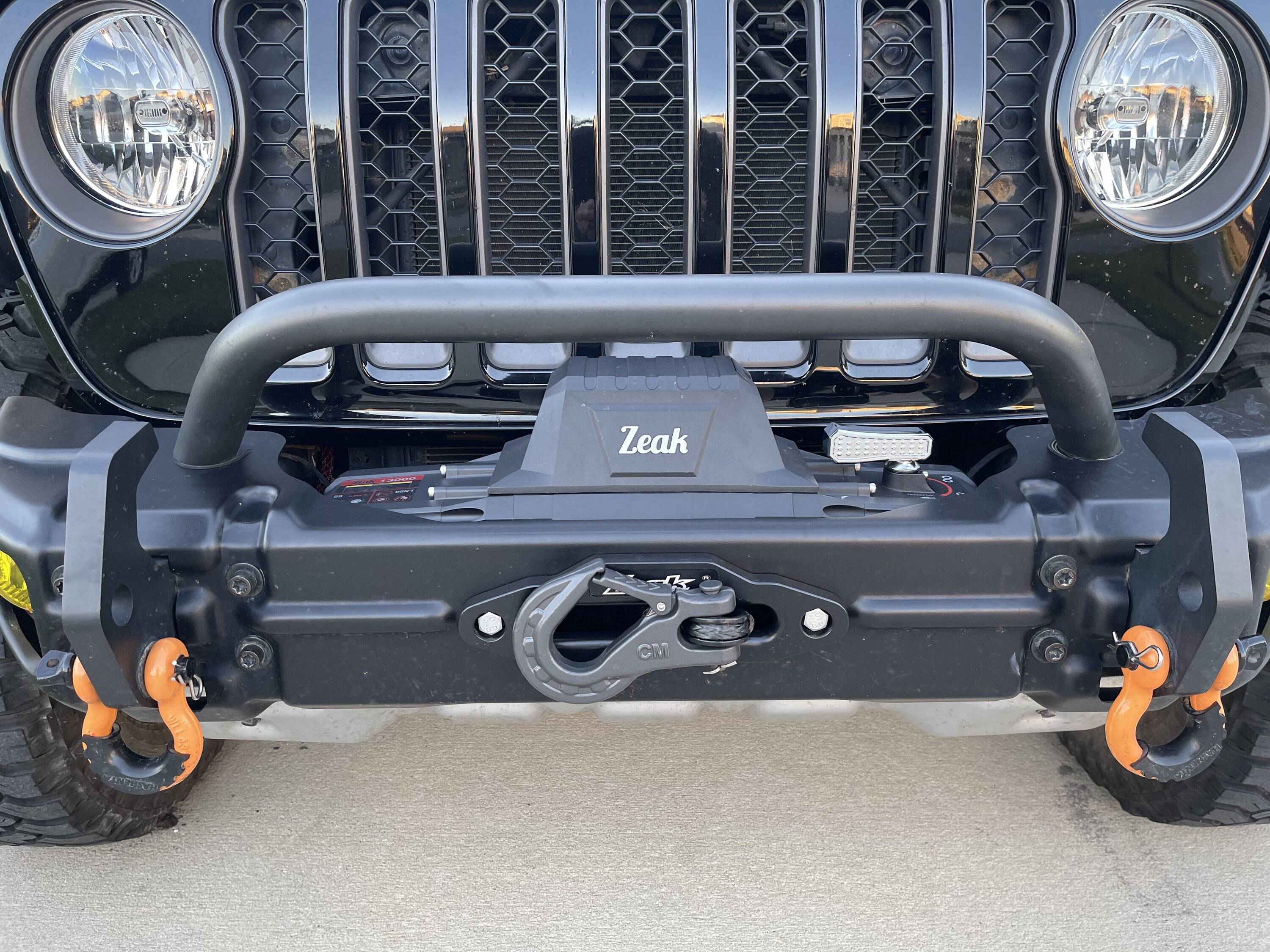

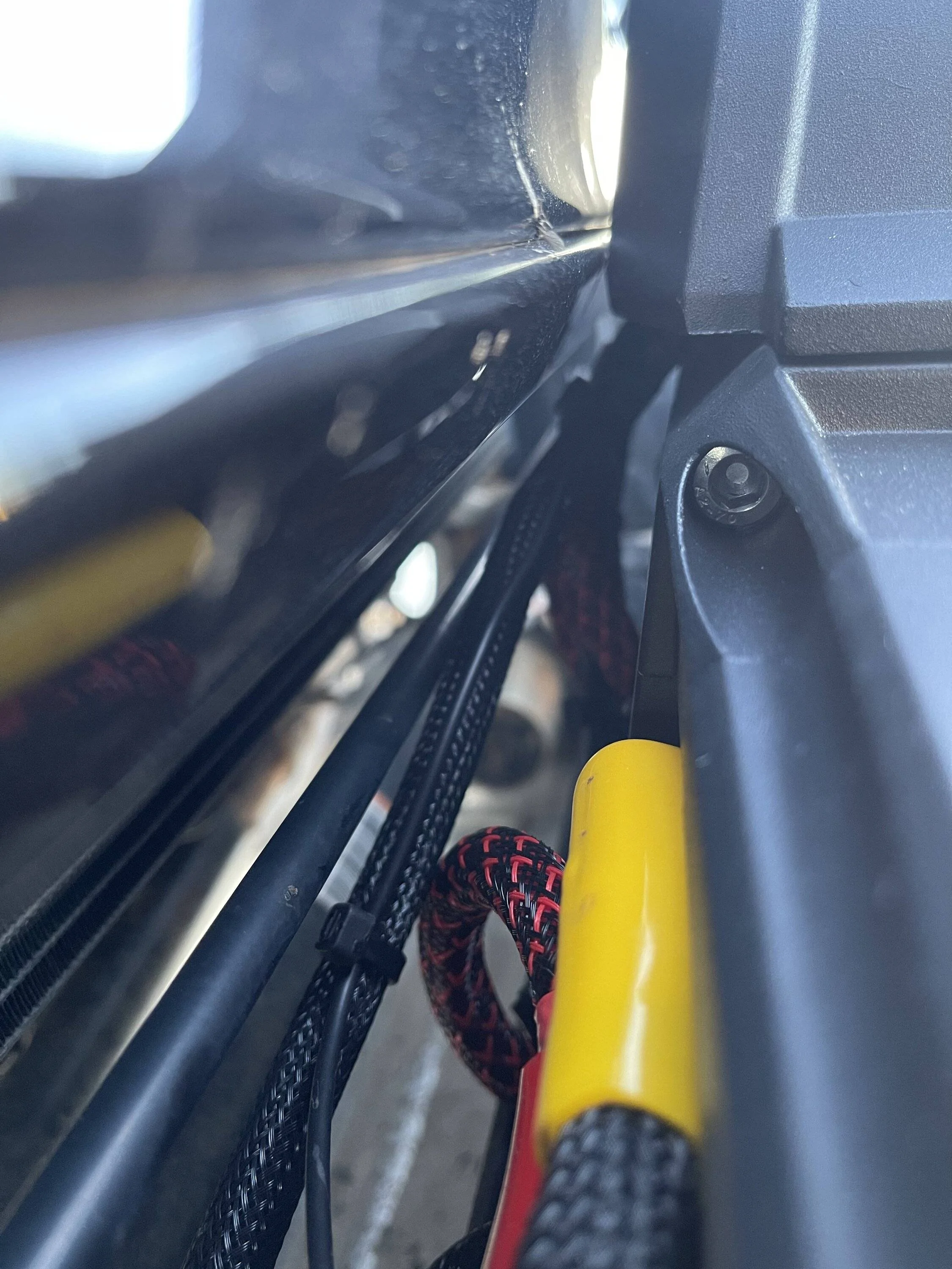

The model of Zeak I installed has the wires coming out at an angle at the bottom of the control box. This allowed me to not have to relocate any of the wiring. It’s kinda hard to get a good photo of it installed. The wires have a less than an inch of clearance and although the box cover looks like it’s touching the grille in the photo it has a small air gap.
Jeep Gladiator Anyone guinea pig these winches from Amazon? A31F74C9-D6C9-46BD-8917-BA0DBFD9E309
