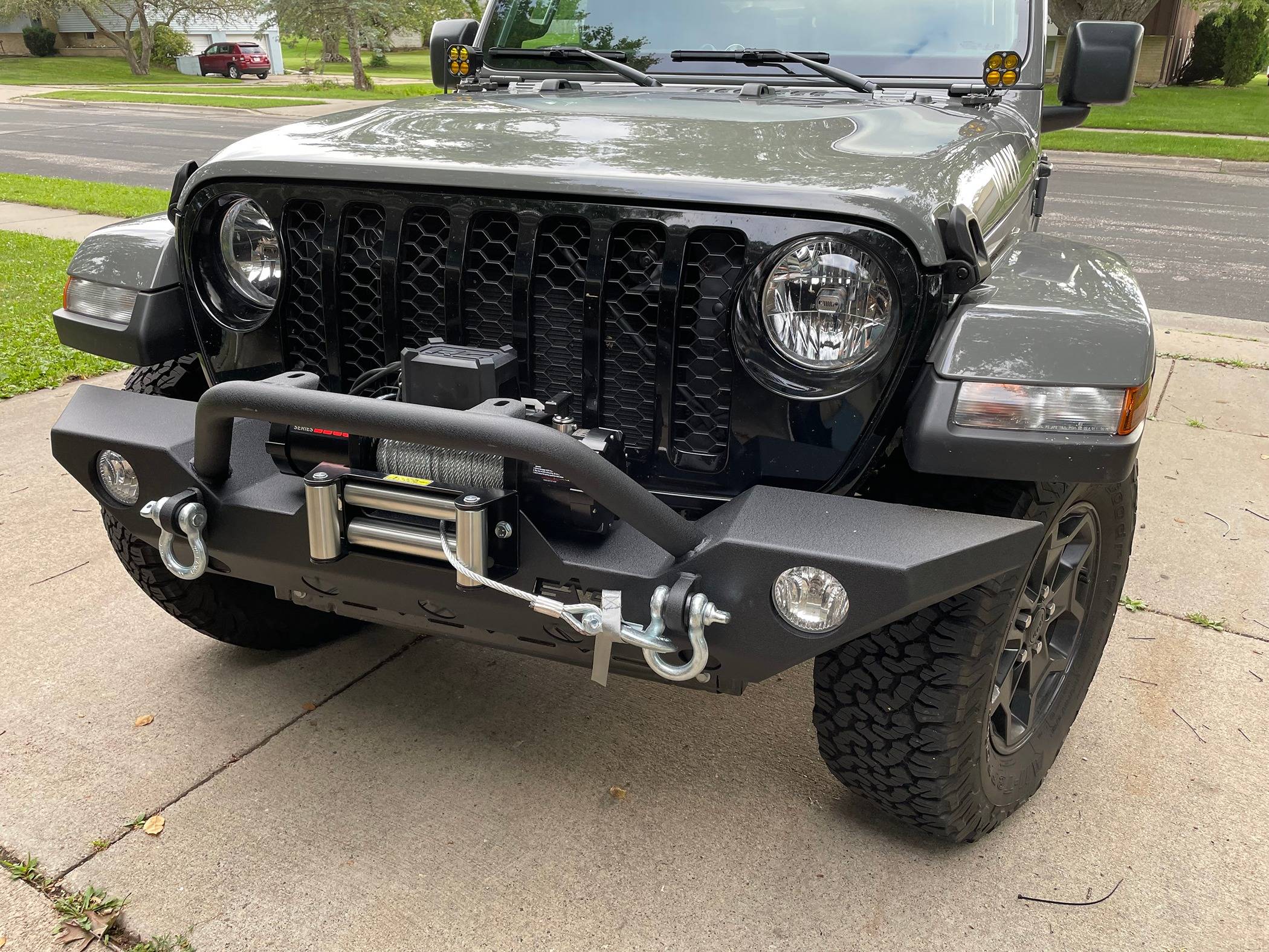

I have a lower priced rough country 9500 lb winch. It came with steel cable but I replaced it with synthetic rope. I have used it on and off for 3 years, sometimes in serious situations and it has worked flawless. I do like the synthetic better. I don't like handling the steel and it is heavy and can be dangerous. I don't think you will be disappointed with any number of the winches out there... (The picture is when I just purchased it and still has the steel cable.)
Did you have to make any changes/adjustments to put synthetic on a winch set up for steel cable line? Did you take the tensioner off and roller fairlead off? I am looking at doing the same thing.
whiteglad
Joe
Feb 12, 2020
1,305
1,215
Vegas
2022 Gladiator Mojave
I went from steel to synthetic rope on the HF 12k winch. I got a HF hawse fairlead, removed the tensioner. Most winches have a threaded hole on the side of the drum for the typical rope ending metal piece. Mine didn't so I cut off the end, put on a piece of heat shrink tubing, and inserted the end into the hole for the steel cable terminus. I also went from the set screw to a longer button head with the end pointed to retain the end of the rope better.
