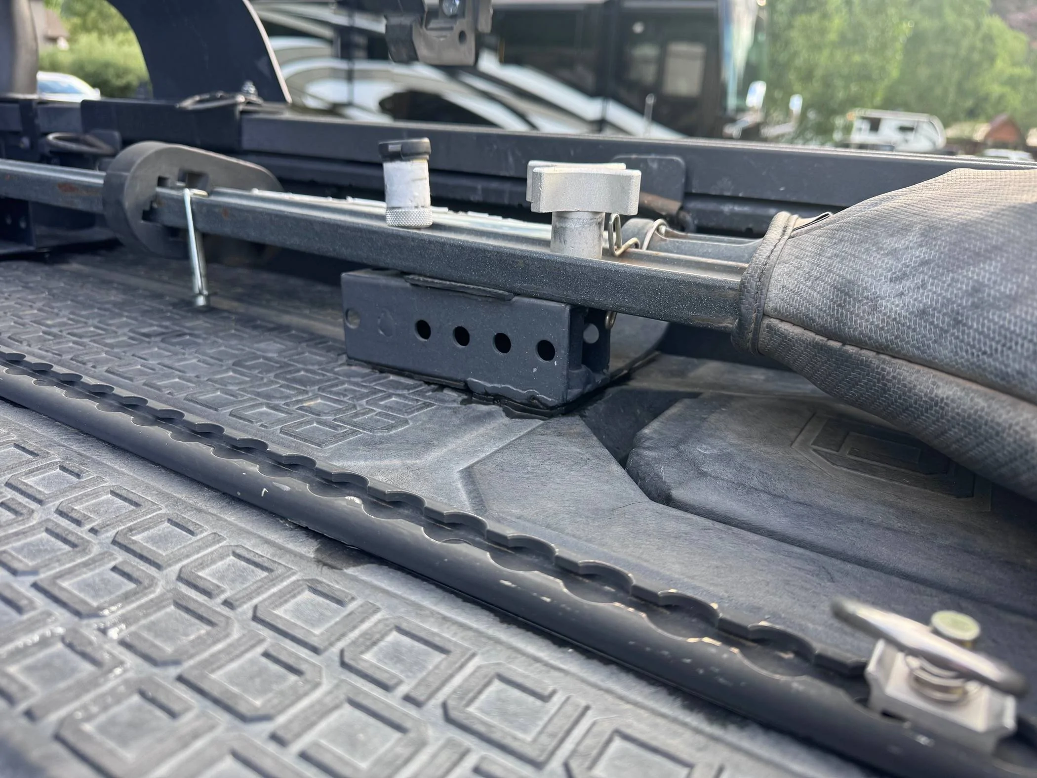

I dropped a swing case and it shattered. Buy the knock off or just get a bin. As for the softopper, it has bars that drop below the bedrail, so you have to cut out a chunk of the deck on both sides. If you want to go this route, the other 3 options for soft tops on the bed do not need this to be done.

Never done it, don't have either. There's a few people that have done it. Easiest way is to have the Softopper in place, measure where the bars go low, and then trace that onto the Decked to cut.

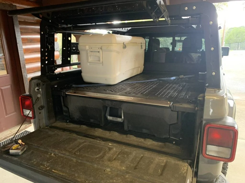

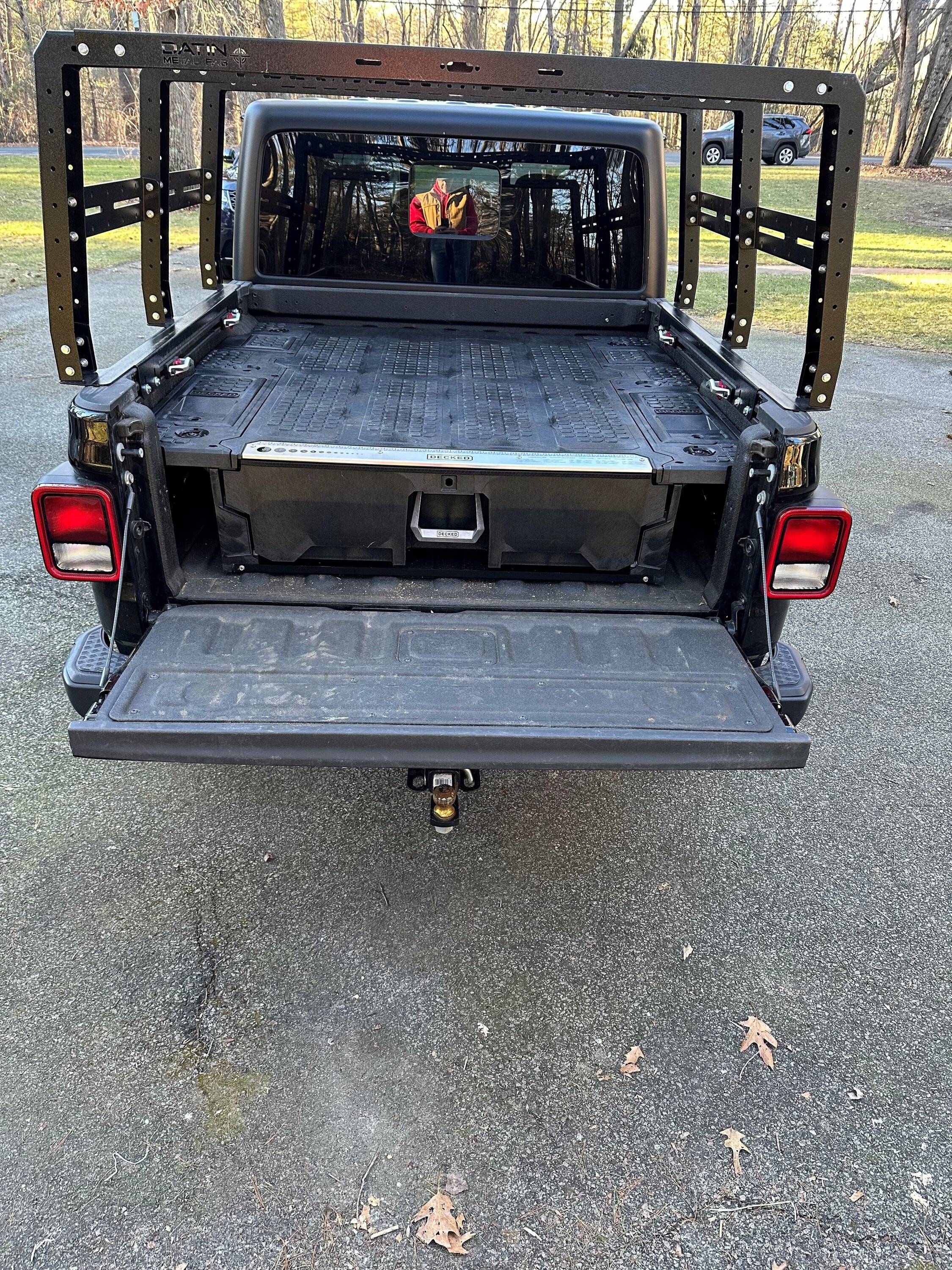

I have the ZroadZ full sized rack on my bed and the Decked system (single drawer). I was concerned with the space above the deck and below the top of the rack as well as the space to fit my coolers though the hinge point. My second cooler is slightly shorter, so I know it will fit great. Now the tough part will be either filling the coolers once in place, or lifting (hopefully full coolers) onto the deck. Great problems to have at elk camp. I have since added a lift and 37" tires making my problem even better. From the hinge point of the Zroadz to the top of the deck, I measured around 20 1/2". The one thing I want to add is either make my own or purchase the Zroadz front piece to prevent gear from sliding forward into my rear window. Making my own would entail picking up a plasma cutter and I really like the sound of that!
On the Decked system. I couldn't be happier. I gained a lot of storage space and still have two rear corners for putting stuff. The front corners will hold some small things but the wheel well takes up most of the front corner space.

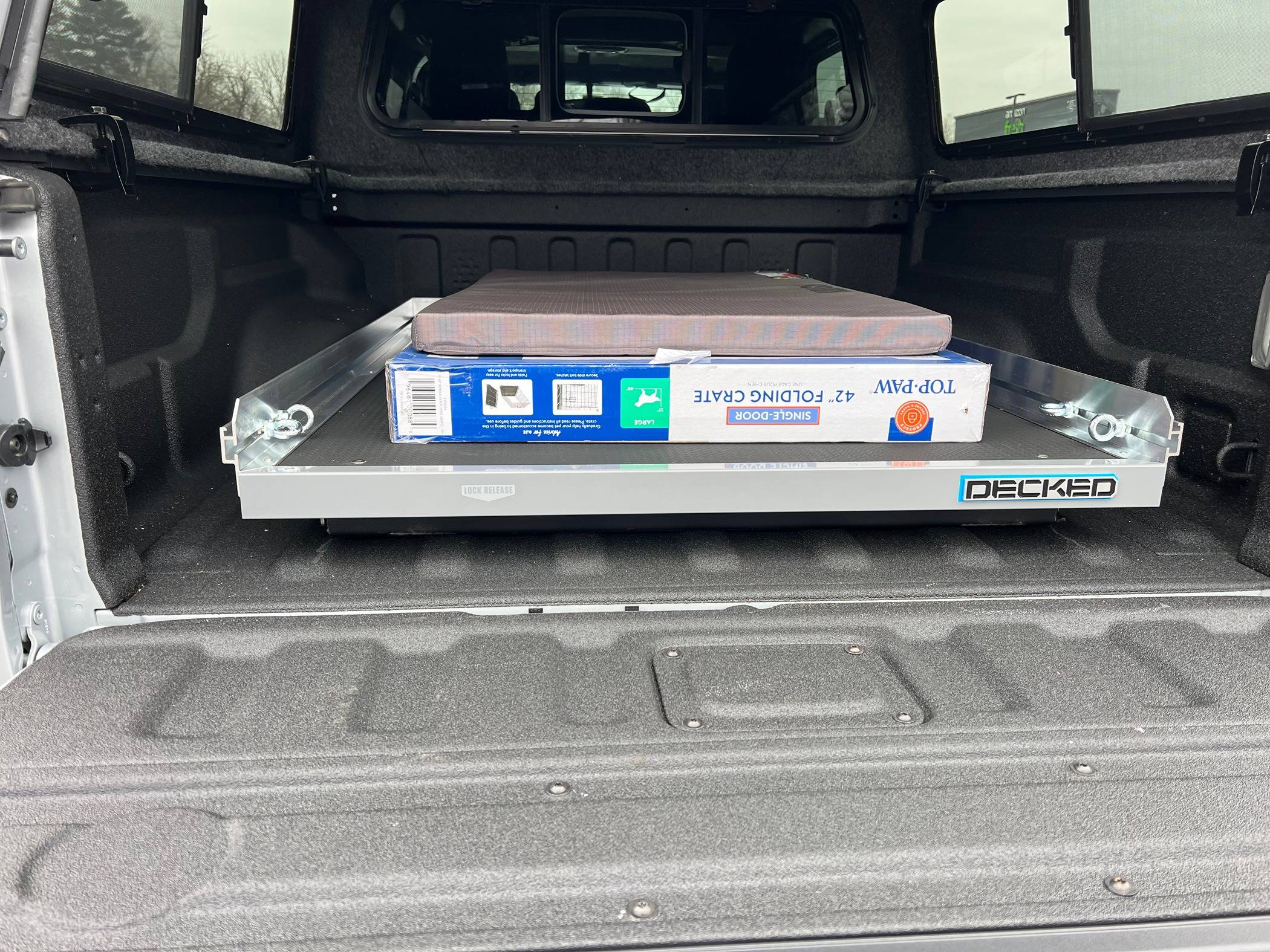

I considered, and then rejected, the DECKED Drawer system.
I went with the DECKED CargoGlide slide out, which I am very happy with, and would highly recommend.
It allows me to change things around, at any time, without problem.
Might be something others might find better, and more useful, as I have.

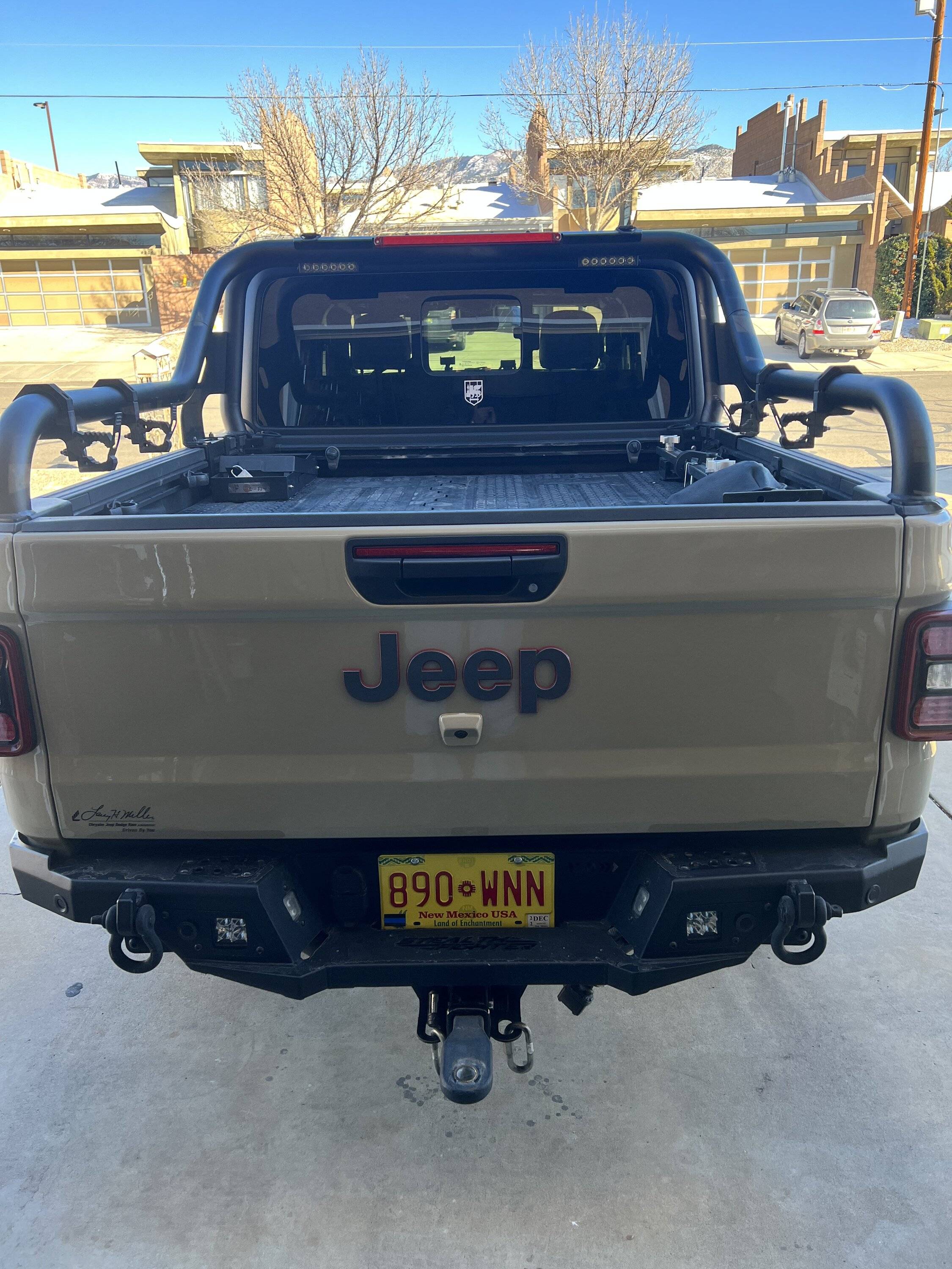

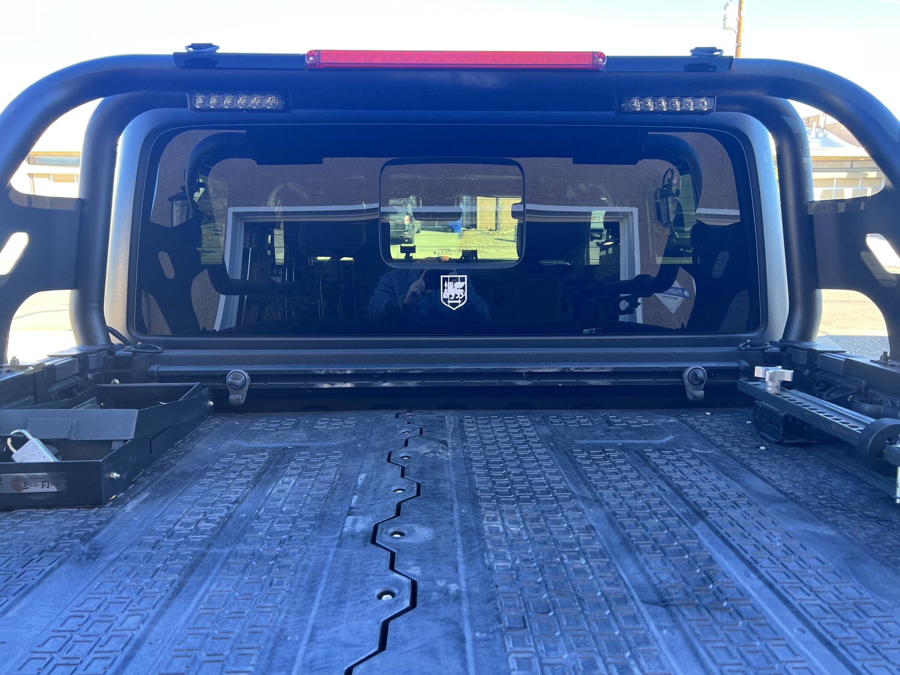

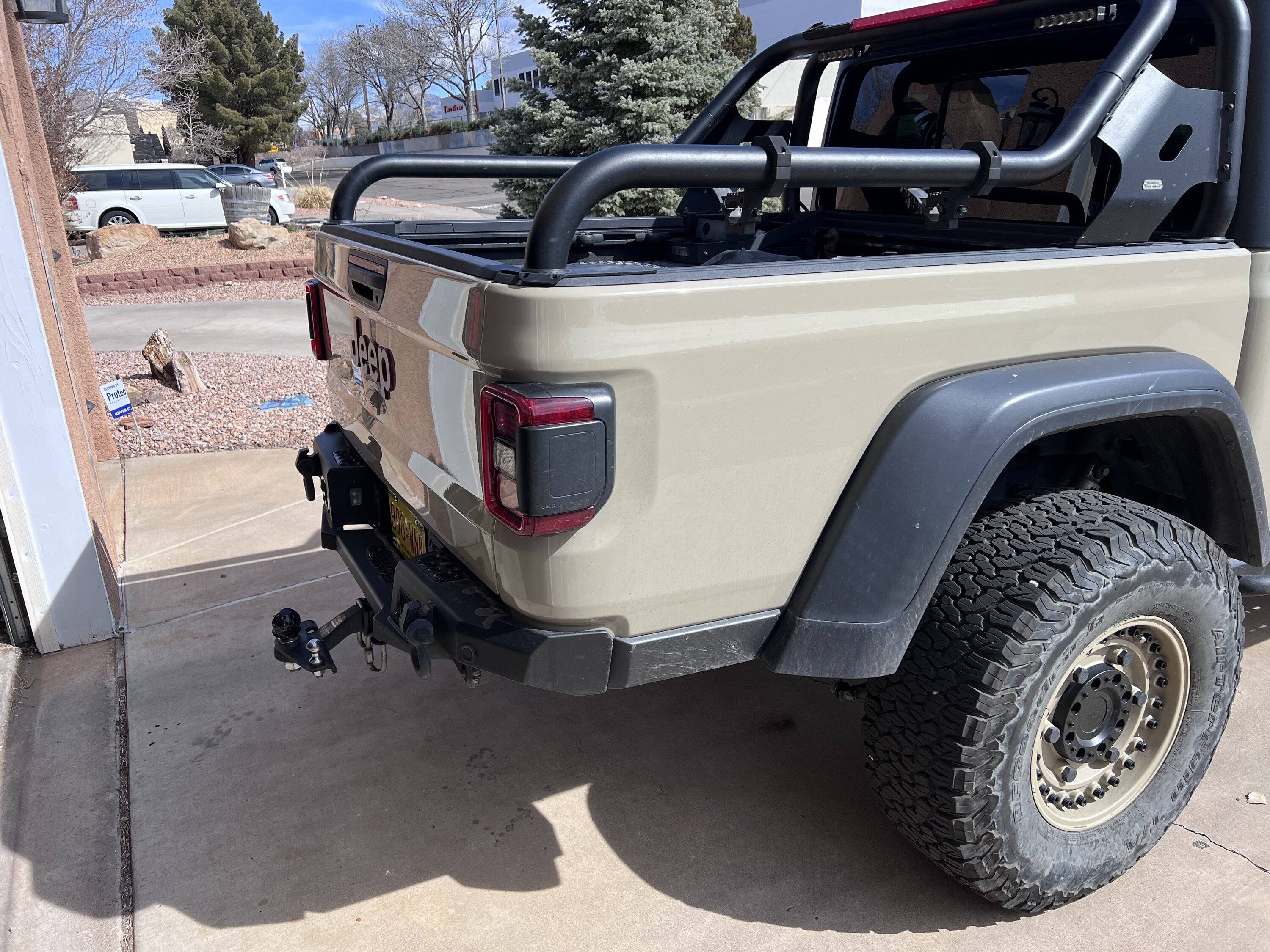

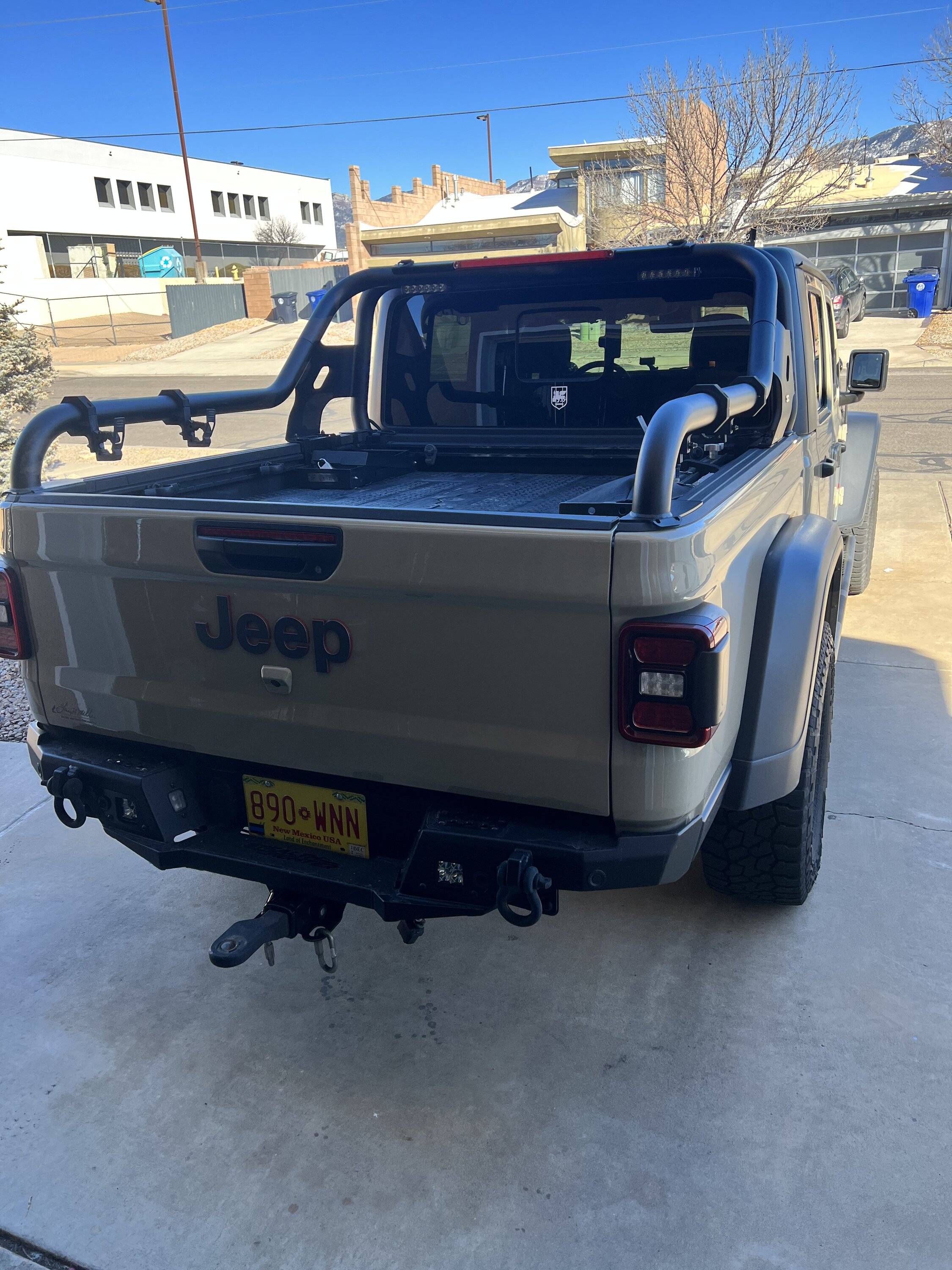

John, I bought the original two drawer Decked and had the same concerns as you regarding carry large items. I installed the Maximus 3 Sport bar for the side rails. As you can see they give me alot of sidewall height and tie down options. I plan to sell my Decked and get the new single Drawer system. I like all the new features and extra storage space.
Mark
Mark,
Sweet rig!! Do you happen to have a link for the hilift jack mount on top of the Decked system? Thank you!

I built those out of scrap metal. I used 2” perforated tubing and welded a bent piece of flat stock that bolts into my trail rail. It’s not mounted to the Decked. The knobs are from roll bar mounting brackets and the lock from a Blue Ox towbar lock that I welded onto the 2” square tube.

It’s not pretty but it does the job

installed, time to organize the drawer and modify to accept the softopper
I have a softopper and considering the Decked system. Did you end up modifying the Decked by cutting a hole in it? I was looking at the Softopper linkage and clamps that hang down and after loosening the screws I was able to raise the bars high enough. I am thinking it may make more sense to move the two clamps (one at the bottom v and the one in the middle towards the back) slide the bars up, screw in the clamps in the new spot then cut the end of the bar that is contacting the Decked. Doing this lowers the front bow a little bit and raises the middle one a bit. Dont think it would look off from the outside.
Just a thought! I will certainly share if I decide to go down that path.
