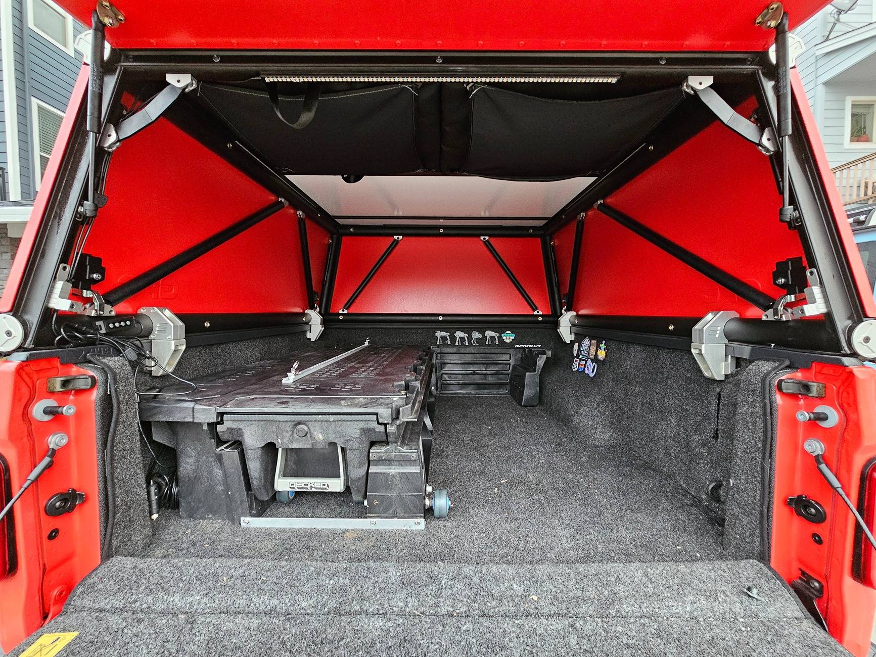

I need to get around to removing the drawer wheel on the passenger side but here ya go.

I did have to get a piece of aluminum angle bar and cut it to run the one side, cost maybe $5 and 5 minutes with a handsaw.

Looks like you have to run the full width rear piece?

It needs some sort of rear bracing, it could be removed but some sort of permanant fixture would need to be there to keep it from only being anchored on the driver side bedside. It wouldnt move laterally but could bounce and stress the bedside mounts without it. You could possibly cut it and then drill into the bed bulkhead but that's a little invasive to recoup maybe 1 cu ft.
Im currently considering buying some plywood and cutting it into a "L" shape to run the top of the drawer and over the top of the rear support. It would act like a small table top and provide a small cubby under the passenger side.

Yeah I think I'll go pick the one local to me up after seeing this. The one I have drawn up is only one side, and after slides and everything it's probably going to cost just as much, but with the Decked I can run one or two drawers.

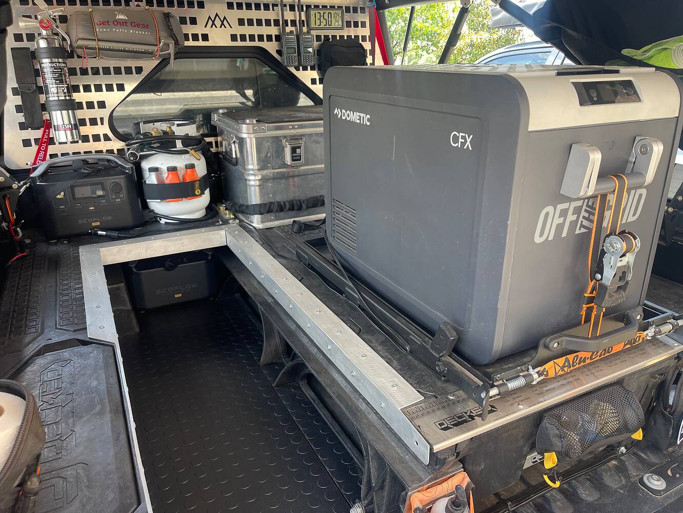

I've seen a few people do this, where they cut the top panel on the narrower side to make a space for standing. I have an extra top panel and eventually think I may do this as well.
