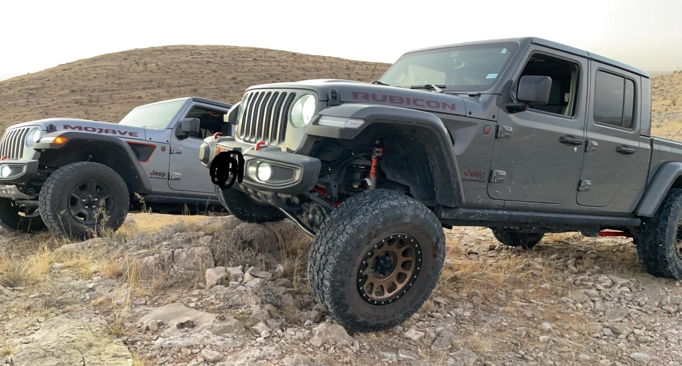

Update on the 3.0s. The suspension is getting dialed at the Because Stock Sucks shop in Oakhurst, Ca. Using almost all the shock travel on all 4 corners with about 3-1/2" bumpstop. Front 3.0s are 10.72" travel, rears are 9.42". Metalcloak rear adjustable control arms and trackbar, WFO front long arm kit with Metalcloak joints on the front. The front long arm really helps to keep the lower bumpstops lined up with the Mojave factory hydraulic bumps. It's sitting on EVO 4.5" coils. The Metalcloak rear 3.5" coils sagged way too much with the added weight. Should be driving it next week.
