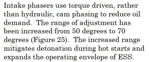

I found where FCA was thinking the same thing I was - lower compression pressures (effective compression lowered) to reduce hot start issues like detonation in a hot start, and make it easier for ESS - Looks like they agree with my logic/experience -
Jeep Gladiator Anyone with over 100k miles on their 3.6 yet ? 1657422509715
Dropping compression during a start helps reduce startup detonation and makes ESS restarts easier (less stress on engine and starter - sort of a compression release like some small engines used years ago)

One engineer designed Gen 1?
The current 3.6 is very different and was heavily modified in ways that end up making it better for ESS.
The oil pump will cause less strain during ESS starts because it's dual-stage, the timing chains are lighter and smoother, so there's less inertia to overcome, the VVL will lesson the stresses of starting as the compression will be lower during warm starts, there's a lot about this version will aid warm starts.
In their testing - Did they actually keep cycling the current version of the 3.6 (2016 and later) using the ESS system, or was it a series of cold starts - or non-ESS starts? The PCM handles ESS starts differently than when you crank it to start it.
Oil is going to be one of the biggest factors. It's the oil's film strength that handles the stresses of starting and ESS starts are not cold starts. They are very very different because the PCM knows exactly where each piston has stopped- it modifies injector signals and ignition for fast low stress starts. Listen closely to an ESS start vs a cold start.
The oil film is only minutes old and if a good oil is used, it will handle it. There will be no metal-to-metal contact, no real chance for wear because the oil film will keep the parts apart.
Hybrids as well as others have used similar systems for years and that's why the industry here was pretty well ready.
The new bearing designs have been working for others for a lot of miles, and years - others have logged a lot of miles, and the instances of bearing failures on the 3.6 is really pretty small, isn't it?
