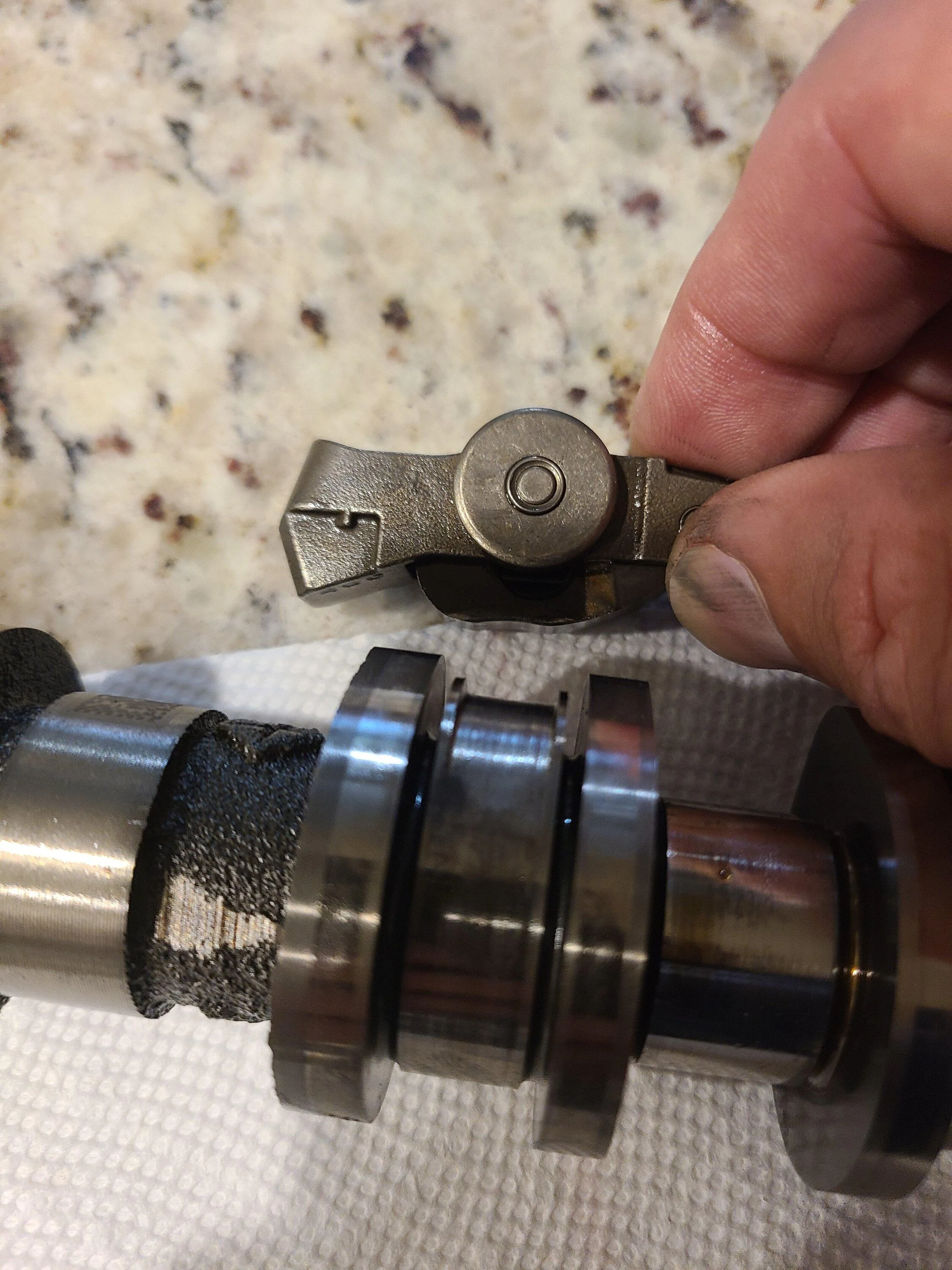

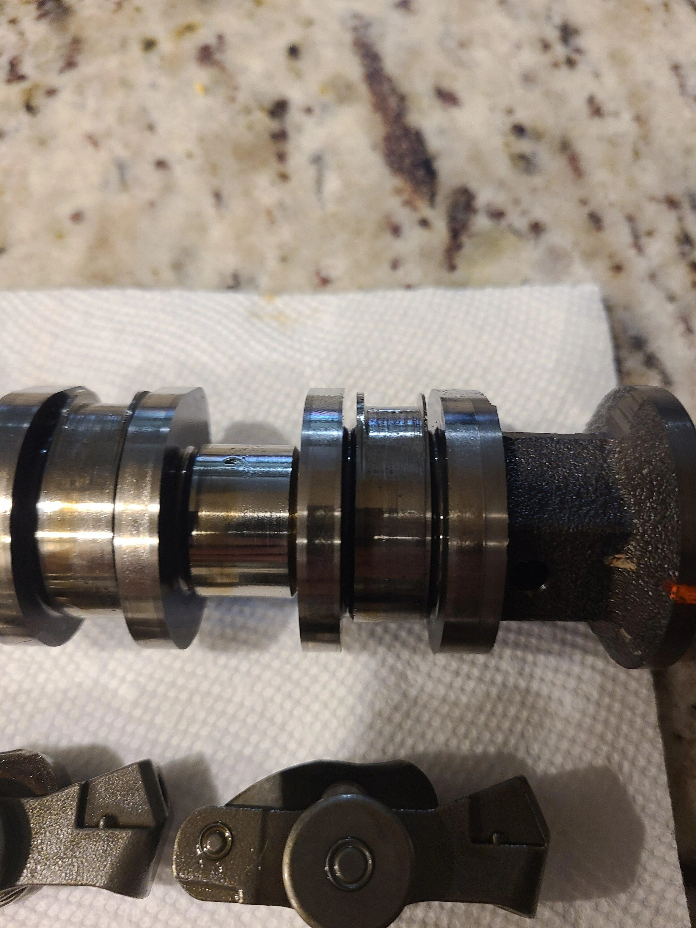

Three bad followers and 3 worn cam lobes, passenger side intake.
OUCH - did they tell you what the cause of this was ? Did they provide you with lifters as well ?
No one knows for sure why it happens. Bad design, poor oiling, bad heat treat.????
Crappy design.
Its been an issue since 2014. They started with replacing heads and stuff now we are onto cams and lifters.

I think its more of a manufacturing/assembly fault rather than a design fault - many VVL engines use this kind of a design and don't have any issues. Then again there are many who have gone well past 100k miles at this point with these same engines (without issues) i remmember meeting a guy that has a ram 1500 with this engine with a ridiculous amount of miles - he was buying a JT and specifically wanted to stick with the pentastar.
That is ALOT of metal to have shaved off - did you at-least change the oil after this job ? Did you see where they were caught ? That would worry me more than anything after a job like this.
Yes, that is a lot!!. I had to drive it about 1000 miles while ticking. I did an oil change at 500 miles and they changed the oil after the job was done. I'll do another in 500 miles just to be cautious.
