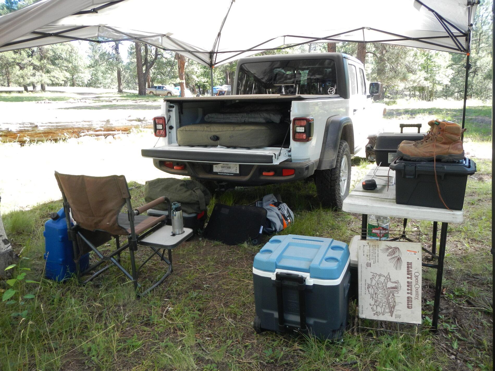

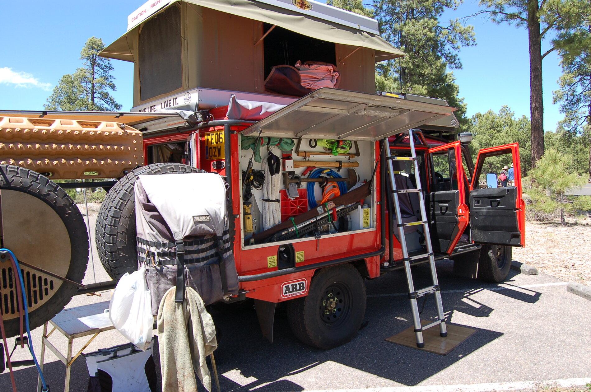

I like the idea of the Overland trek...crossing austrailia or africa in the in the decked out land rover...
Saw this impressive unit at Overland Expo.
But, until i find myself on another continent, I like a more subtle, minimalist approach. Not only from a cost standpoint, but weight, fuel, offroad and on road manners. And having the kids grown and on their own helps in all those columns as well.
