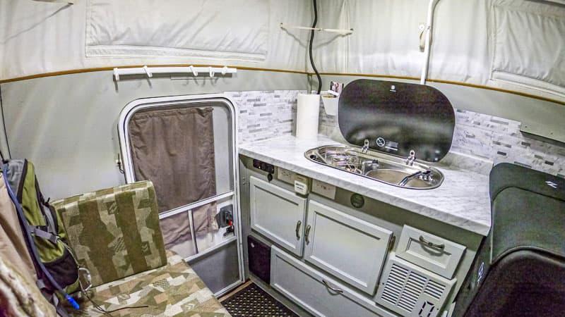

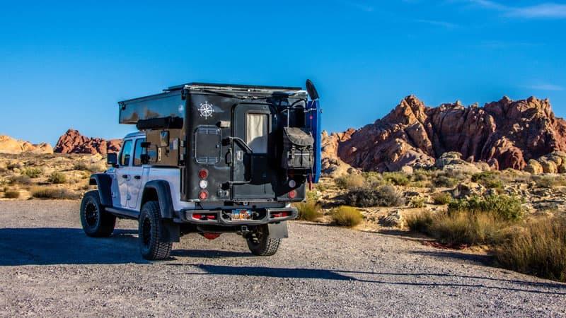

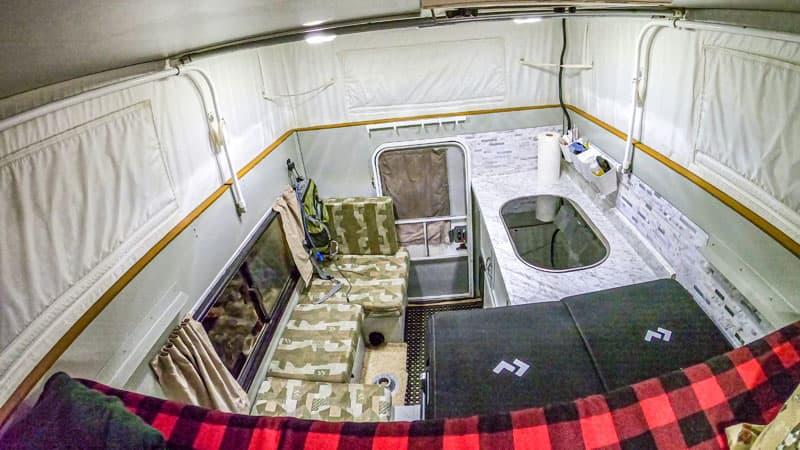

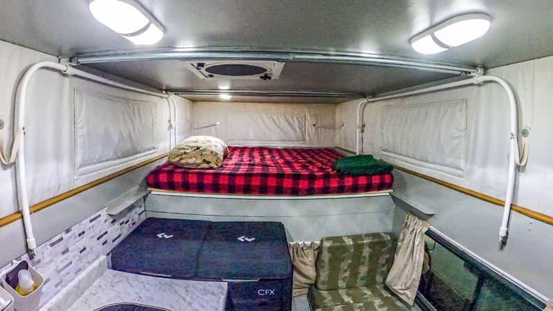

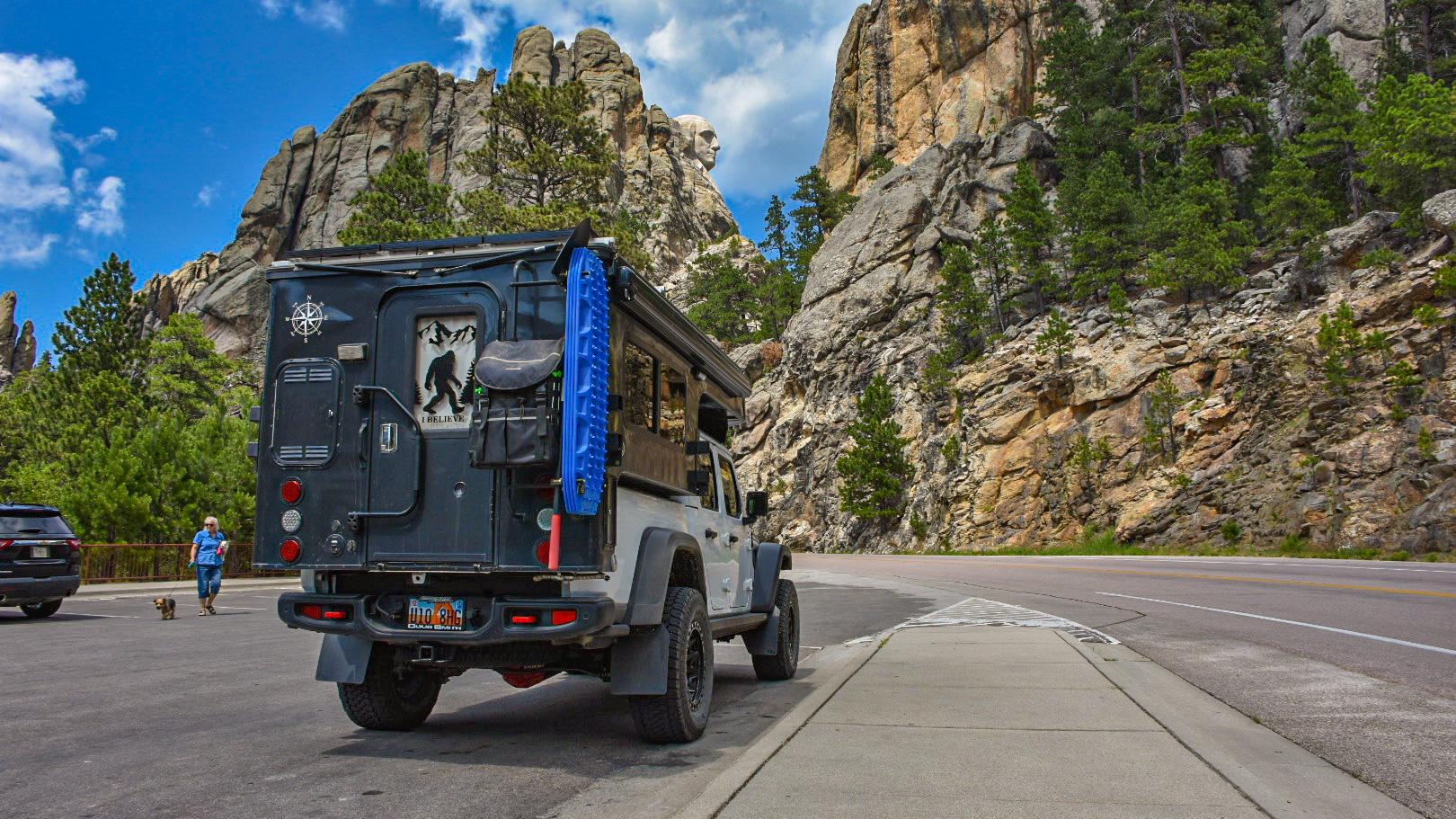

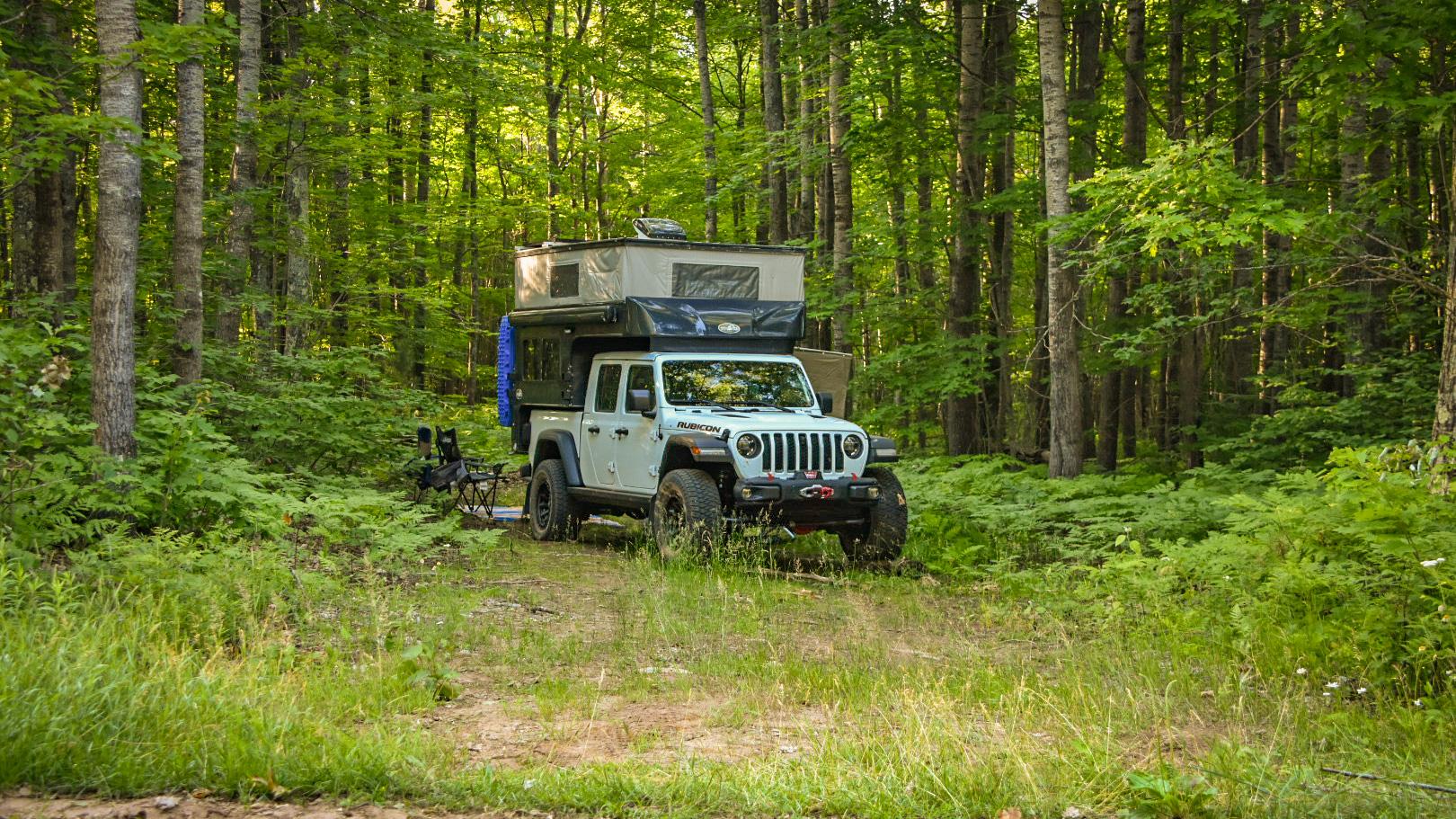

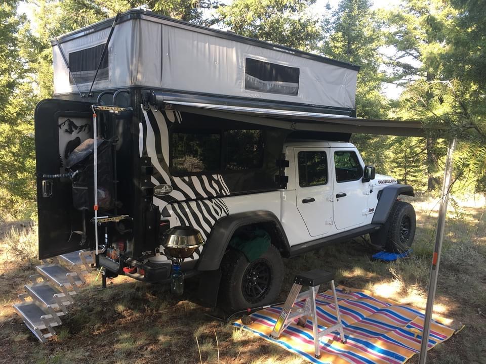

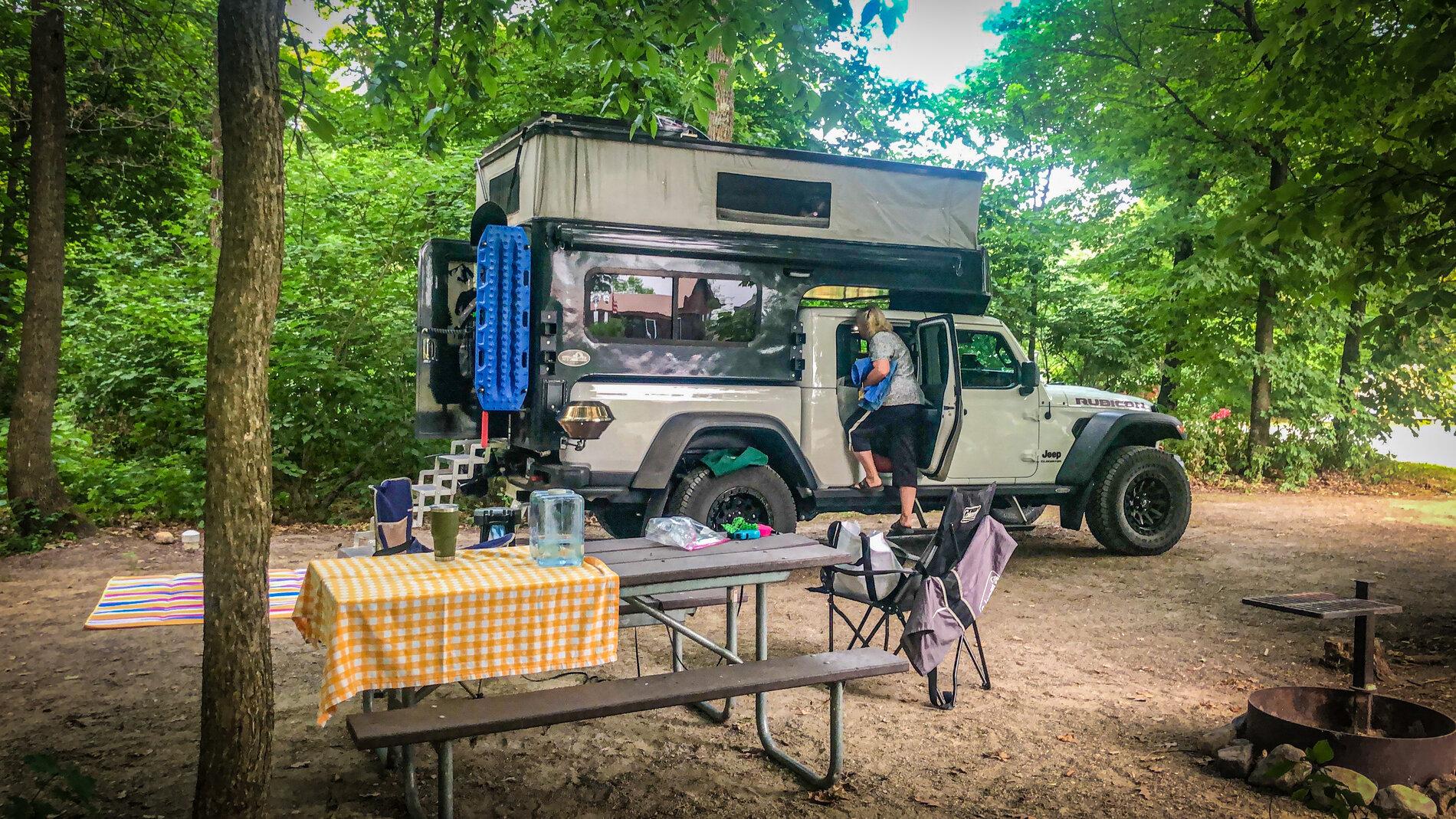

I agree. One reason I wanted to build an overland vehicle was to put it on one of the most capable vehicles being built. Our last overland vehicle lacked power and gearing. The Jeep Gladiator EcoDiesel full filled what I was looking for. A larger full size truck was not in the picture even though it could have a much bigger payload.
The gladiator with the EcoDiesel was just what I wanted.
I will keep tabs on the weight.
So far we love ❤ it.
I want dimensions on those counters. F'ing beautiful!
Edit: total weight of camper and setup?
