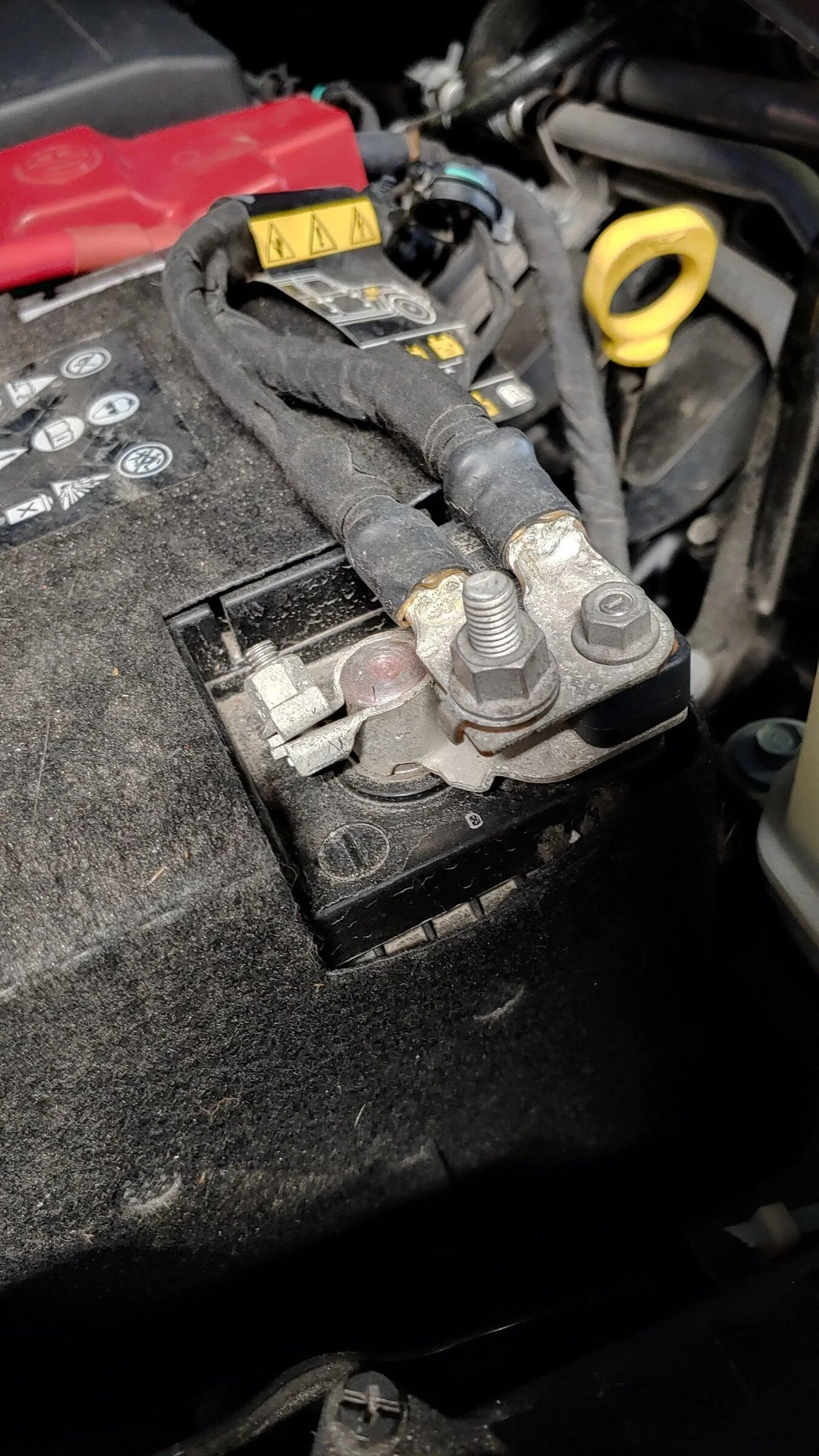

What is the IBS and where is it,,, I am new.
250
40,602
54,292
This is the IBS - the thing the cables are connected to. It is clamped to the negative battery post.
It's a shunt inside that black block with a bunch of electronics inside that monitor the battery state, temperature, charge and discharge rates and more and tracks that info, keeps a history and communicates with the PCM over a network of sorts.
