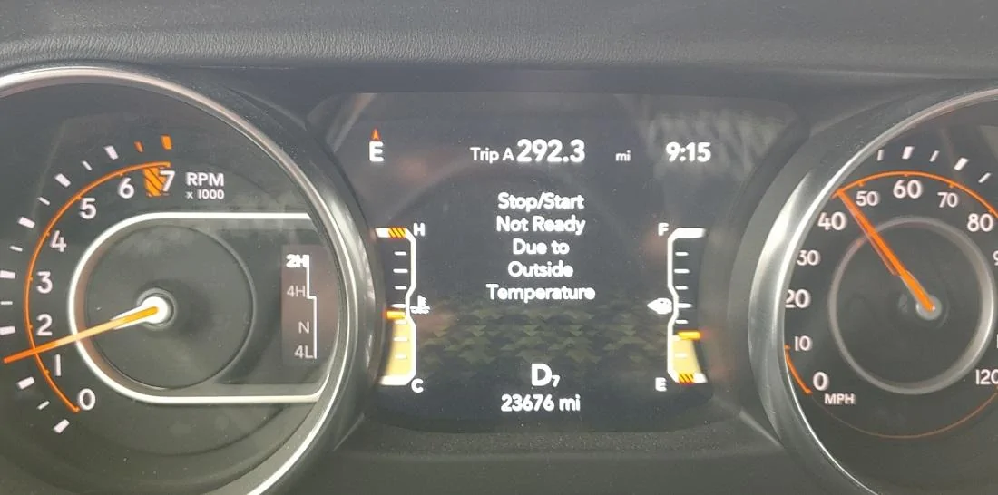

Otherwise, if it's not working because of battery charging, low engine temp, cabin heating or cooling, it will tell you that on the ESS screen if you scroll to that screen and look.
This is one reason - it's 100 degrees outside and climbing - you can scroll up or down to get to this screen and see the reason. If there's no reason, then there's likely an engine issue.
Jeep Gladiator Auto Stop/Start Stopped working. stop-start-outside-tem
