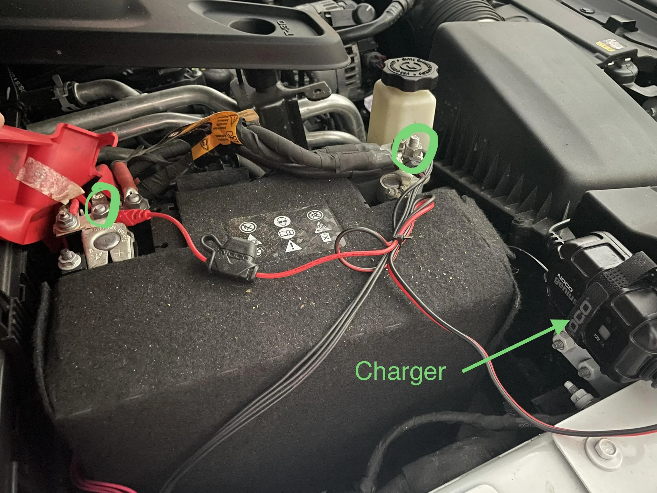

Sarge, it sounds like your your aux battery is faulty. That was the problem with mine even though the dealer claims it tested good. After they replaced my aux and main battery, I’ve been trouble free with the Stop/Start System.
Attached is a picture of my charger location and circleswhere attached to the battery. I haven’t had to us it since replacing both batters.
note to self, if this problem occurs again, I’m going todo that dual battery kit that everyone raves about on this forum.
Thanks, @ShadowsPapa has been a wealth of knowledge helping me figure this out. I appreciate you taking the time to post this pic. I have two chargers/maintainers, one a 2a and the other a 4a, I haven't tried to charge the AUX battery separately (will today).... but I had my semi-permanent charger connected to the fender ground that the IBS/main battery ground goes to. I think I will relocate it to the location you show(and others have suggested).

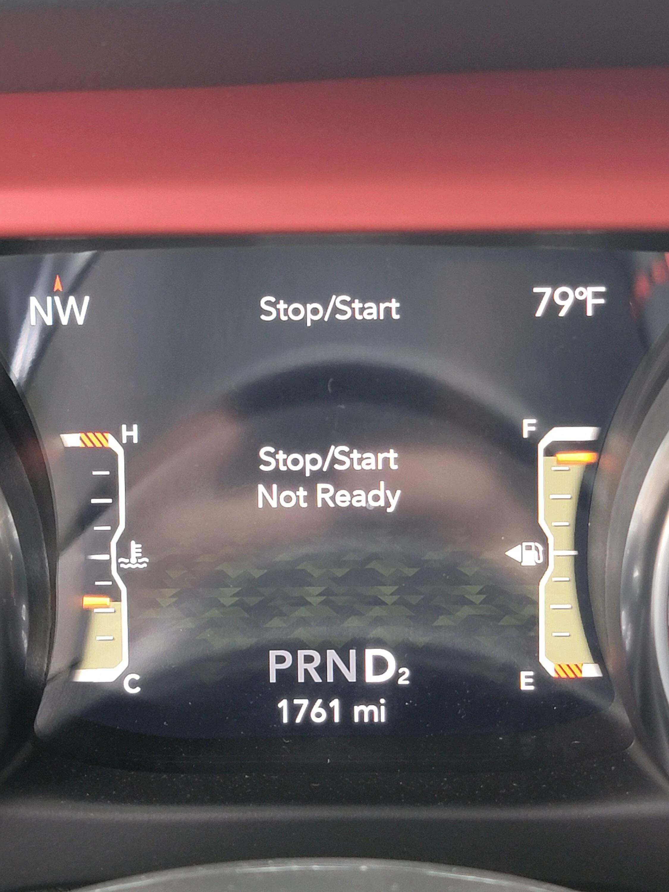

Thanks for the explanation.... my main battery has never failed, I get a very strong startup everytime, the only message I ever get is "not ready "..... I have never received a message that includes "battery charging ".....
hince the confusion, its not indicating why it's not ready.
The ESS system is always active and monitors all the systems in the truck. There are a myriad of conditions that will prevent it from activating, some are outlined in the manual. The ESS screen on the console will provide some Status Messages of its current state, but if not on that screen there are no messages or indicators unless it detects a ESS battery failure at startup.
It is also possible that there has been a programming change in newer models and it has stopped providing detailed Status Messages.

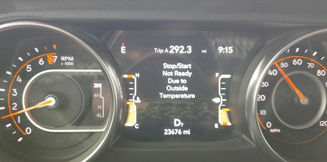

My 2022 tells me if it's due to battery charging of cabin temp/heating/cooling, even if the engine isn't up to temp or I have the steering wheel turned, it says so.
But for anomalies, like a misfire or other things, it doesn't say.

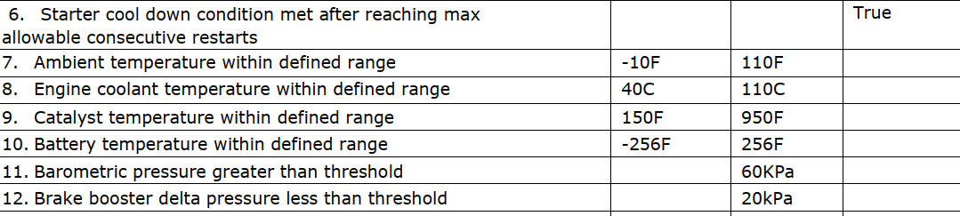

It won't tell you of things like this -
Jeep Gladiator Auto Stop/Start Stopped working. 1659290980710
Although mine has griped about an ambient temp of less than 110 - I sure wish I was the one programming these messages, I'd have some real fun with this one!
Jeep Gladiator Auto Stop/Start Stopped working. stop-start-outside-tem

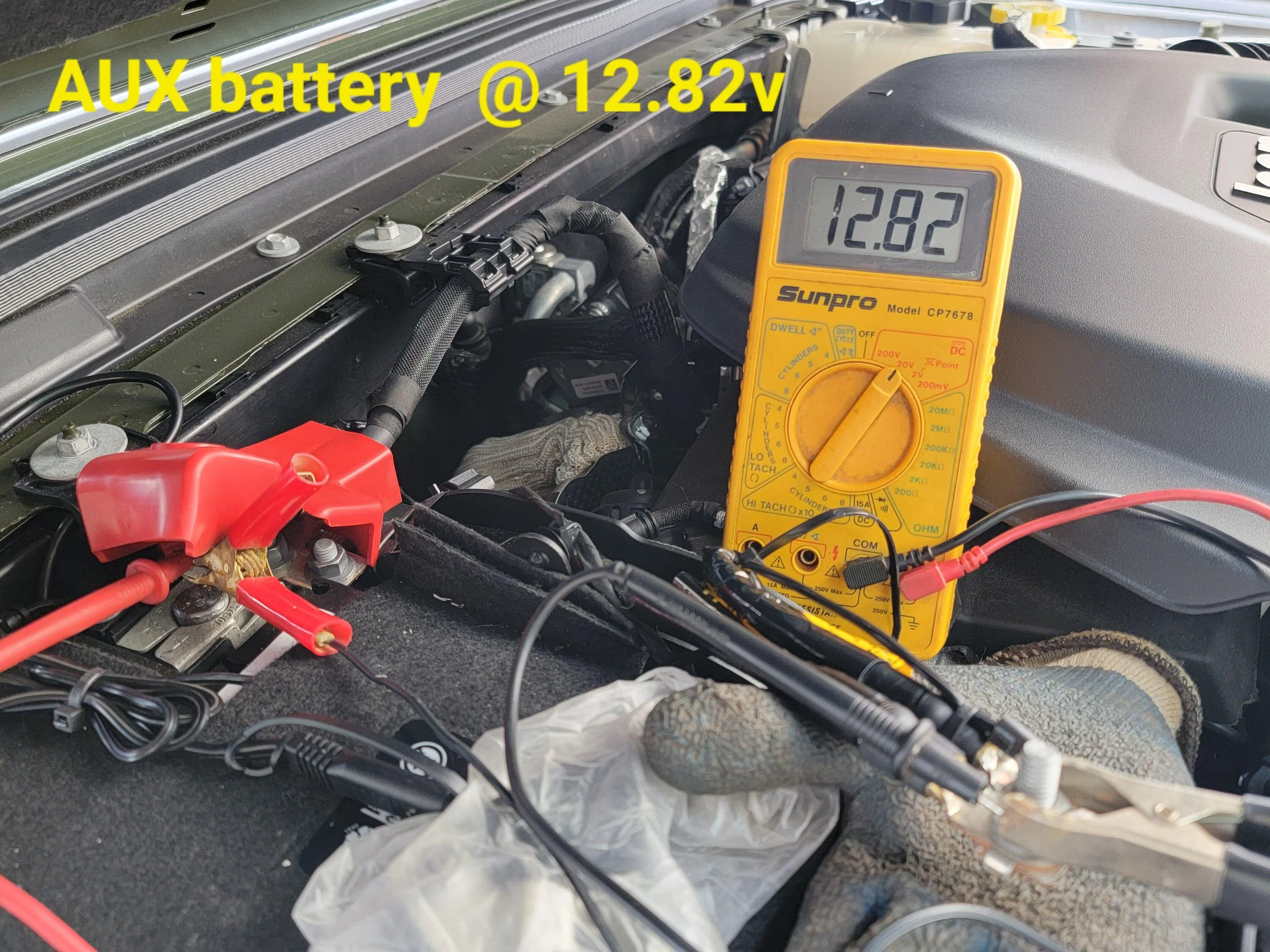

Ok.. decided to do a little experiment..... after several people saying they reset their IBS, I decided to do the same.
I also took this opportunity to charge the AUX battery independently from the main battery.
Completed Aux battery reading:
Jeep Gladiator Auto Stop/Start Stopped working. 20220731_143857

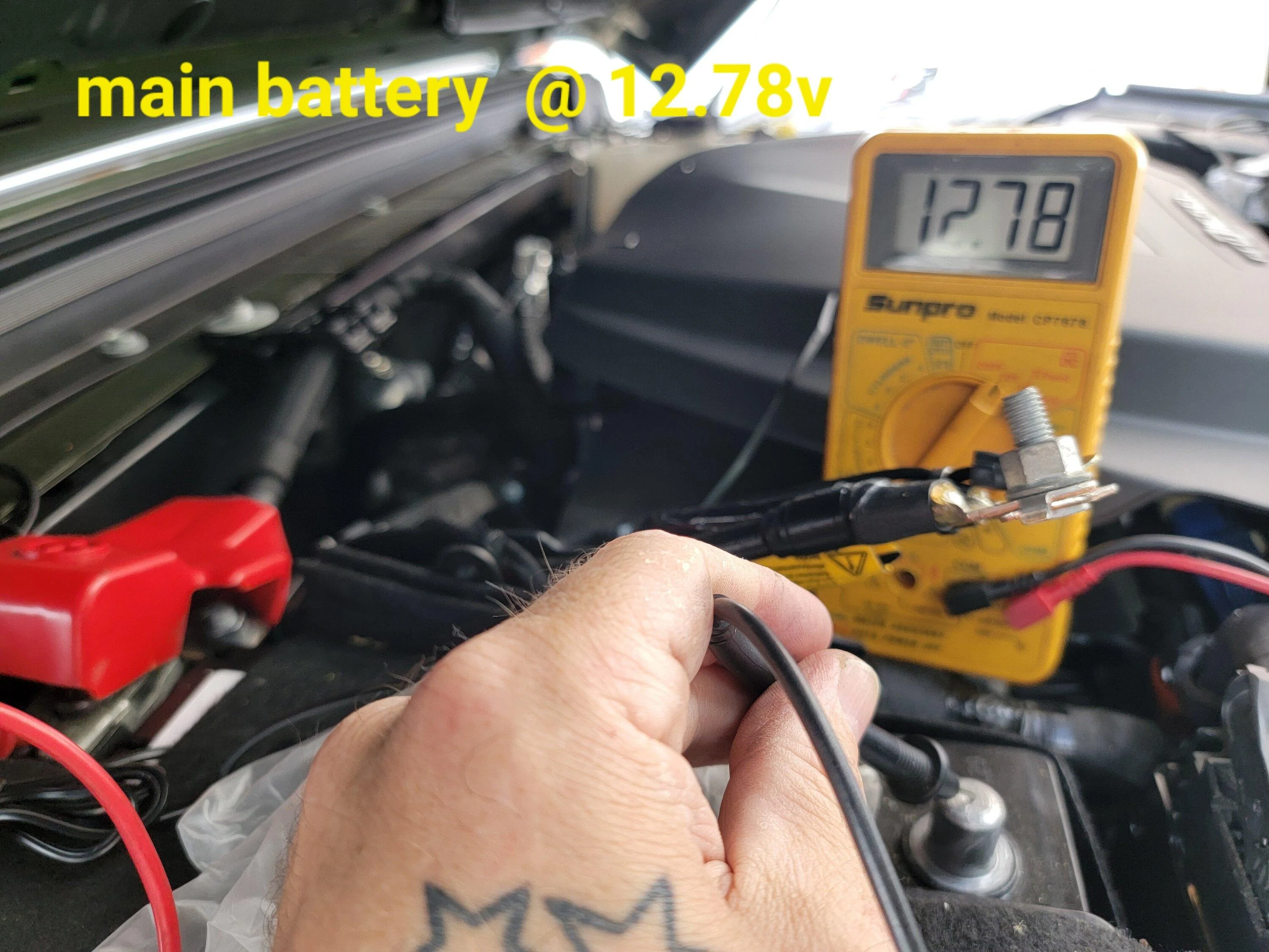

I then charged the main battery independently.
Completed main battery reading:
Jeep Gladiator Auto Stop/Start Stopped working. 20220731_144047

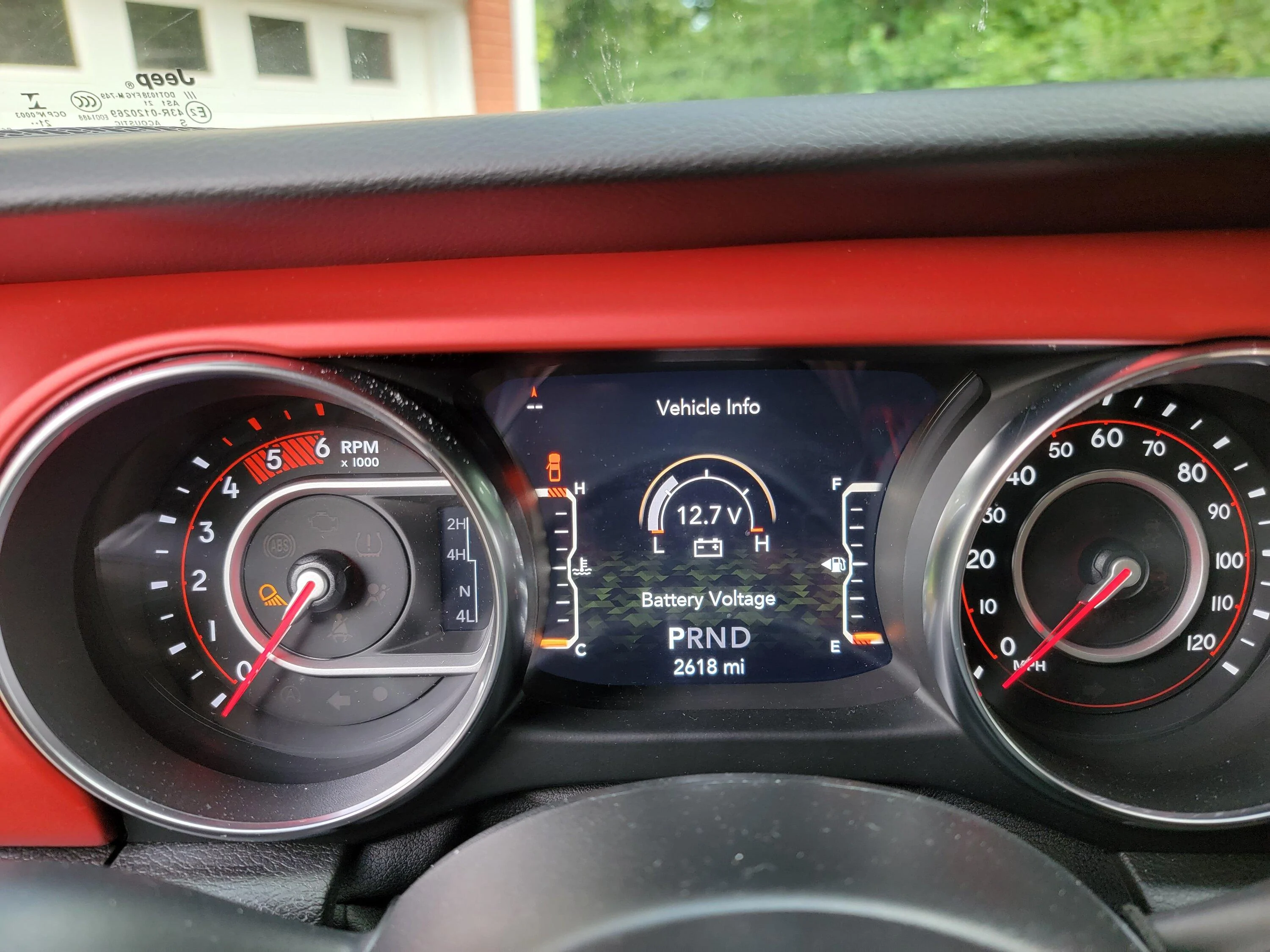

I then reconnected the IBS and connected both batteries back into their parallel setup. I then checked the voltage inside the cabins message center.
This was the result (12.7v)
Jeep Gladiator Auto Stop/Start Stopped working. 20220731_164803

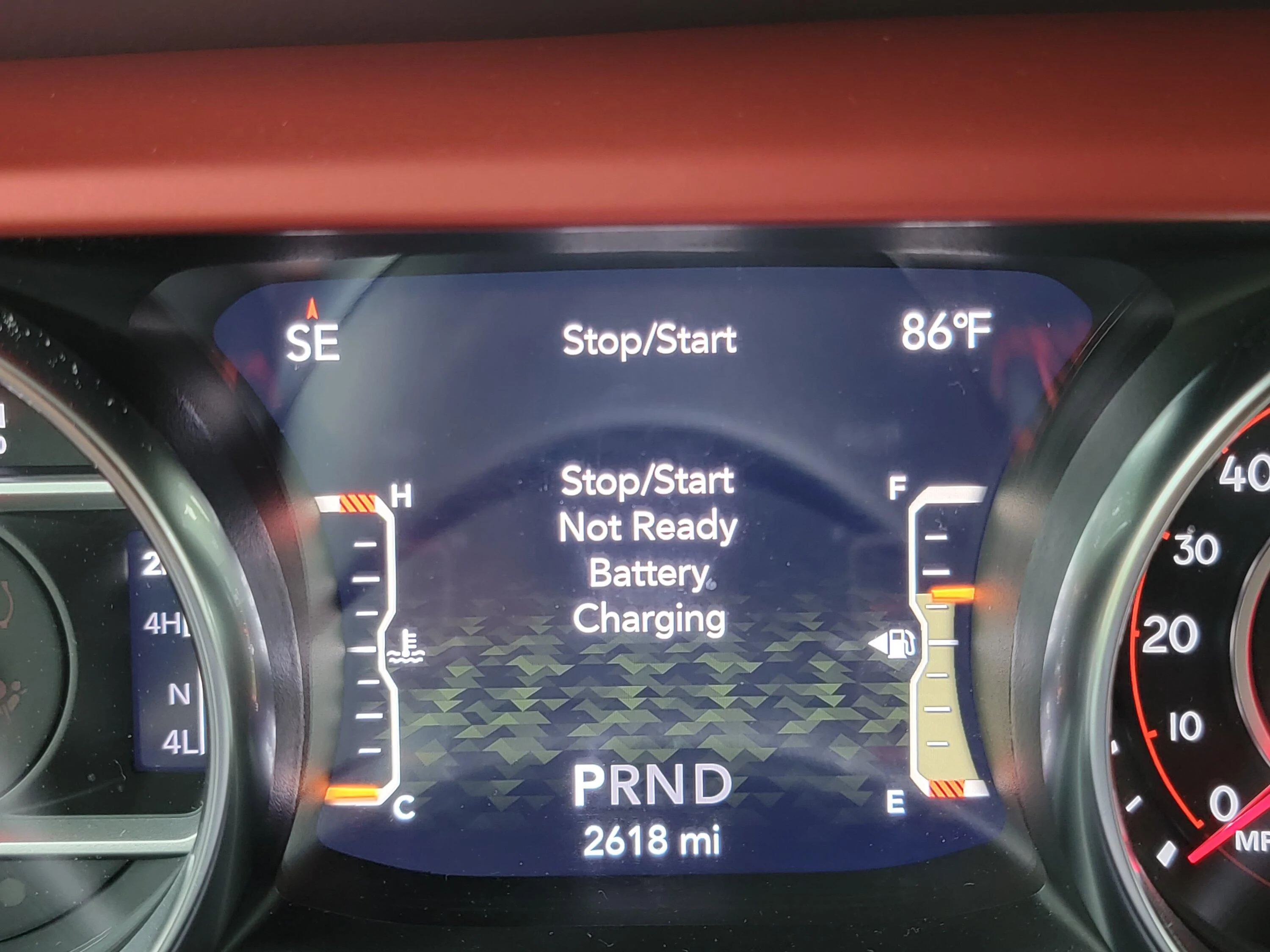

I started the vehicle to check the ESS status and FOR THE FIRST TIME EVER.......I GOT THE "BATTERY CHARGING " status reading.
Jeep Gladiator Auto Stop/Start Stopped working. 20220731_165015
