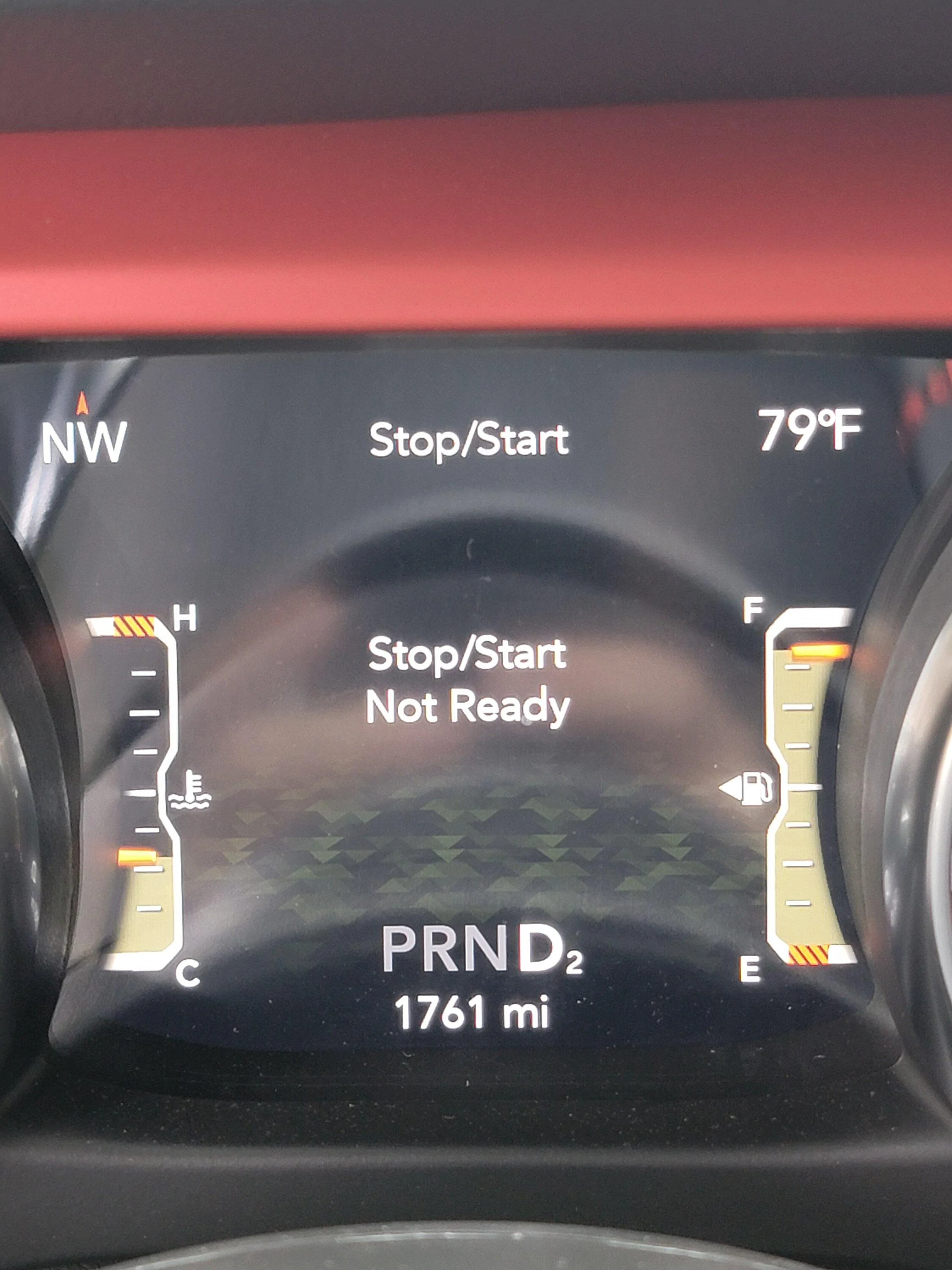

What does the dash screen say? It gives you the status of the system on one of the pages. There are a bunch of reasons that it won't engage that system, and they aren't necessarily it "being broken". It needs conditions to be just right to function.
Not necessarily..... mine works when it feels like it.... but when it doesn't, it only says "not ready"... I'm assuming it is because the aux battery is low.
t
Because there isn't a battery sensor monitoring the aux battery, there is no way for the system to know the state of charge of the aux battery until it actually fails. The aux battery is tested during every cold start and if it fails, ESS is disabled and the error light turned on.
Thank you for the info.......
So if tested & fails at start-up, I wouldn't get the "battery charging " error, because it would not send a charger due to failure ?
So from getting the "not ready " only, would this lead you to believe the AUX battery is bad, or just low from lack of driving ?
So the IBS, doesn't monitor both batteries ? If not, is the only reason the -neg cables are bound together ontop of the main battery for the parallel connection ?
