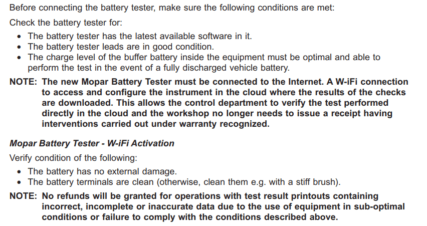

OK, I was just wondering if I had missed something, and was wondering about the exact text and so on.
Here's the kicker on your battery thing - Jeep and others are extremely tight on battery warranty. There's a specific test that they must perform "by the book" and the results included with the warranty papers (at least that's how I read some of the info I found?!?)
It's a GR8 test device and procedure. The battery to be tested needs to be at 12.4 volts and it's a load test. I've found nothing about over-night so I wonder what they are doing?
Maybe they did a full over-night charge process then tested them because the test is not long.
Anyway, from what I've seen, they need to print the GF8 results for warranty reimbursement. Maybe one of the real techs here can confirm or say "no way" to that.
I guess in a way, with what we are seeing, experiencing, and your results and experiences, we're finding that Jeep and the shops are in the "we have no real clue" area right now and punting.
We do have to have a printout of the test results from the GR8 tester for warranty claims, also have to have a screen shot of the WiTech screen with the GR8 test verification. It is a convoluted thing to do just to get paid for a warranty claim on a battery or batteries. It is not that is dealership techs don't want to replace defective batteries, but Stellantis doesn't make it any easier for us. Until this latest round of rules, I was usually able to get both batteries approved with just a quick test with the GR8.
Also, you are right about charging the batteries THROUGH the IBS instead of "blind" charging at the post. Always charge through the IBS, this reduces the amount of time that the IBS requires to learn the correct state of charge.
Yeah, I've got the instructions on battery claims. As I recall, GM is similar. They specify the tool, how to use it, and a host of other things.
I'll bet this looks familiar to someone like you LOL -
Jeep Gladiator Auto Stop/Start Stopped working. 1656555852352
