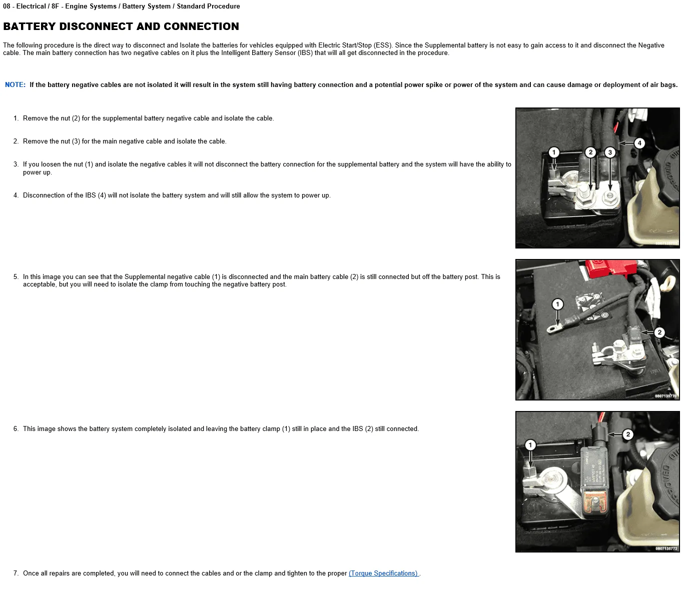

Resetting the IBS just involves completely disconnecting it for about 10 minutes. The two wire connector on the IBS is the feed into the computer system. Rebooting the system requires both batteries to be disconnected. The negative cable from the ESS battery and the negative post on the main battery both need undone.

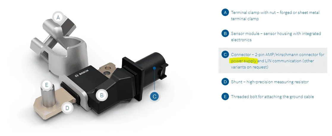

One of the two wires is 12v power. Removing the two wire connector will power cycle the IBS, won't that reset it?

Technically, you could leave that small connector plugged into the IBS and pull the aux connection off the IBS and pull the IBS off the battery.
To me that makes more sense since I am charging batteries.
Last reset I did - I left that network/power connection plugged in and took the cables off the IBS, took the IBS off the battery, and charged batteries.
Quote from Jeep -
it be should installed onto a fully charged
battery and follow the same learn procedure above.
Disconnect the battery ground cables and get them out of the way. That kills power to the IBS.
So - in summary - yeah, that disconnects power, but why, because =
you really want it off the battery and the aux disconnected anyway to charge the batteries.
Don't reset it and put it back on batteries without charging them.
You can leave that connector pugged in as long as it's off the crank battery neg post and the aux cable has been taken off the top of the IBS.
You can technically do it either way.

I believe this is from the tech manual , the same for the JL & JT.

Interesting note - there have been at least 3, likely 4, versions of the IBS used on Jeeps.

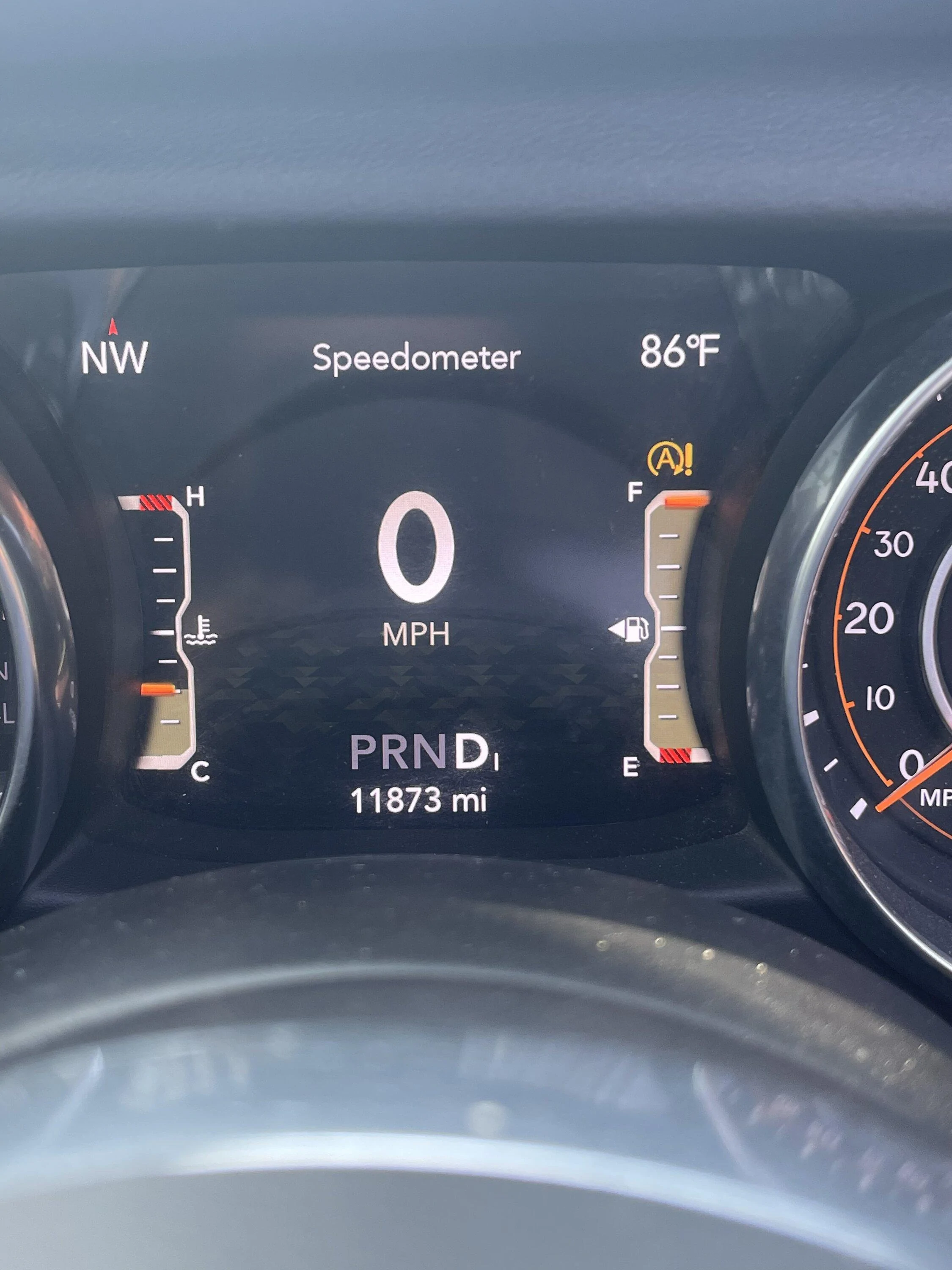

SMH. Guess I better join this thread. Started the other day returning from a road trip. Message came up “auto start disabled” or something to that nature. Cut it off and back on a short time later and it was gone. Cleared any codes using my Taser Mini and gave it a couple days and now it’s back on.
That's a very different animal - that's indicating aux battery issues or similar issue, that's not due to something being not ready.
Even with the misfire, or with a "battery charging" message, I've not had that alert light.
I would have that checked by the dealer.
