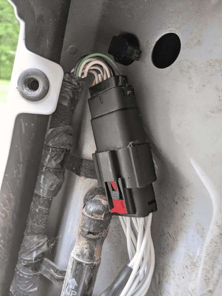

Mine was a few inches short routed the correct way. I was only able to attach it after unclipping the tail light harness from this plastic clip. The cable is still TIGHT, and I had to lower my 35" spare to get my hands between the bumper and spare to make the connection.

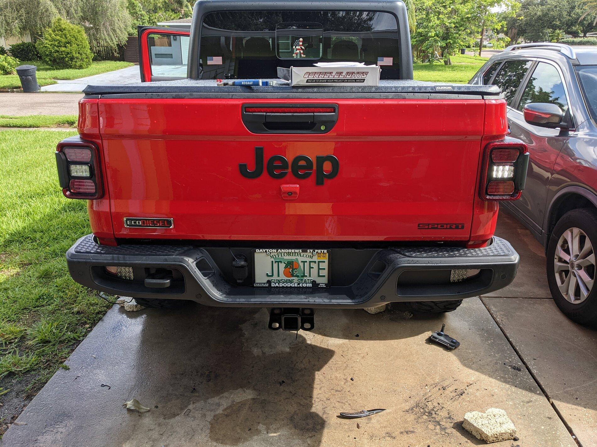

The sport model with the led taillights and sensor in the bumper is not. Both lights needed to be modified by reducing the locator pins , no biggie, not plug and play. To the engineering aspect and not wasting any material, Aces to you guys! except that one INCH of wire would really help for the 2.0 version.

Two hours, frustrated, plug and play... Fail
I'm sure it's just a wiring thing.....
But I'm so steamed right now my glasses are fogging up....

And to piss in my cornflakes, last night when I tested the drivers side after initial install, the drivers side worked.....

Jeep Gladiator Auxiliary LED Reverse Lights (Integrated Rear Bumper) PXL_20210702_141753954
