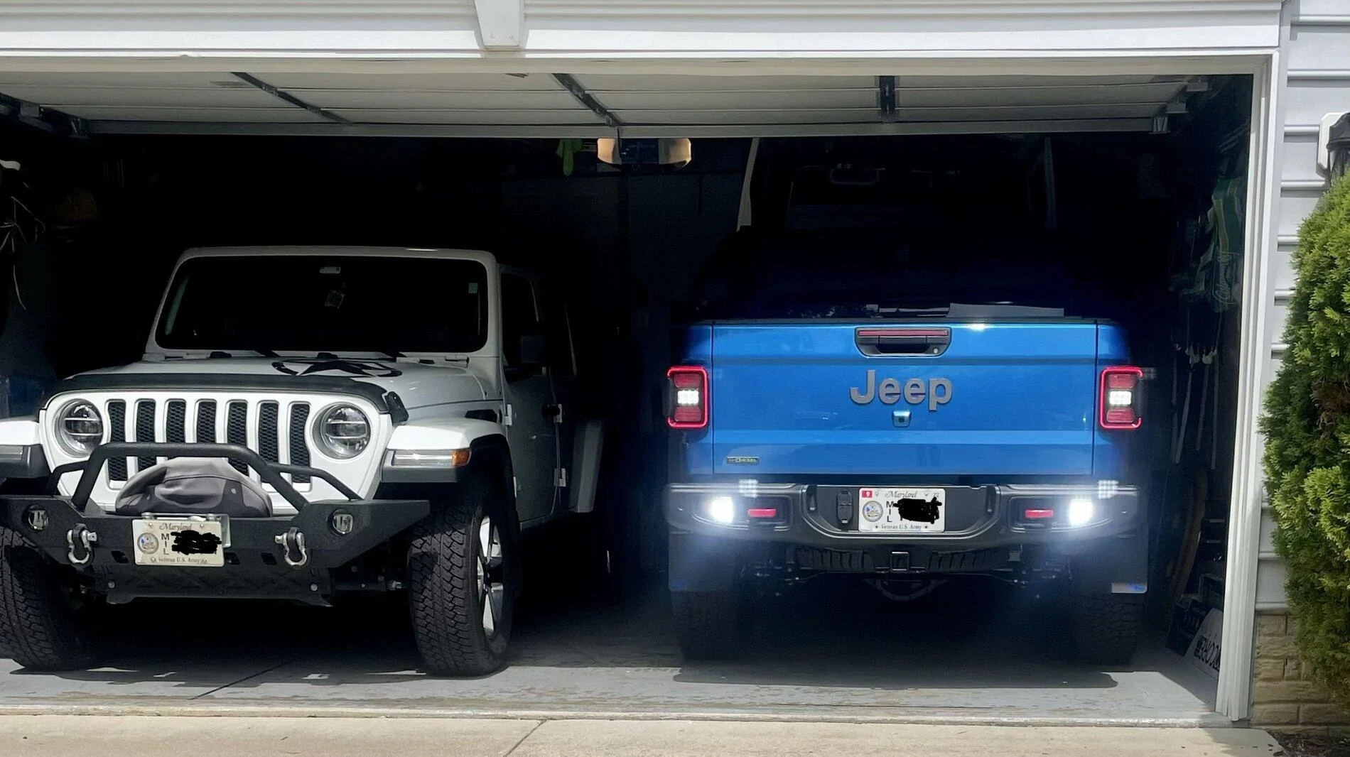

Finished.... I was trying to tap into their wiring harness for an additional led strip already installed under the tailgate, one of those with the brake and turn lights, this strip has white LEDs for reverse and I guess it's too much draw for the circuit, disconnected that and now everything works..... I say again, one more INCH on the lead for the passenger side would help tons......

While I anxiously await the USPS driver bringing my bumper lights, I installed some Oracle LED strips in the front footwells of my hydroblue rubicon. When I finished, took 10mins, I noticed the mail truck down the road…and another mail truck drove by…one broke down and they are migrating the load to the other one. SMH.
Jeep Gladiator Auxiliary LED Reverse Lights (Integrated Rear Bumper) 927A4F57-6794-4B21-9292-69AFEA7DD673

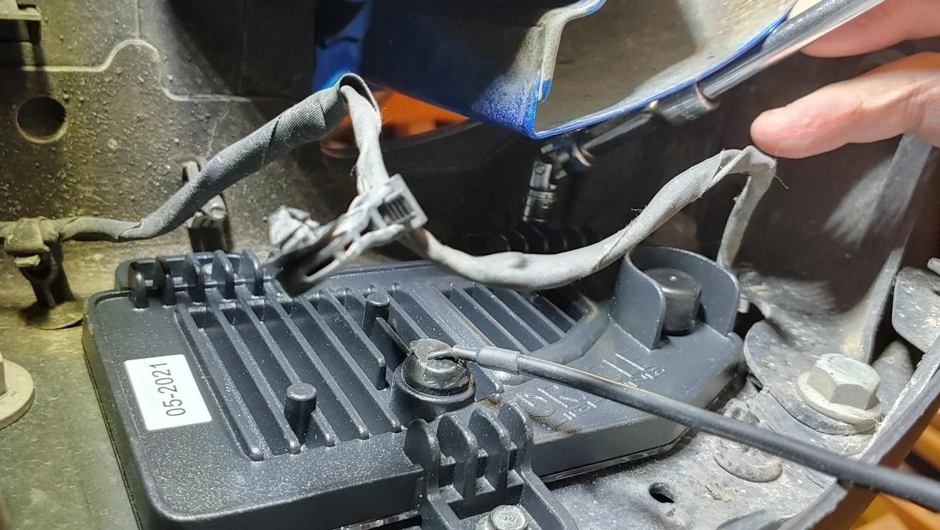

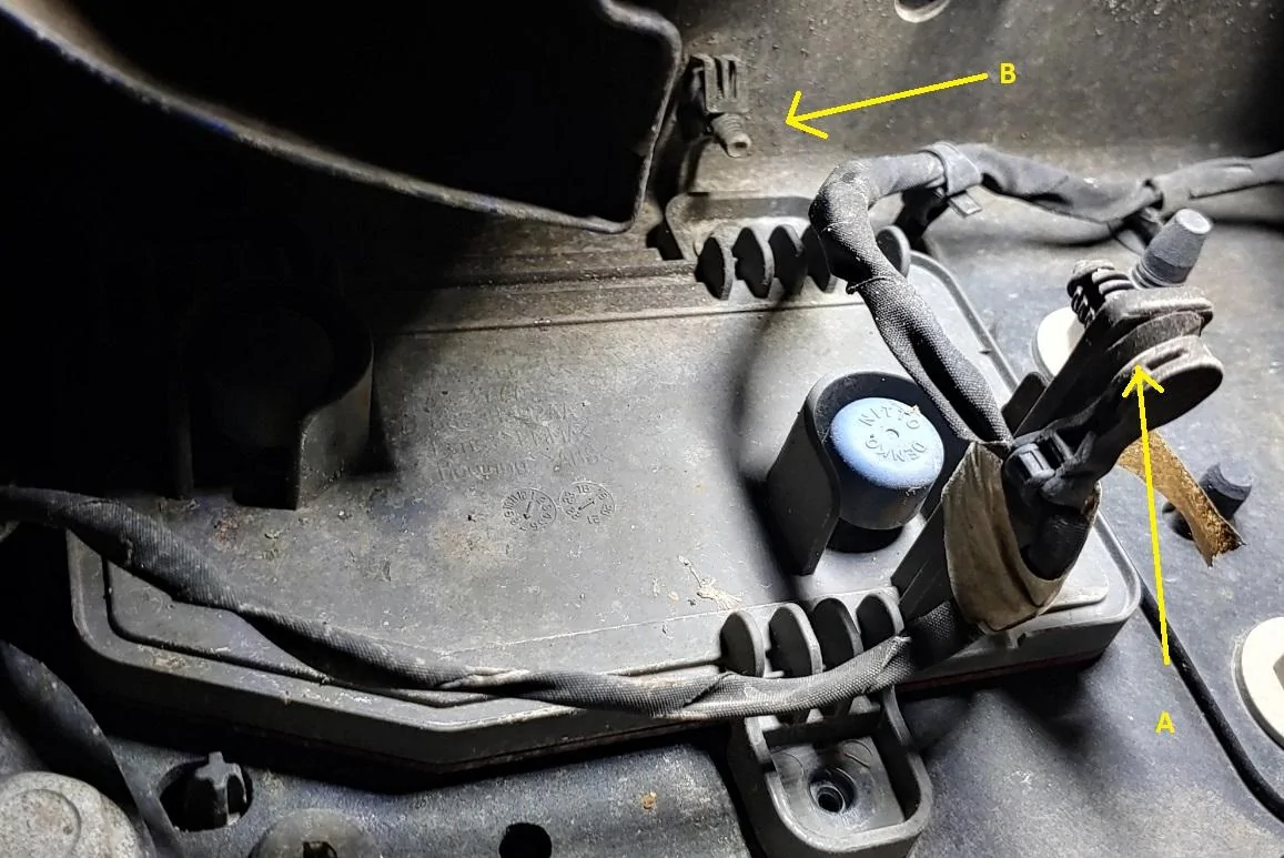

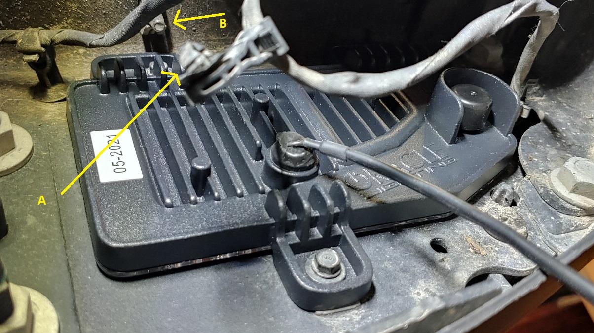

Here's a pictorial of my install.
Notes -
I routed the right side wire out the uppermost hole on the lest side. That way the wire comes out ASAP and is right up against the bottom of the truck. To route it through a lower hole means you lose another inch of wire.
I also did not trim any piece on the lights. I was able to tip an end into place and rotate the light up and around into place while protecting the light's face from the bumper bolt with the other hand.
Forget the ratchet, use a nut driver or handle and socket, and a flex for the top screw. Piece of cake. I had the lights in place in about 10 minutes or so. The wiring - that's another matter..........
But with a nut driver, or a handle and socket with flex, those things come out and go in really fast. There's no real torque on them so that's all you need. If you have the safety stuff, park assist and so on you need to remove a couple of clips from your reflectors so use wire cutters or pliers or whatever for that.
A is where you need to released the sensor harness, B is that bolt everyone talks about being in the way. I already have the lower screw out in this photo - and on this left reflector, the top screw in the right in the photo was loose, it was out at least a turn already.
Jeep Gladiator Auxiliary LED Reverse Lights (Integrated Rear Bumper) 20210702_110203
First light in place, driver side. That bolt again (B) and the wire clip I snipped off (A)
Jeep Gladiator Auxiliary LED Reverse Lights (Integrated Rear Bumper) 20210702_111254_HDR
Handle, flex and socket - seconds out, seconds back in. Did not snip or remove any part of the new light pin
Jeep Gladiator Auxiliary LED Reverse Lights (Integrated Rear Bumper) 20210702_111322_HDR
Jeep Gladiator Auxiliary LED Reverse Lights (Integrated Rear Bumper) 20210702_111358_HDR

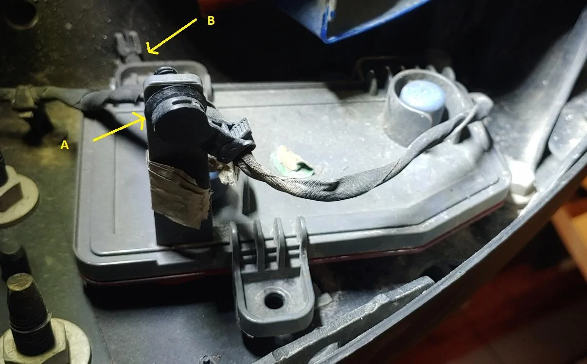

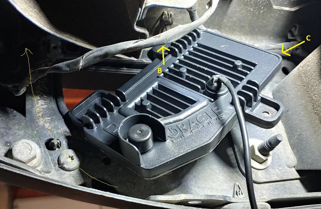

Passenger side light - that bolt (B) and the clip to snip for the sensor harness (A)
Jeep Gladiator Auxiliary LED Reverse Lights (Integrated Rear Bumper) 20210702_111516_HDR
Tipped B up behind that bolt sticking down, my other hand was at C to protect the light from the top bumper bolt end, and I swung the light up into place. So is my Overland bumper different than the bumpers on those where people had to trim the post on the lights? Shouldn't be. Should be the same as others, I would think. In any case, using this method I didn't cut the lights at all.
East part done - now the wiring which was indeed too short by 1-2".

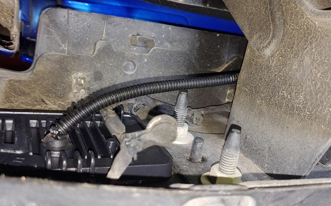

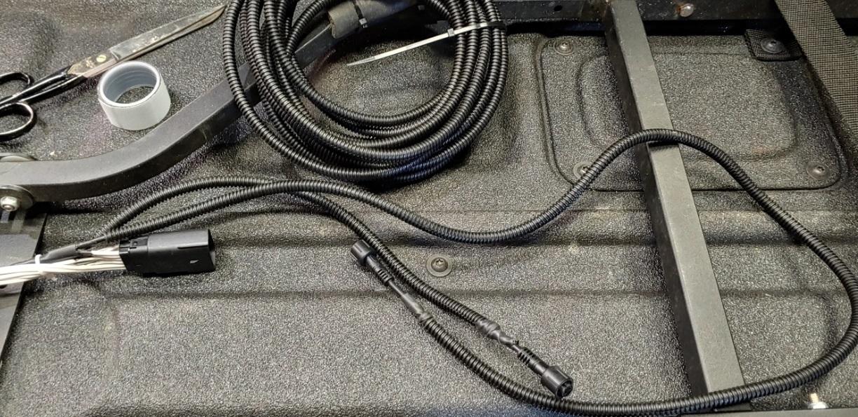

I put that plastic loom on the leads going to both lights from their "adapter". I always have a lot of that around for the cars I rewire and work on. I secured it from sliding by using a rubber tape that sticks to itself. Take off the protective film on the one side and pull it tight around the wire and loom as you wrap it and it's not sticky, but sticks to itself, making a seal and holding the loom from sliding around.
Jeep Gladiator Auxiliary LED Reverse Lights (Integrated Rear Bumper) 20210702_115845_HDR

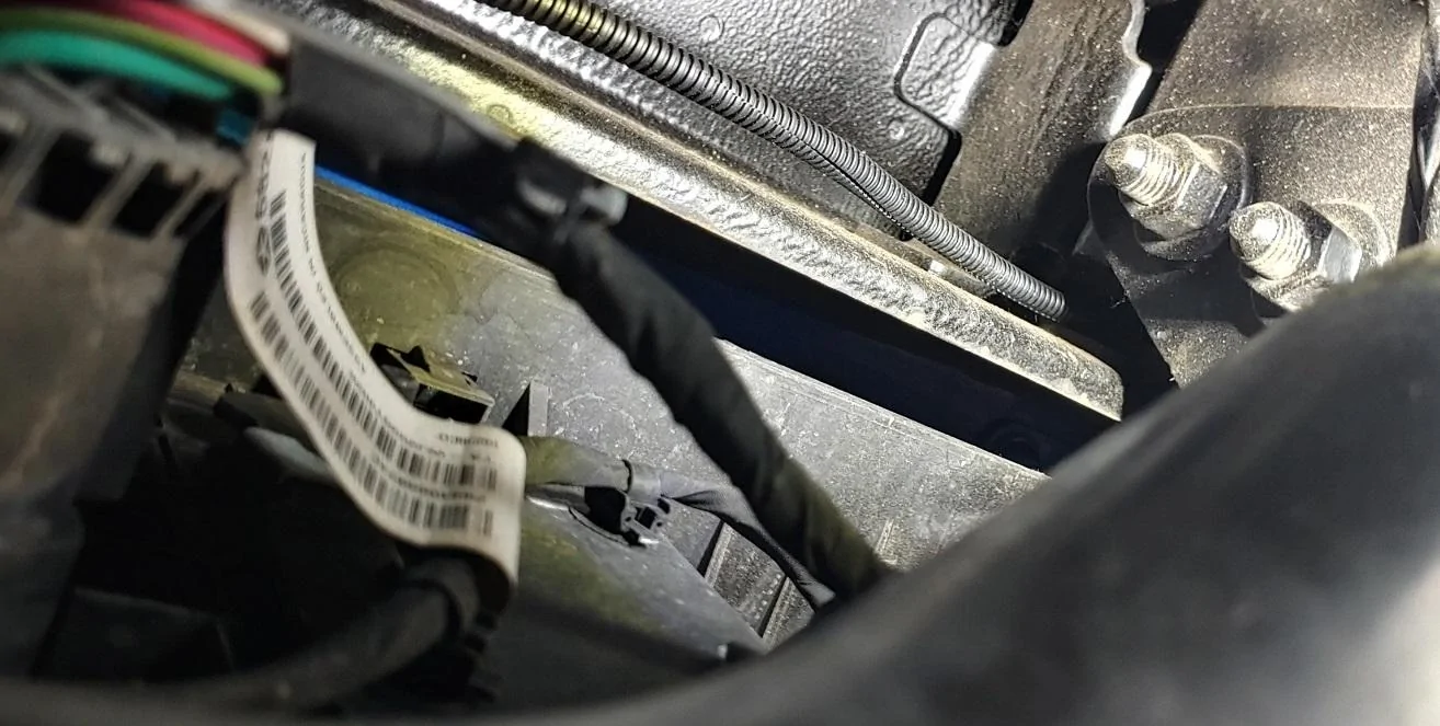

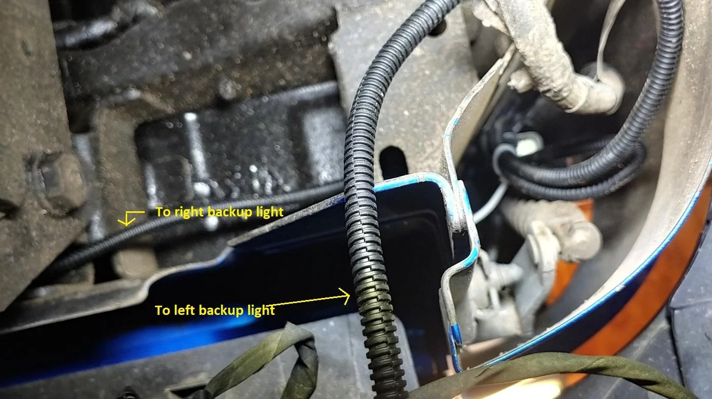

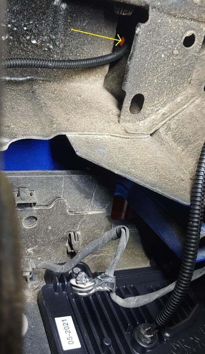

Tried all locations and decided the top hole is the one that uses the least wire to get out of the tail light chamber area. Go lower and then out you use at least another inch - go out the bottom you waste 2 inches of wire or more before the wire that start the journey to the right. This hole means the wire doesn't go down as far and can start heading to the right side immediately.
Jeep Gladiator Auxiliary LED Reverse Lights (Integrated Rear Bumper) 20210702_122350_HDR

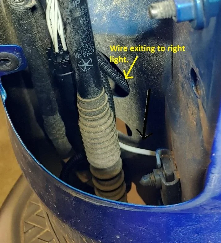

This is the wire leading to the right side light - it exits high and immediately makes a turn to the right side and goes along the bottom of the truck.
Jeep Gladiator Auxiliary LED Reverse Lights (Integrated Rear Bumper) 20210702_122453
Jeep Gladiator Auxiliary LED Reverse Lights (Integrated Rear Bumper) 20210702_122509_HDR

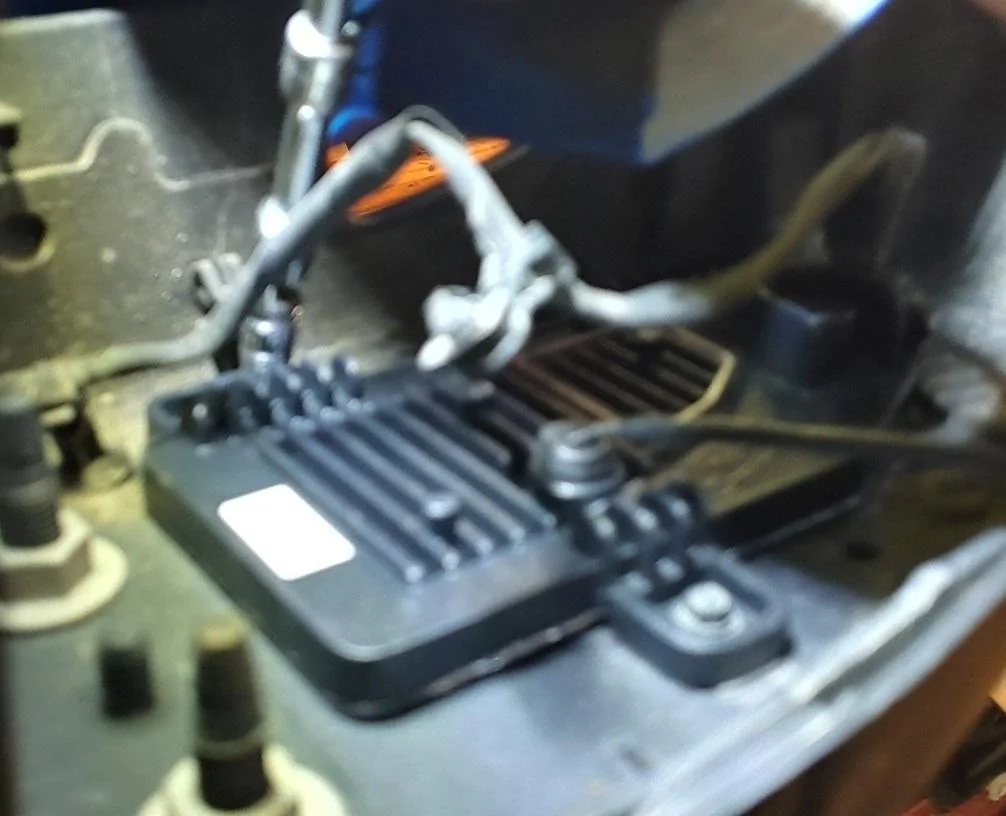

I pulled and got it connected but - I literally pulled. There's zero slack.
Jeep Gladiator Auxiliary LED Reverse Lights (Integrated Rear Bumper) 20210702_122537_HDR

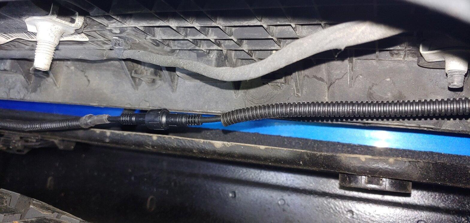

Do NOT like the fact there is no slack, no loop, it's pulling on that rubber it goes through into the light assembly. I can't even pull it up high and tie it - there's not enough wire to tie up out of place. I'll just have to tie it to the sensor harness loosely as I tried pulling it up to where that harness is tied and it won't reach.
Jeep Gladiator Auxiliary LED Reverse Lights (Integrated Rear Bumper) 20210702_122550
Going to see if there's a way I can gain some slack to tie that right side light harness up out of the way. I don't want to take the tail light harness out of its clip and let it shake and rattle around in the body. Wires harden when the are allowed to flex. Anyone notice how new vehicles have wires secured so they can't vibrate? There's a reason.
Jeep Gladiator Auxiliary LED Reverse Lights (Integrated Rear Bumper) 20210702_122647_HDR
