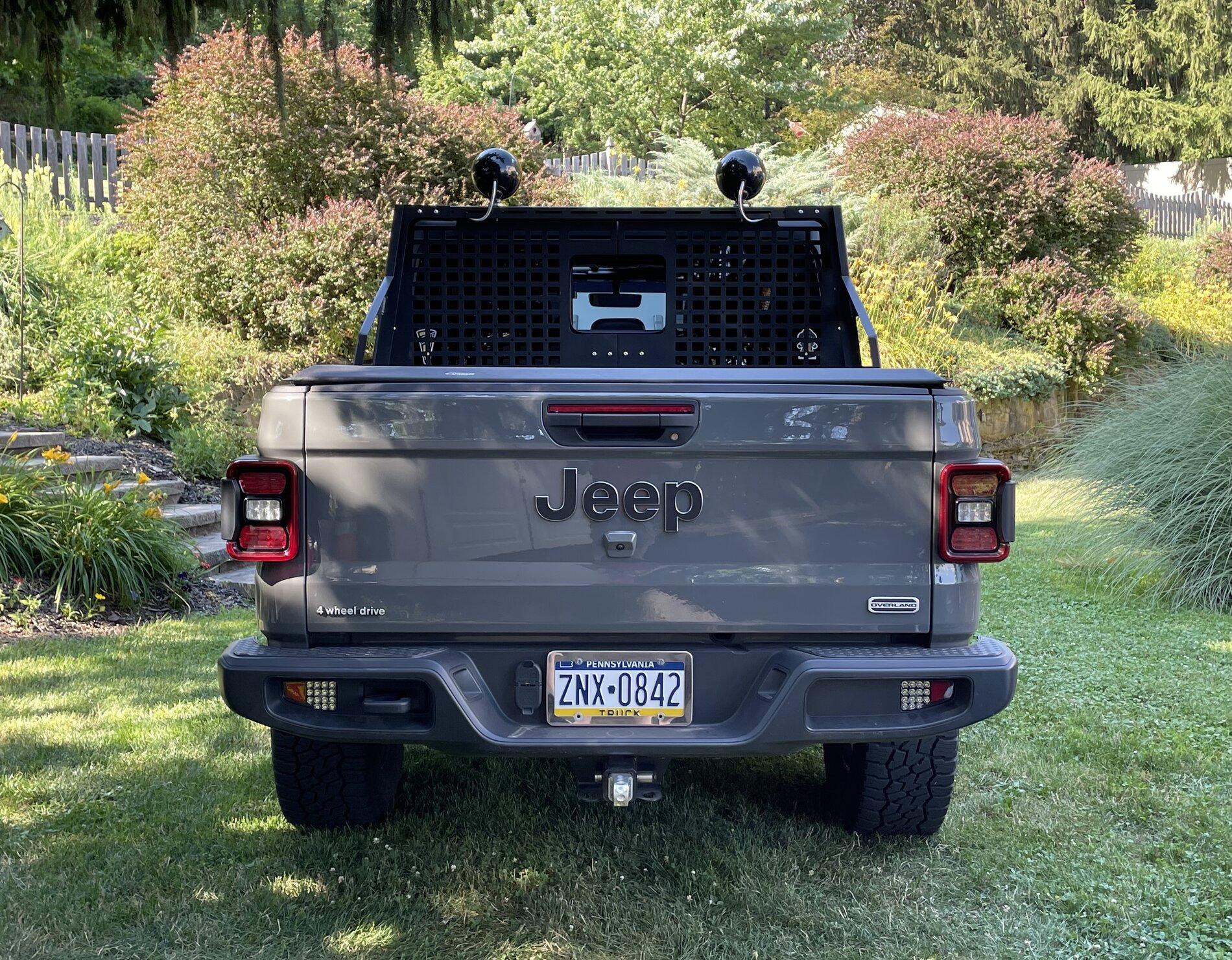

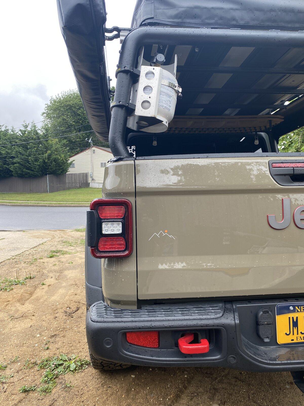

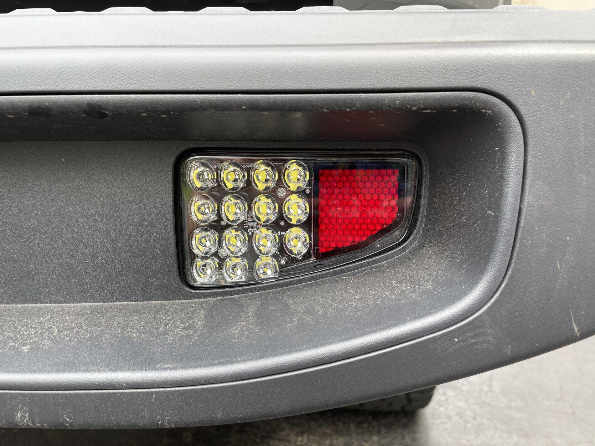

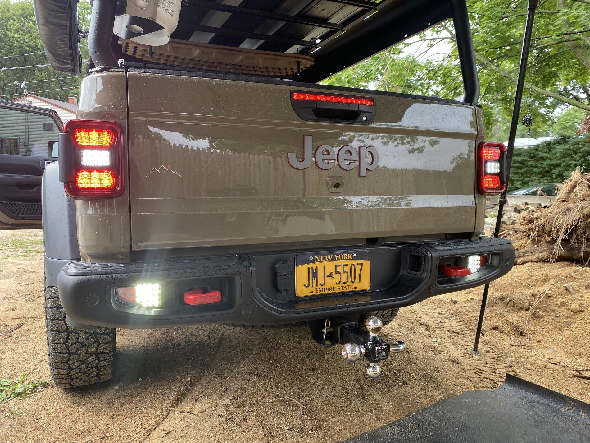

Just installed mine with the PNP kit. I’m not sure if I did something drastically different than others but I have my wire running to the passenger side without it being incredibly tight as some have posted. Would another 1-2 inches make sense so we can run it how we want and zip tie it where we need it. Sure. Deal breaker. Not at all. I did end up putting one zip tie on the run to the passenger side to keep it from bouncing around. I do also plan on adding a switch with a diode to turn on the lights at my leisure. More on that later. See below pictures and video. Night shots to follow.
Jeep Gladiator Auxiliary LED Reverse Lights (Integrated Rear Bumper) 93960A11-4D8E-4B6C-A012-085A0D784F67
Jeep Gladiator Auxiliary LED Reverse Lights (Integrated Rear Bumper) 0CA103F1-299E-4339-9C4E-B1EC5DBF44FE
Jeep Gladiator Auxiliary LED Reverse Lights (Integrated Rear Bumper) C64E4405-0DE5-4F14-8017-1576FE97CE6B
Jeep Gladiator Auxiliary LED Reverse Lights (Integrated Rear Bumper) 5C6F0579-62B4-47AE-B2C0-689FA69C0504
Nice job @ORACLElights

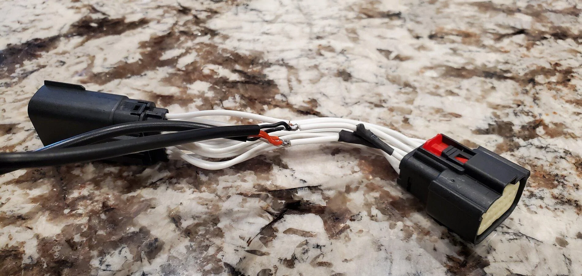

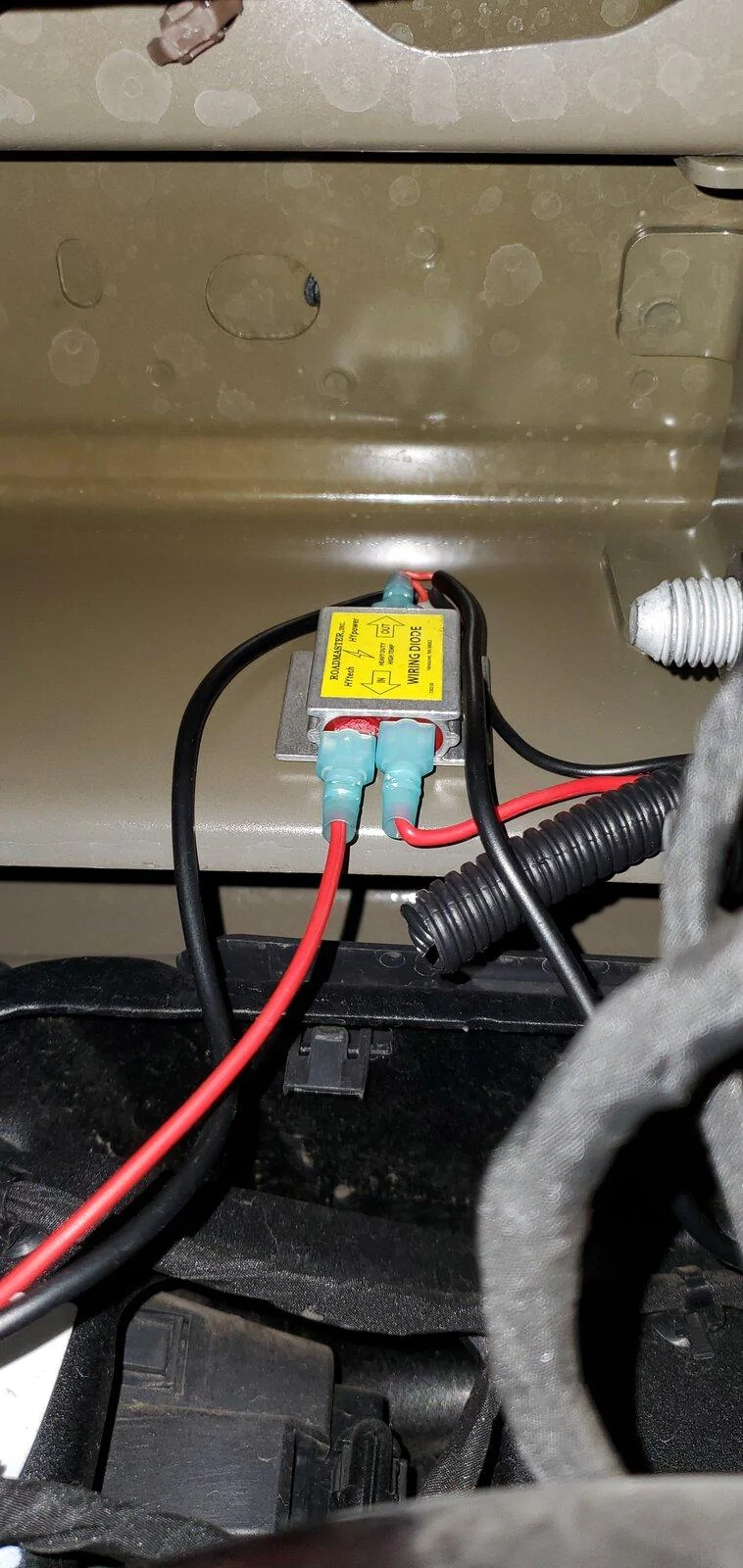

Just finished mine up. PNP harness worked without issue. I also added a hot input from my AUX 4 to control them independently from the reverse lights. I took that opportunity to lengthen the PNP harness since I had to open it up anyway for the AUX input and given the multiple complaints of being a little too short.
How’s your aux wired with the diode? I am going to try to look for one at a store nearby, Amazon doesn’t have it at the moment.
