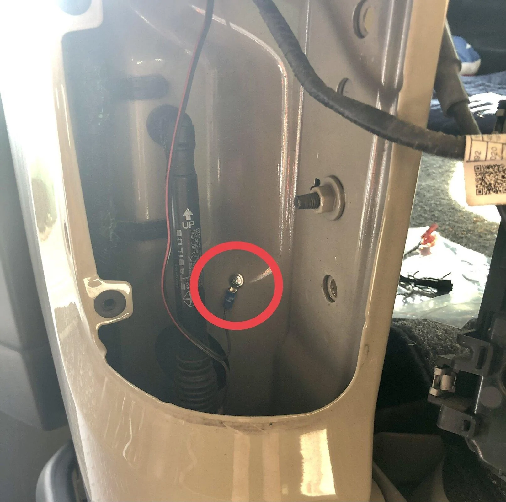

If y’all are looking for a ground
Not factory, though - I can see crimp marks there. So you are meaning YOU added a ground point there, correct?

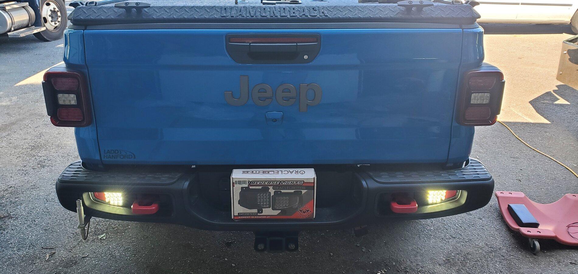

Installed my lights today. I decided to just wire them to the Aux 4 switch. Since I mostly only wanted them on a as needed basis, and for camping. I'll try to get some night pictures this evening (reverse camera, standing on bed, and looking towards the truck etc)

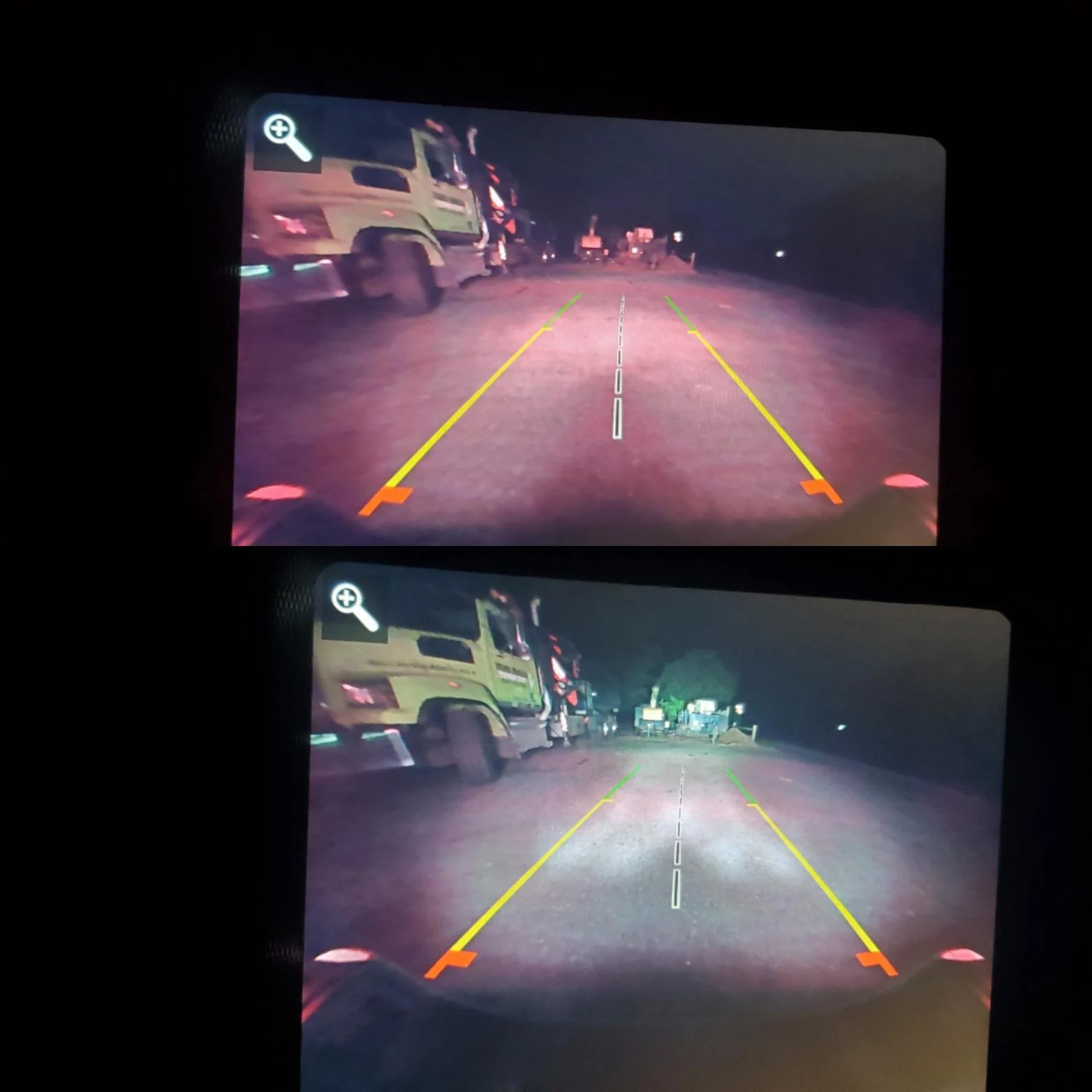

Night pictures. Top picture, in every set, is just oem reverse lights. Bottom picture is both oem and oracle.
Reverse cam
