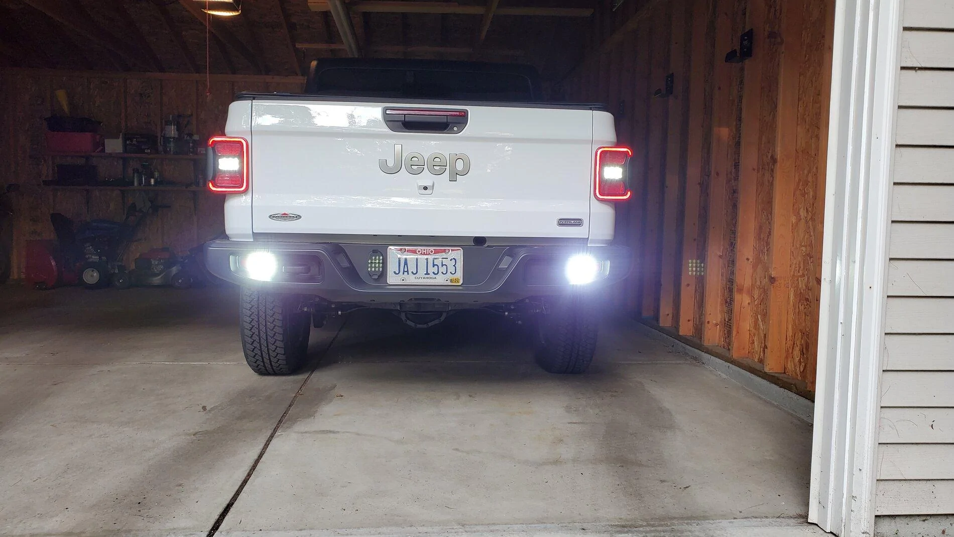

Got mine in and working. Had to take the body side tail light connector off its mount, went as direct as humanly possible to the passenger side and it *just* connected but it's tight. When the extension comes I'm going to put it in so I can get the tail light plug back on its mount. Rather have excess slack then tension and the unmounted plug bouncing around behind the tail light.

Just backed up my dark driveway. LOVE these lights.
