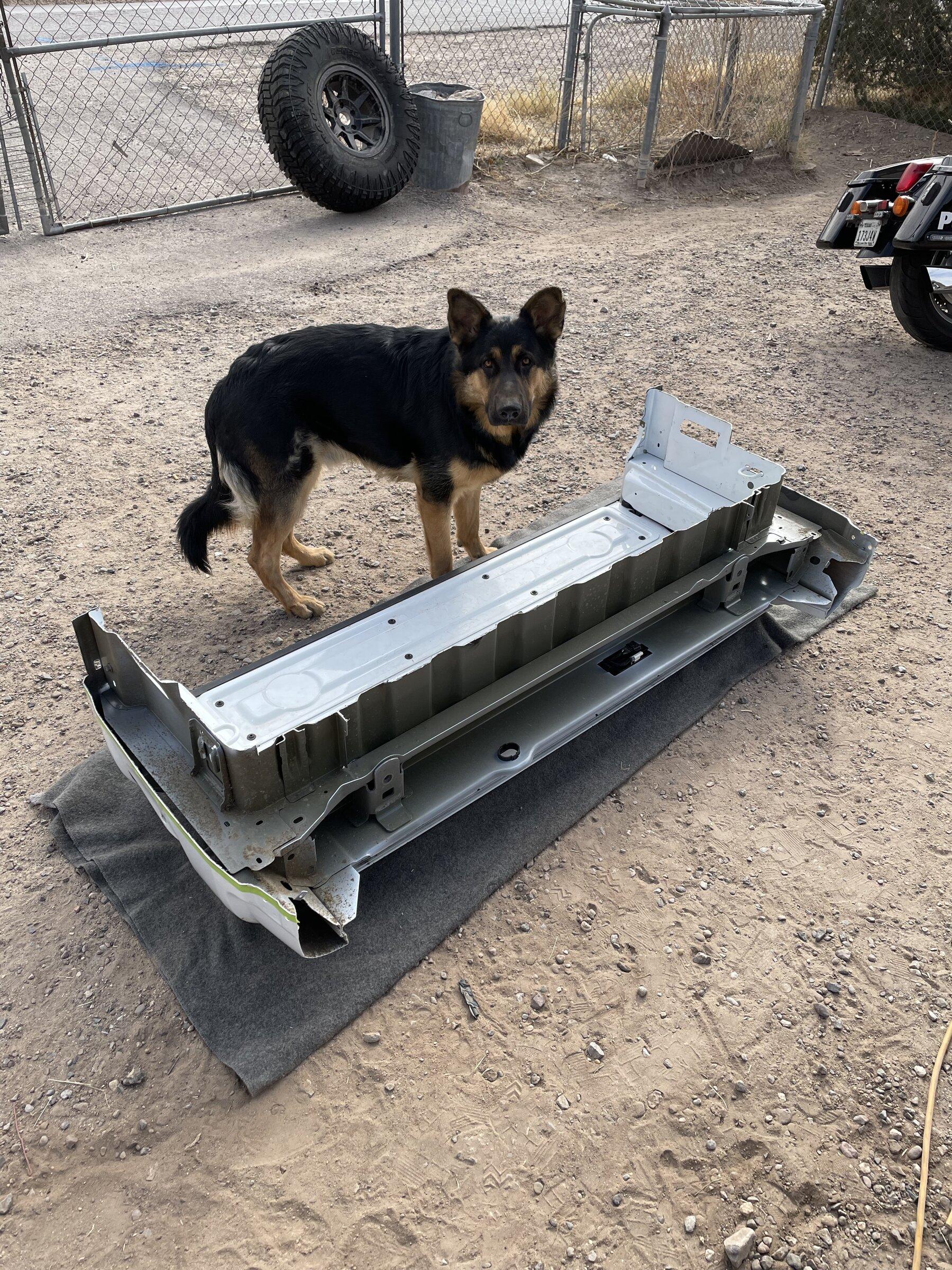

@SigSauerKraut did you do it? I’m getting started this week on mine. If you went for it, any tips?

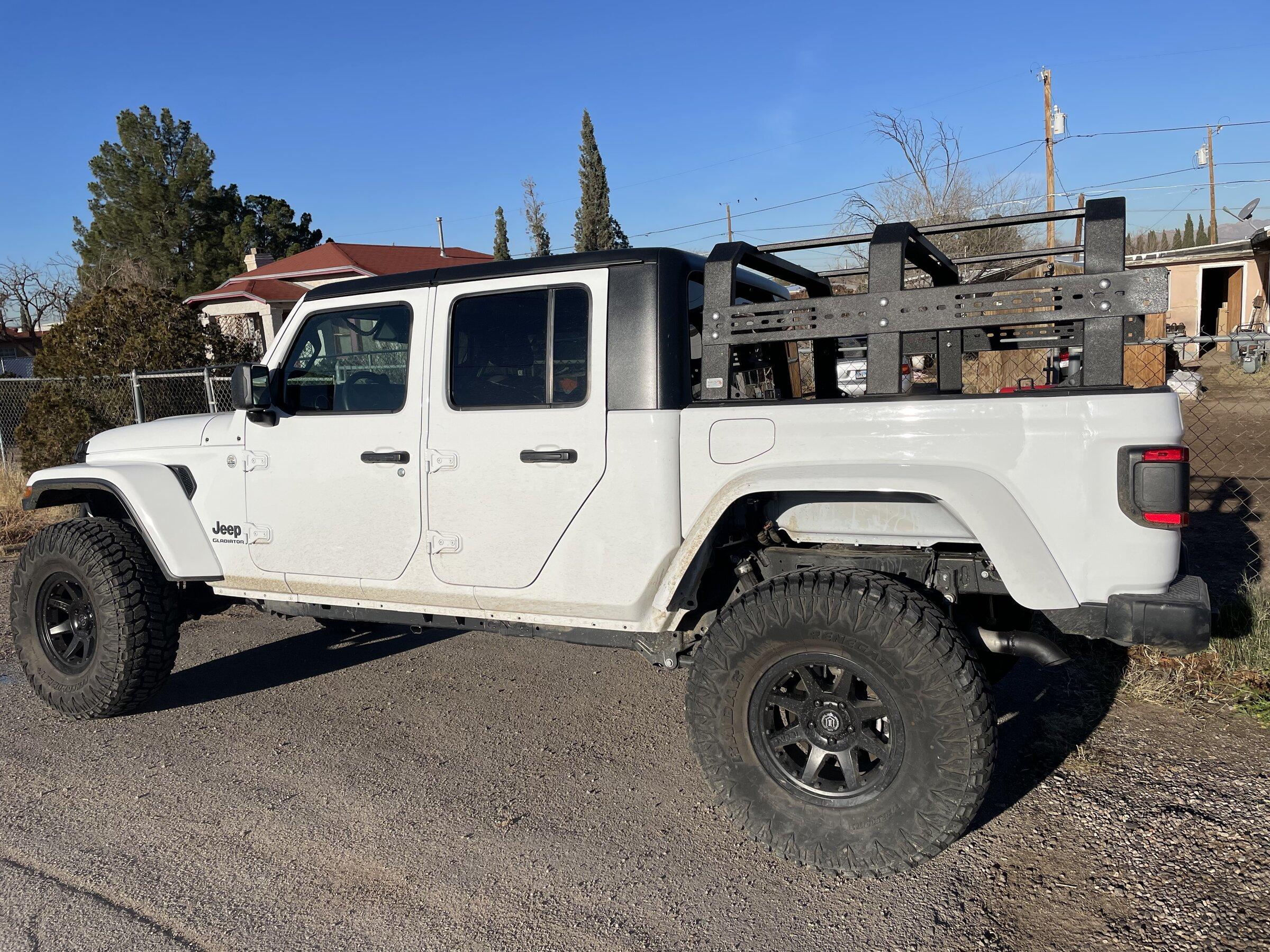

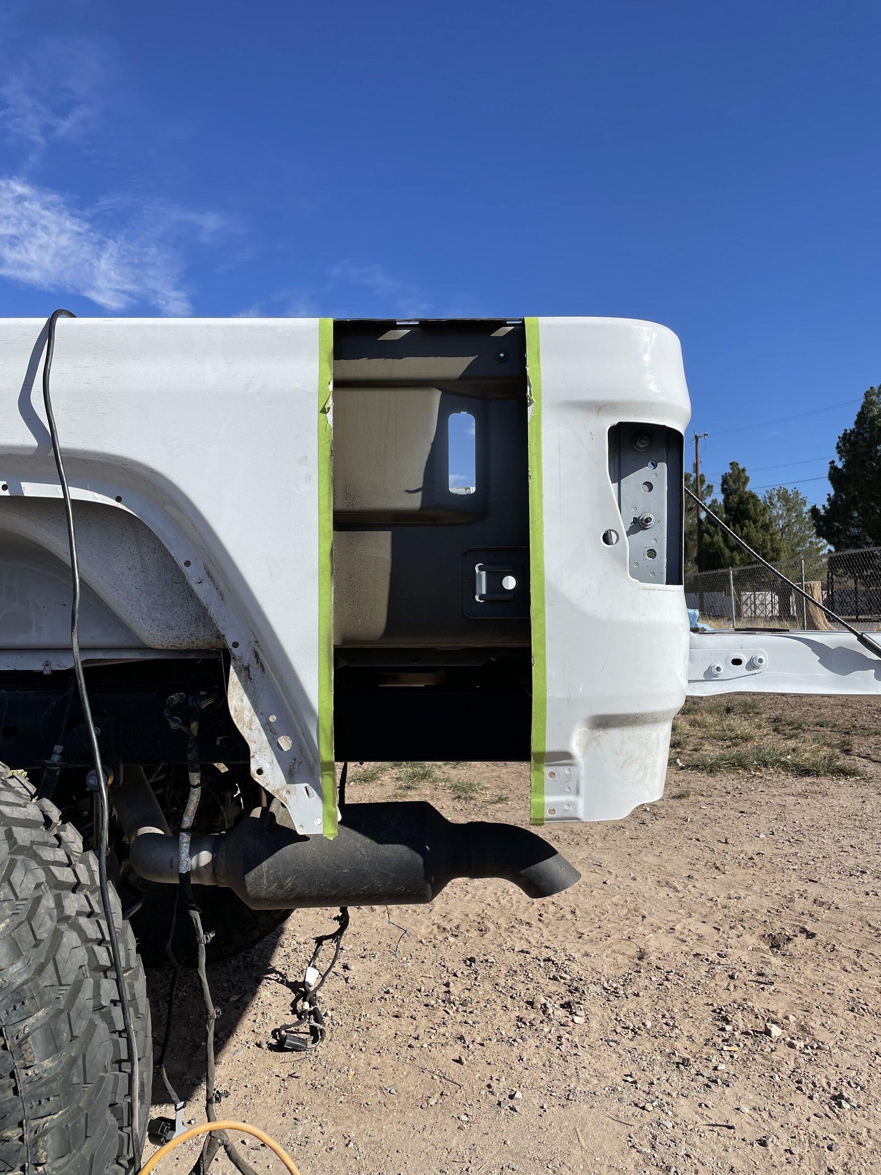

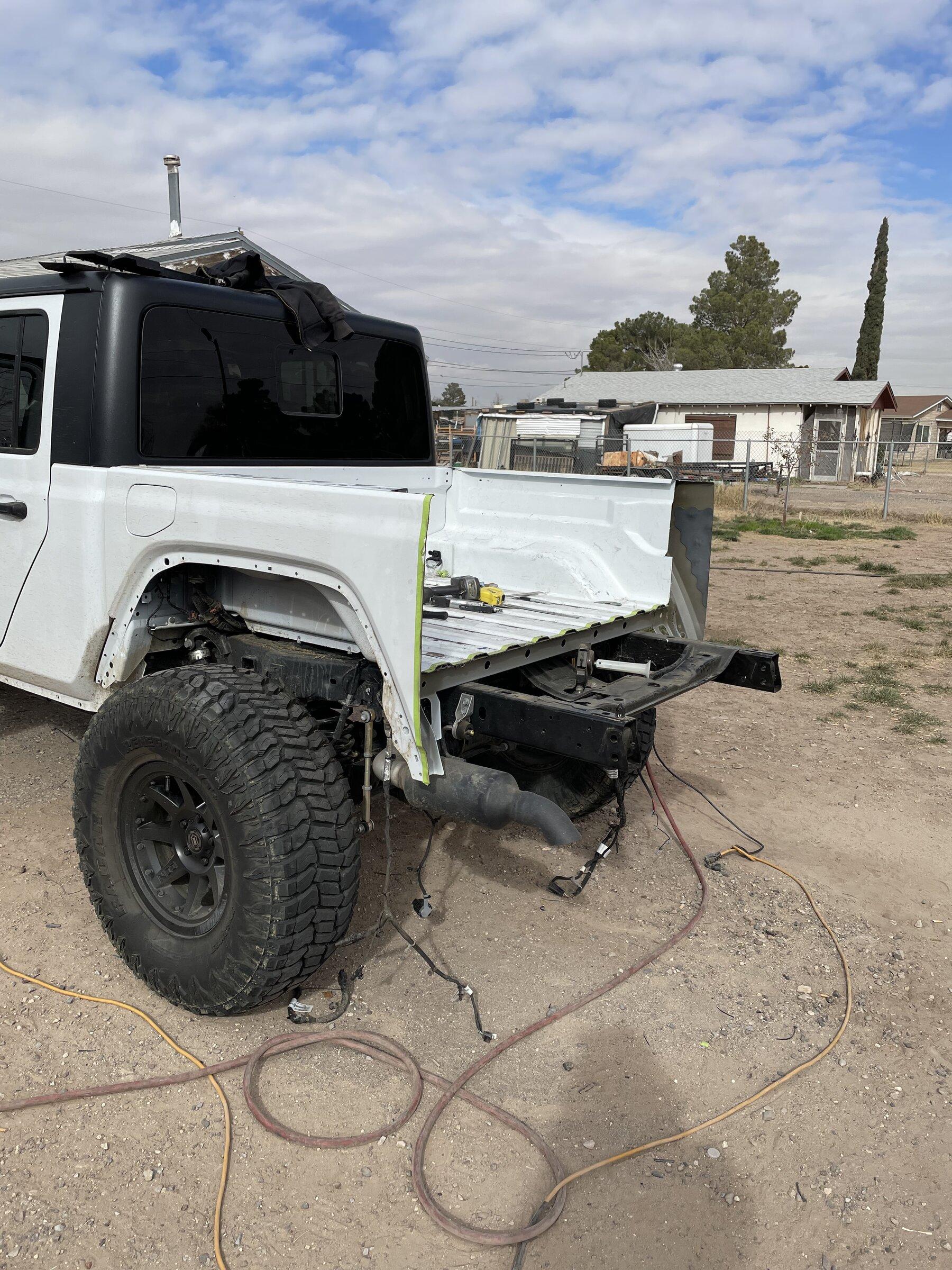

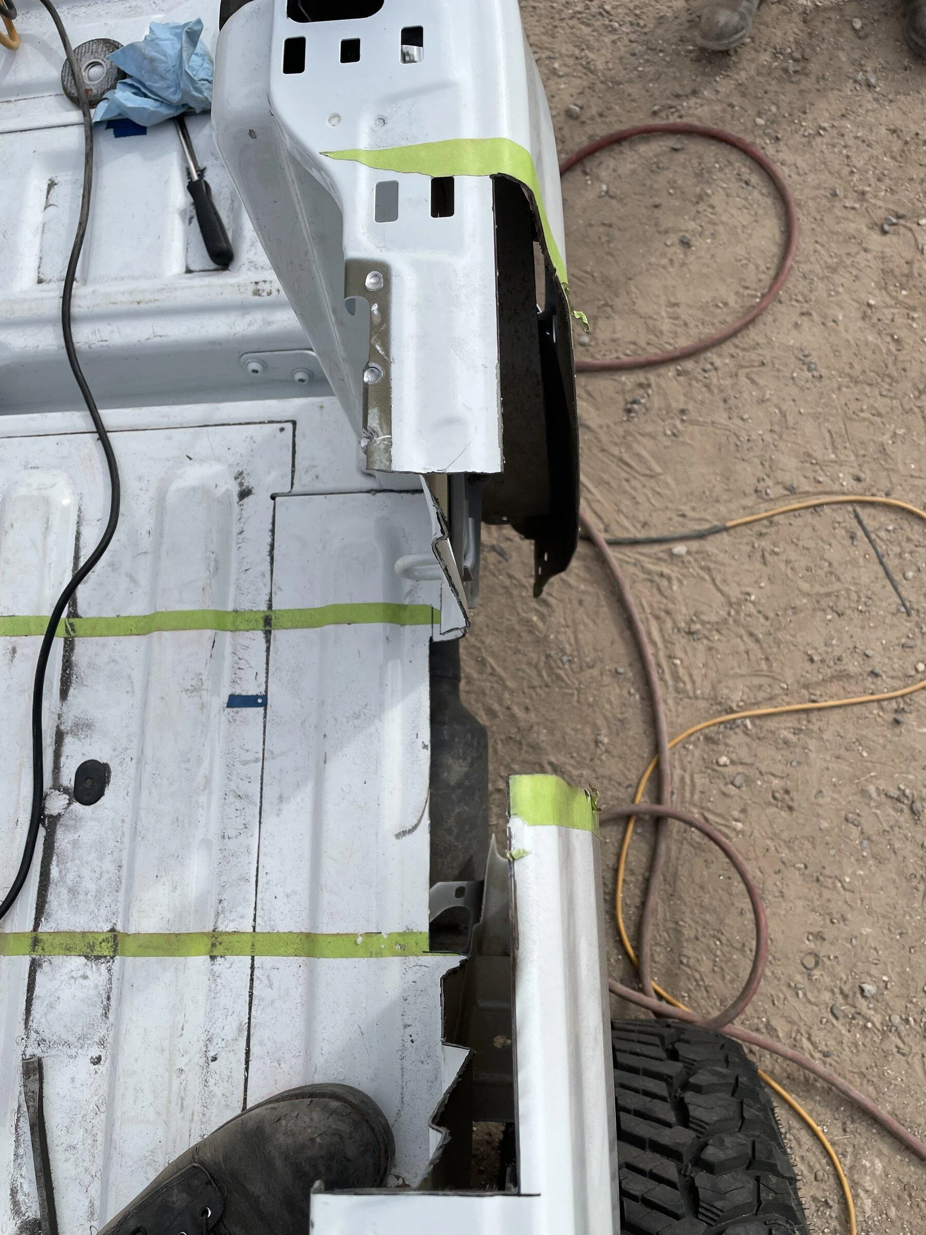

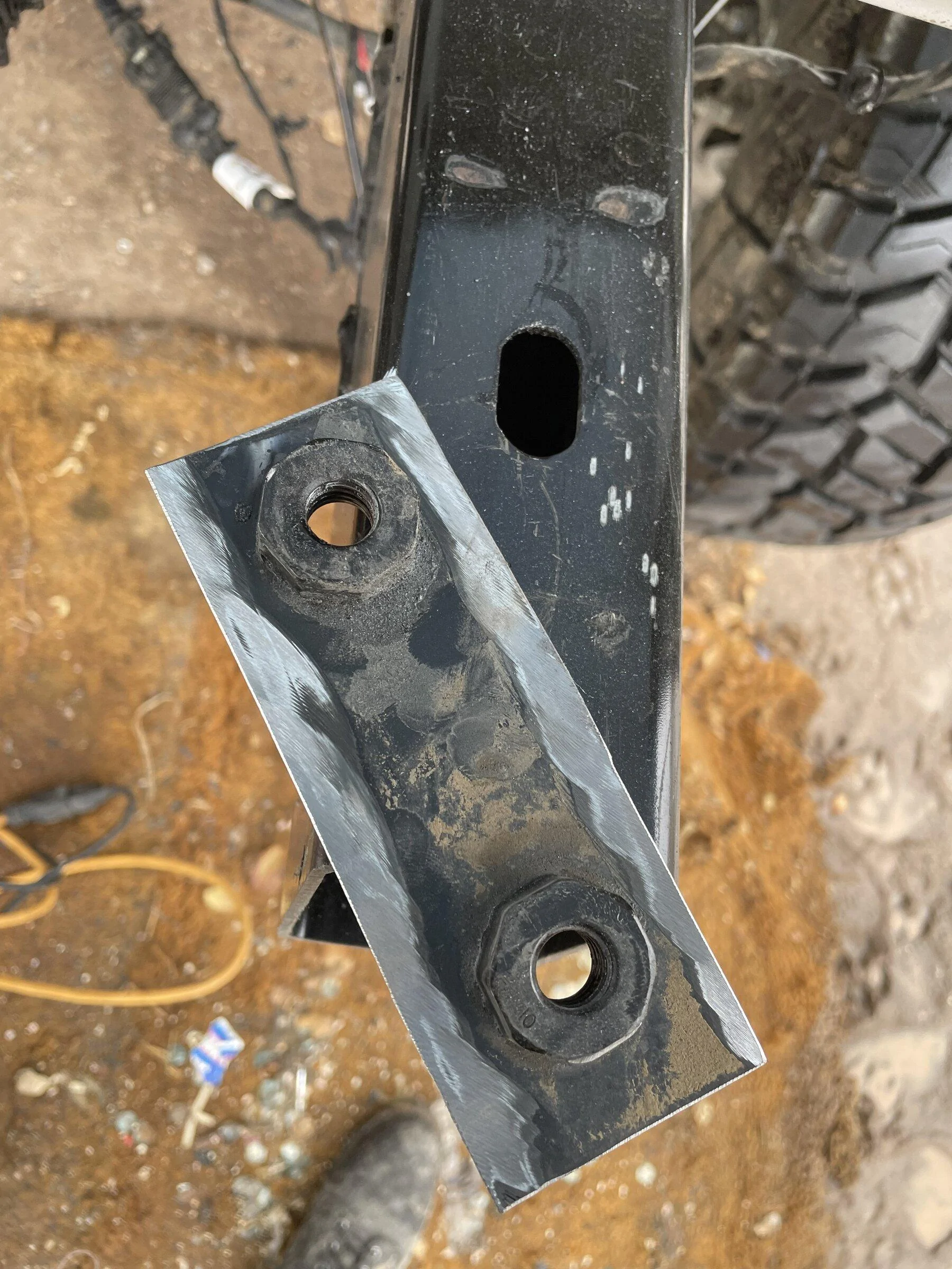

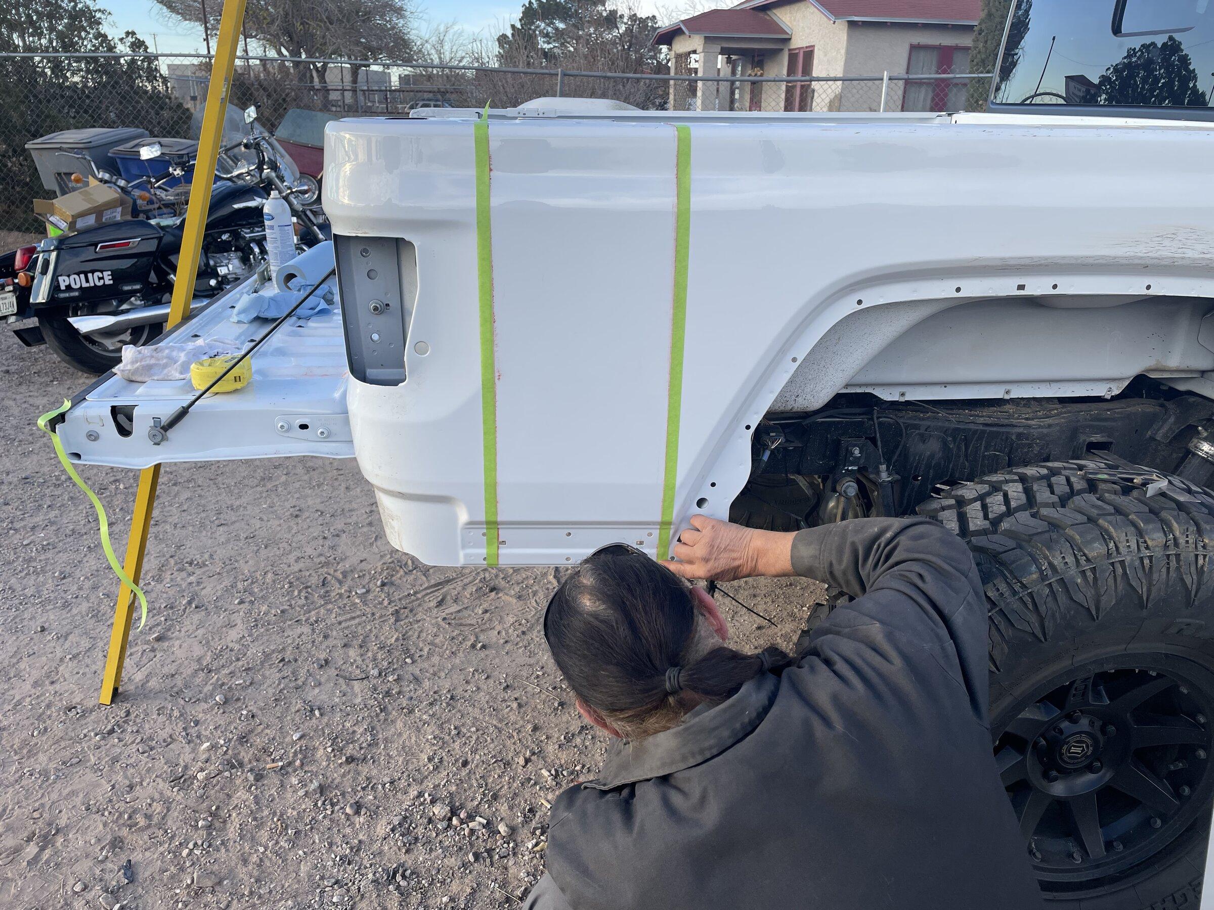

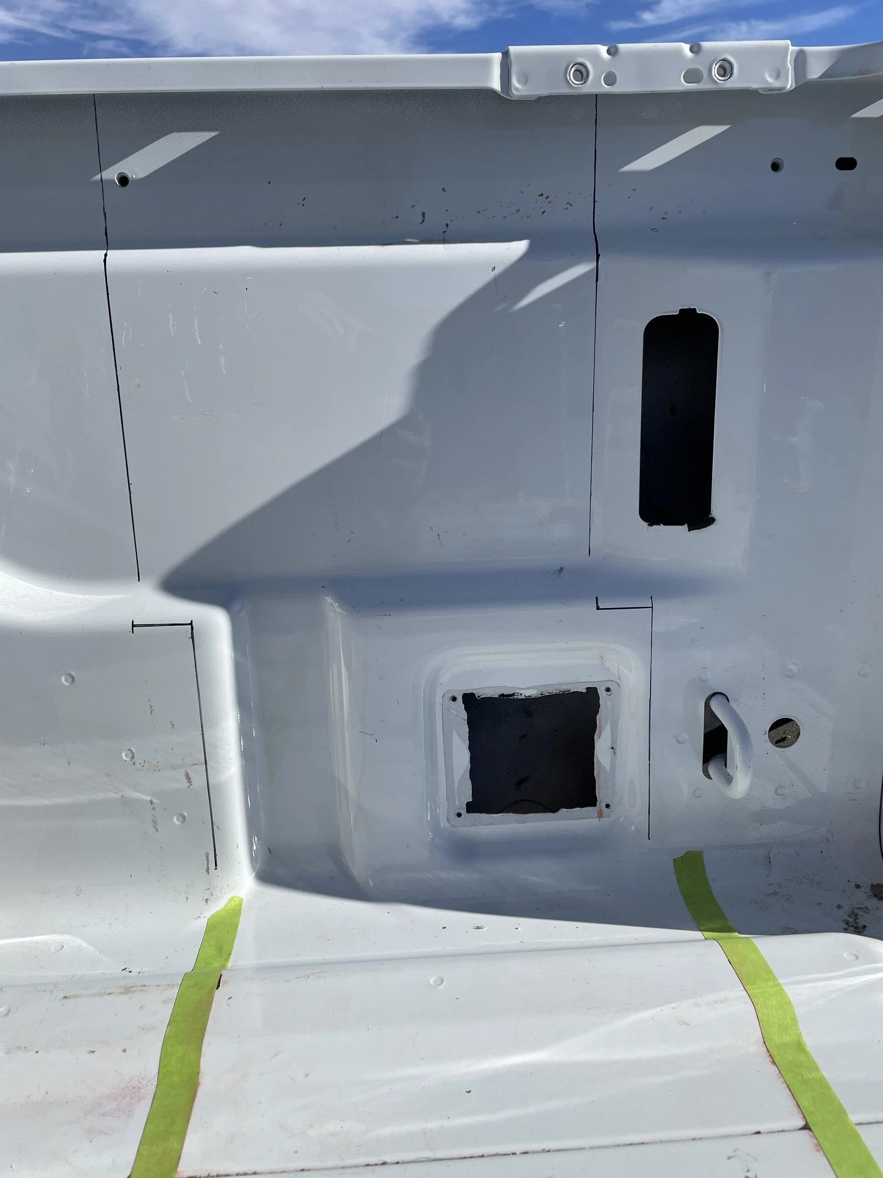

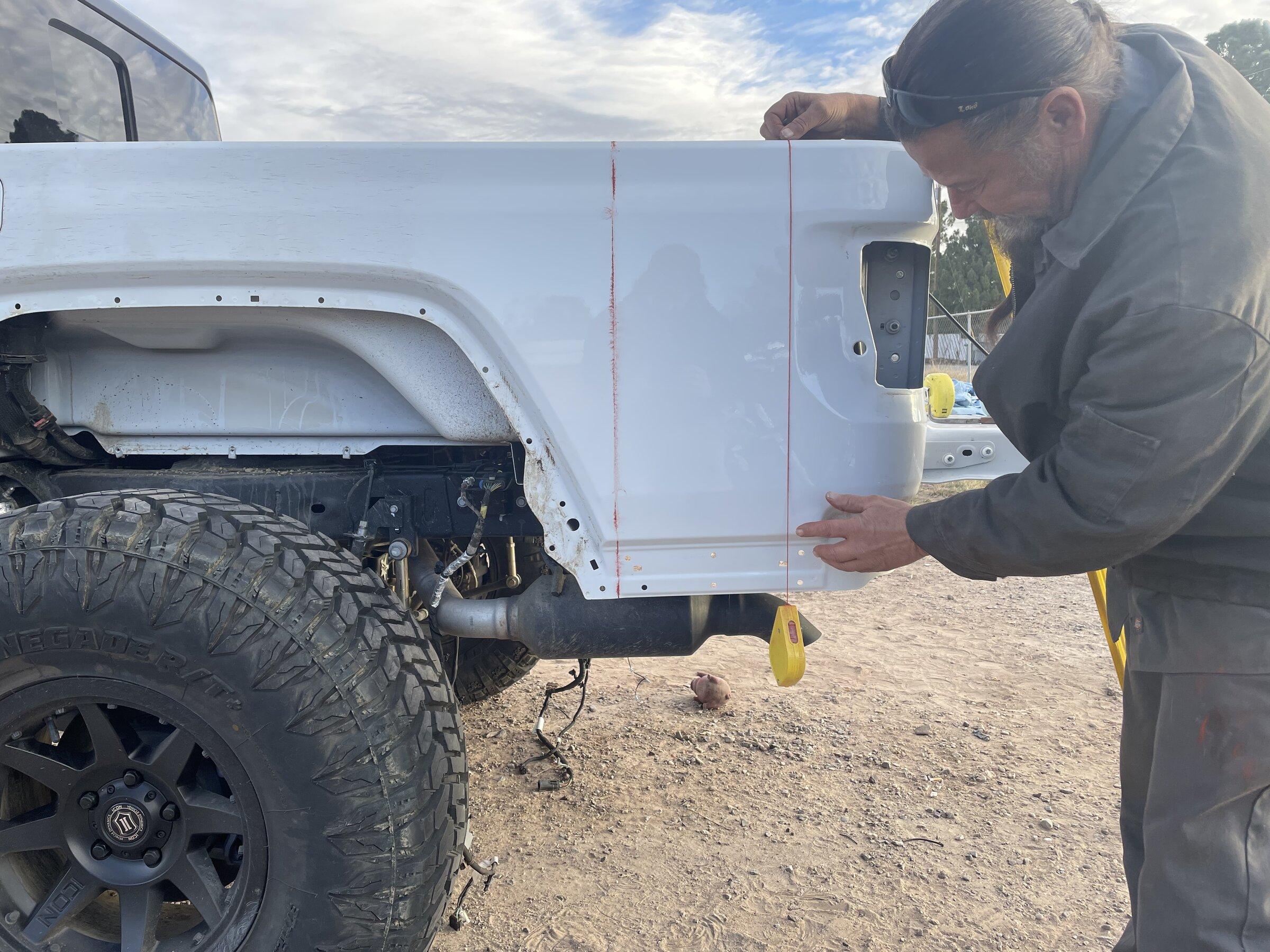

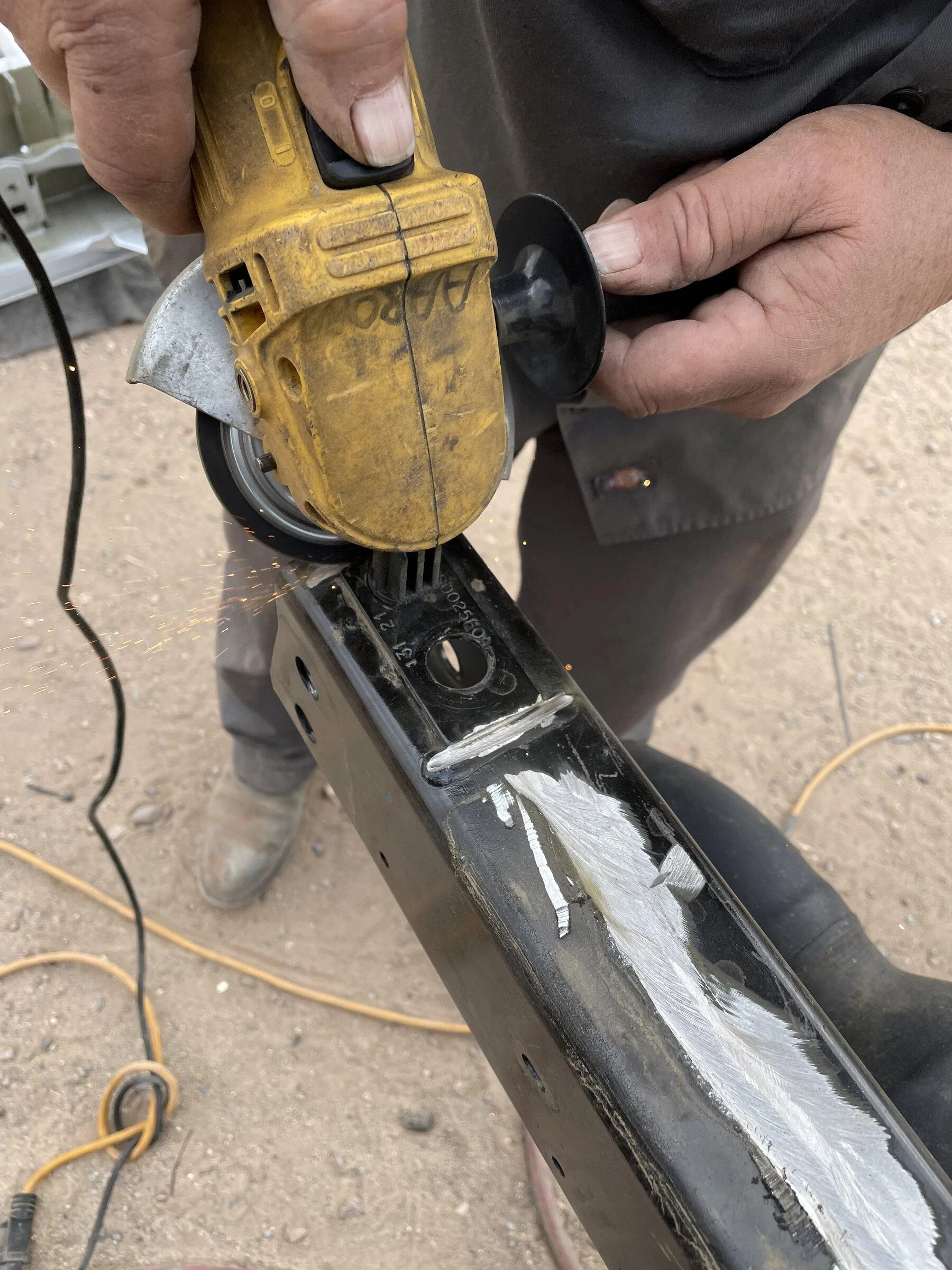

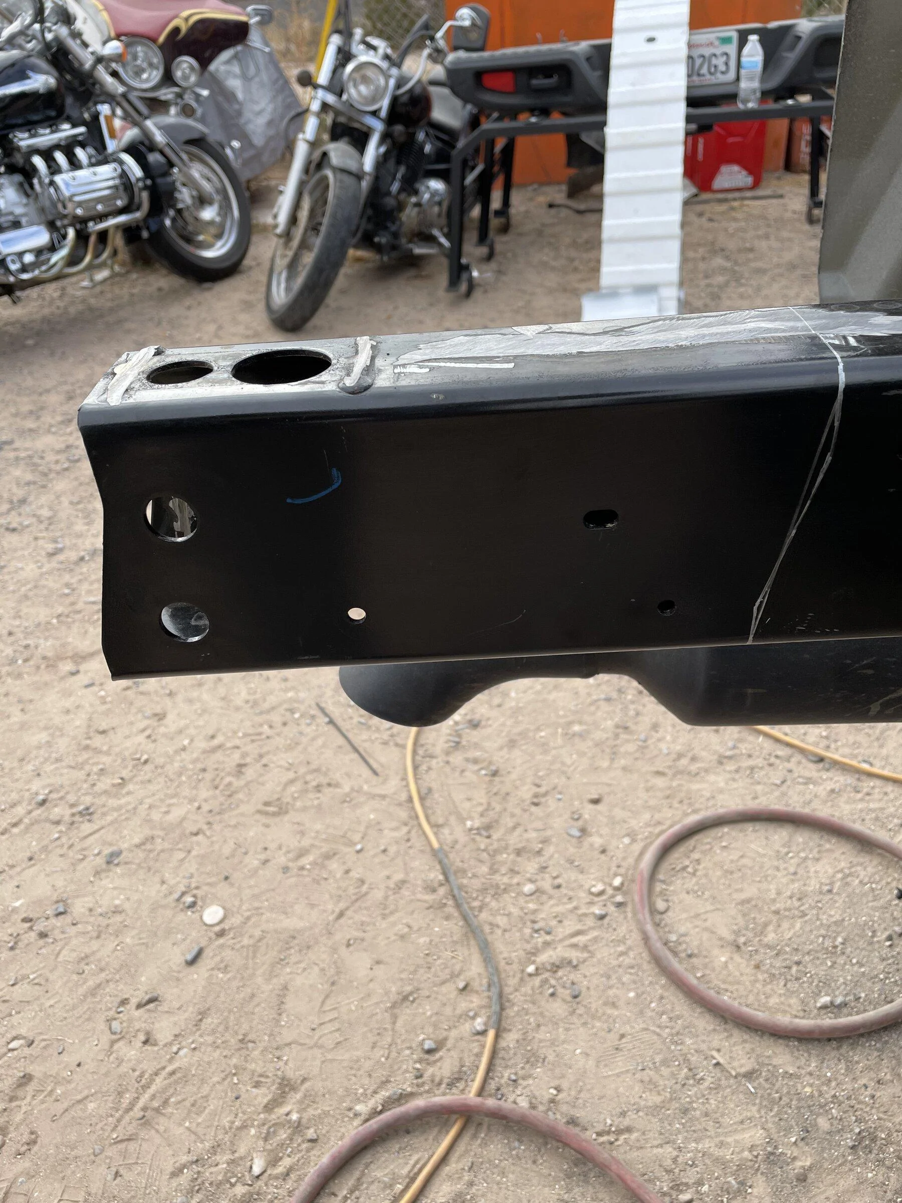

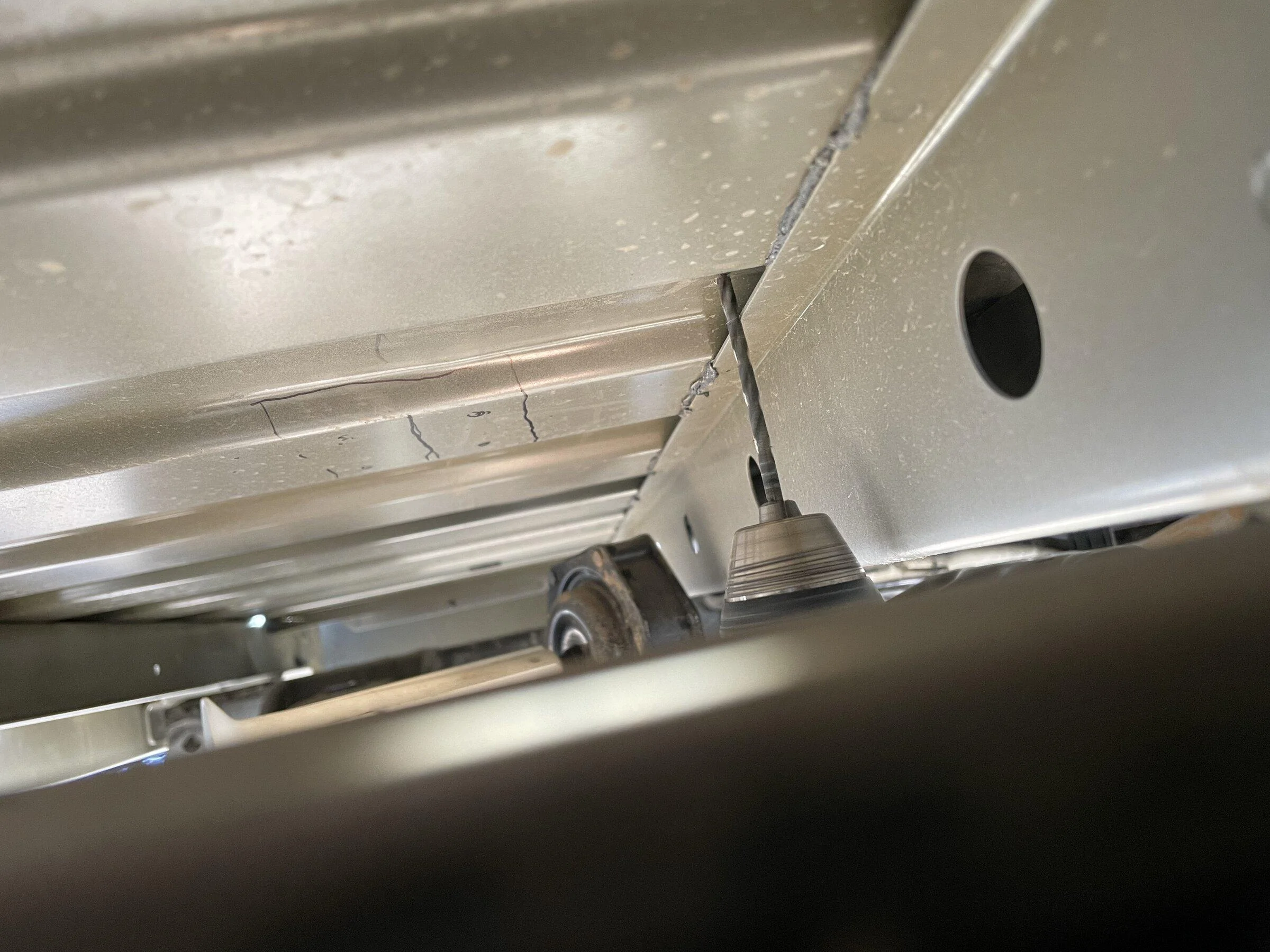

I did. I’m sorry I haven’t posted about it been busy and currently on an off-roading trip from west to east coast (wheeling John Bull Trail today).

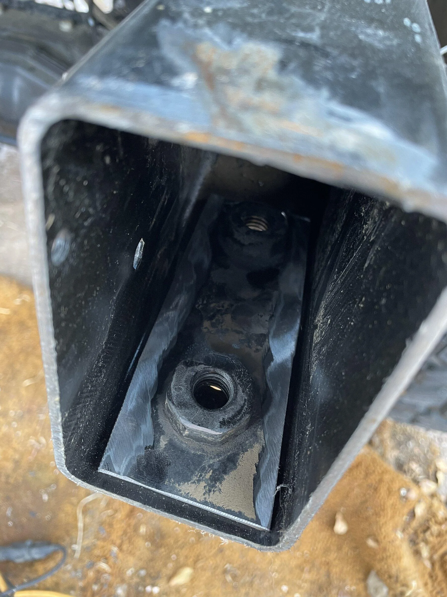

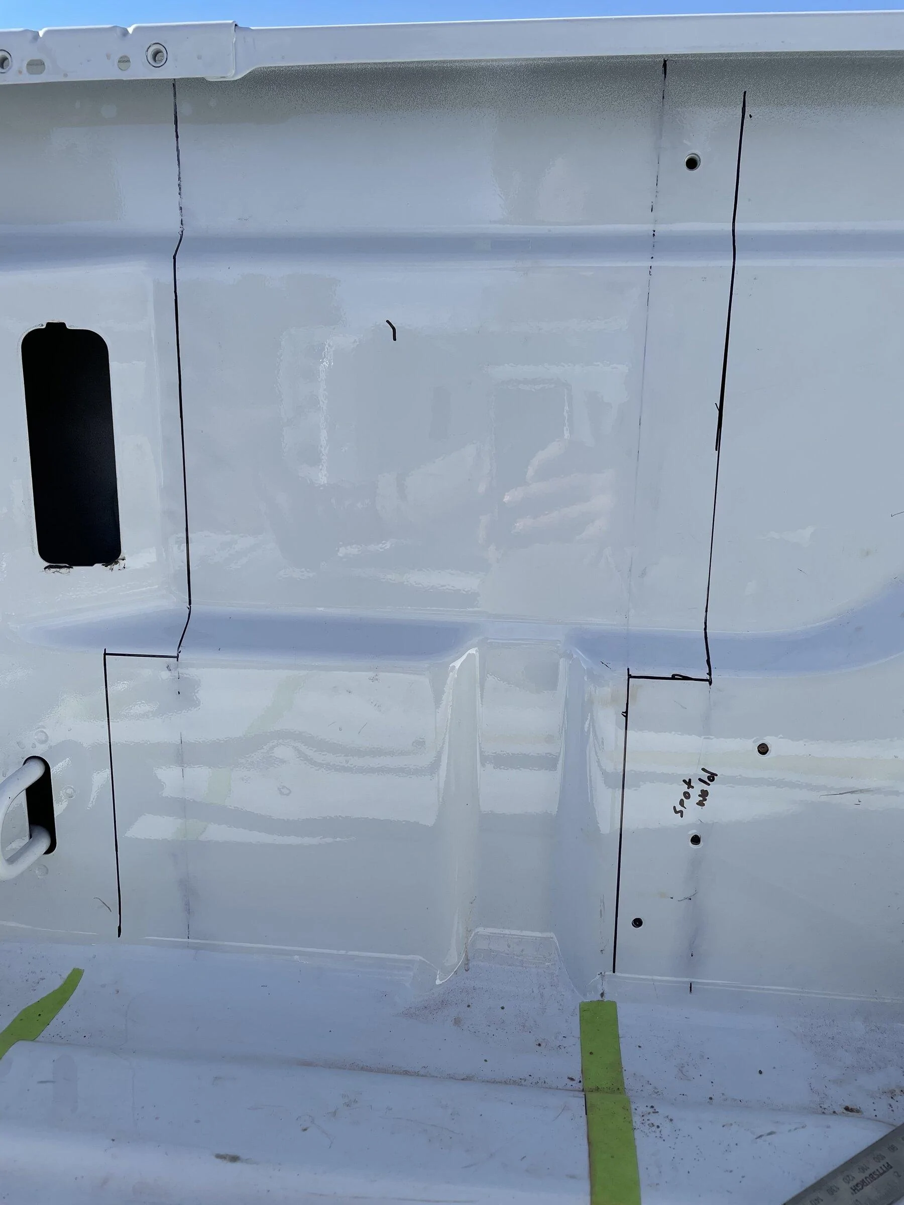

Most of it was pretty straight-forward. Making sure you get straight lines is kinda tough but a chalk line and plumb bob worked really well for us.

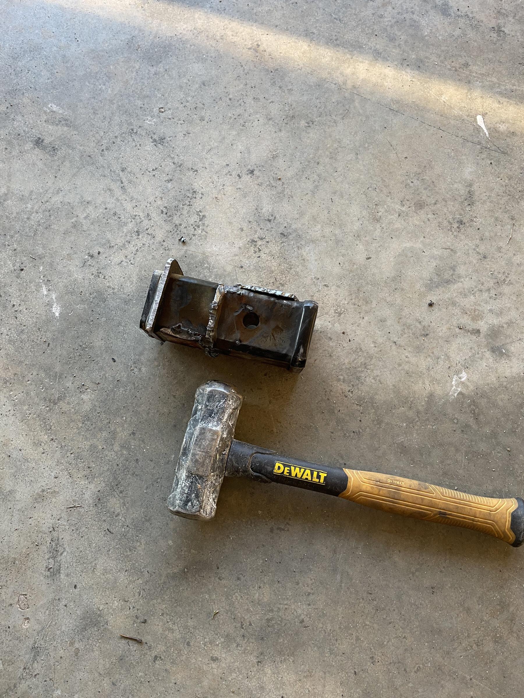

We made a template for the bolt holes on the back of the frame, cut it back 10” and tattered the holes over. For the nuts that are welded into the bottom of the frame we chopped out a rectangle around them that’s narrow enough to insert into the new end of the frame.
The pictures might be out of order, but I’m posting from my phone and about to hit the trail.
We ran out of time so the metal work is unfinished and you can still see some of the weld. For the welding, I recommend placing a spot weld every 6-8 inches and coming back after it cools to ad another spot next to each and build the bead like that to prevent warping the thin sheet metal. Very low settings on your welder so you don’t blow through it. I had a 110v MIG and had it set to low.

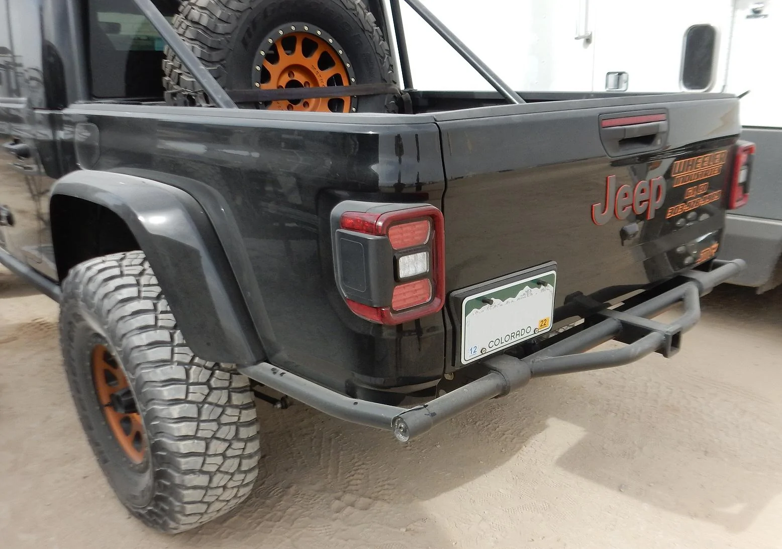

On the banned site, they trimmed the bed along the line at the bottom where the bed sliders go. That’s about a 4” nip/tuck along with a high and tight rear bumper. Doesn’t improve the departure as much as this bob, but does keep the bed volume the same. They have a video of it.
This guy at the King of the Hammers did the same thing on his Mojave. He did an awesome job and I did not realize the bottom 4" was missing until he pointed it out. There is a natural line there that makes that perfect. With the custom bumper he built, he probably gained a total of 8 inches over the stock set-up and hitch.

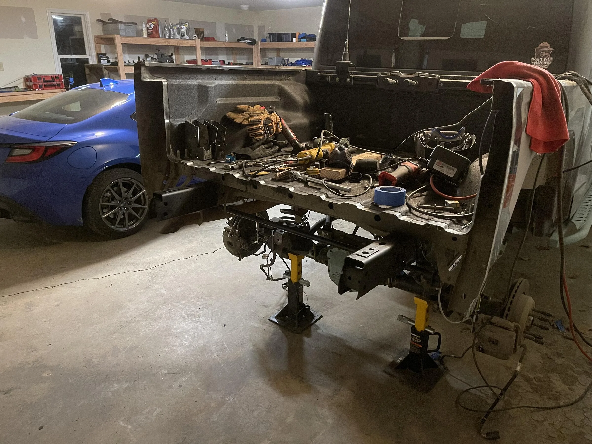

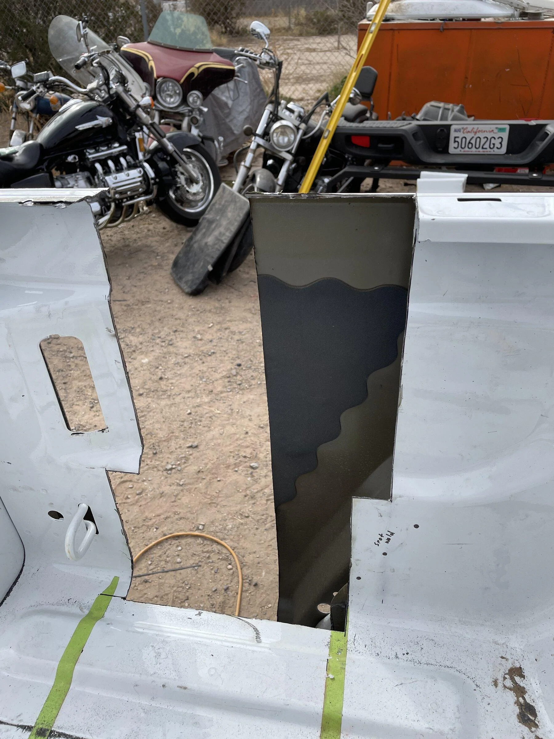

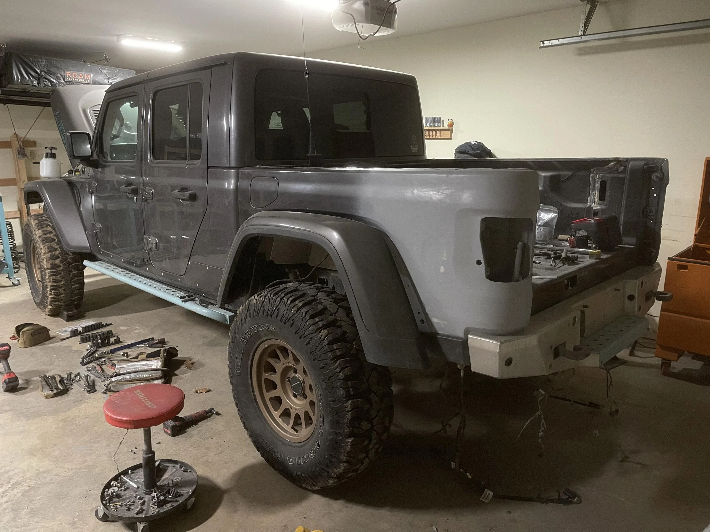

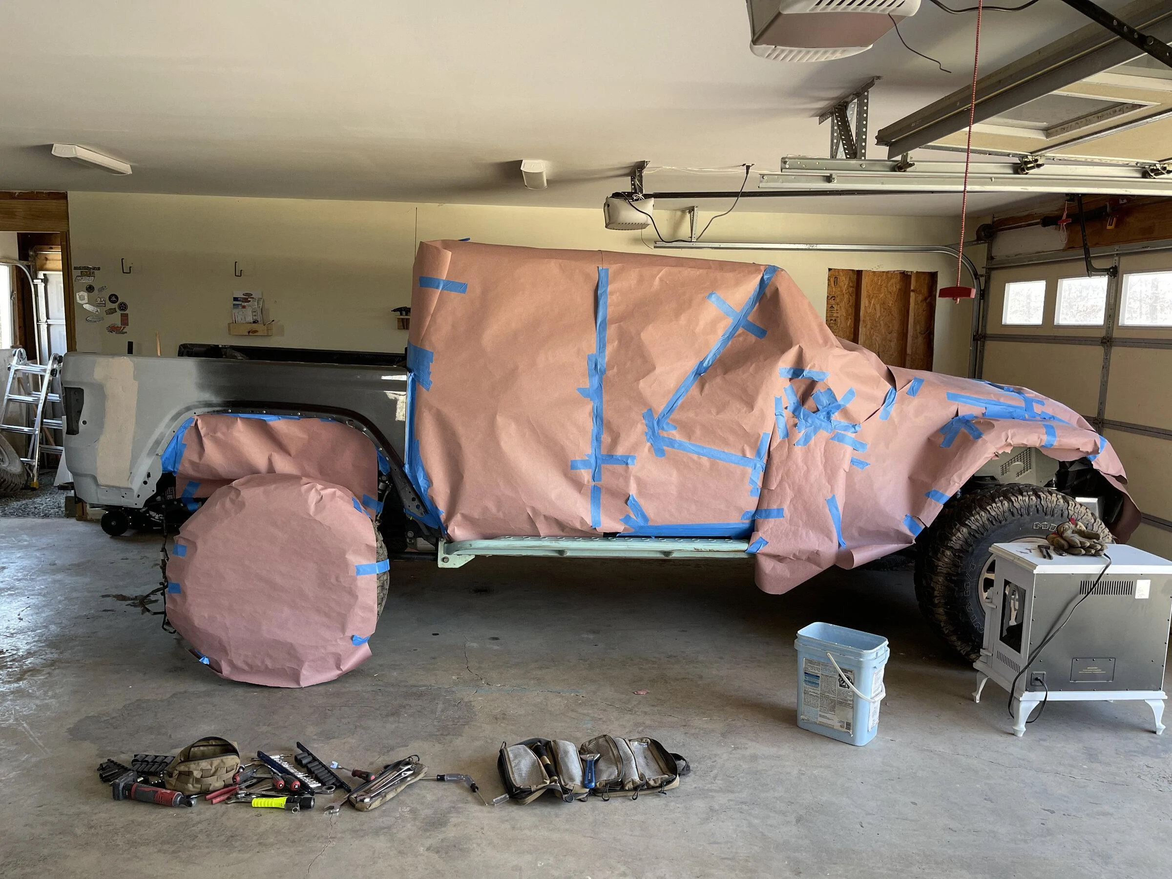

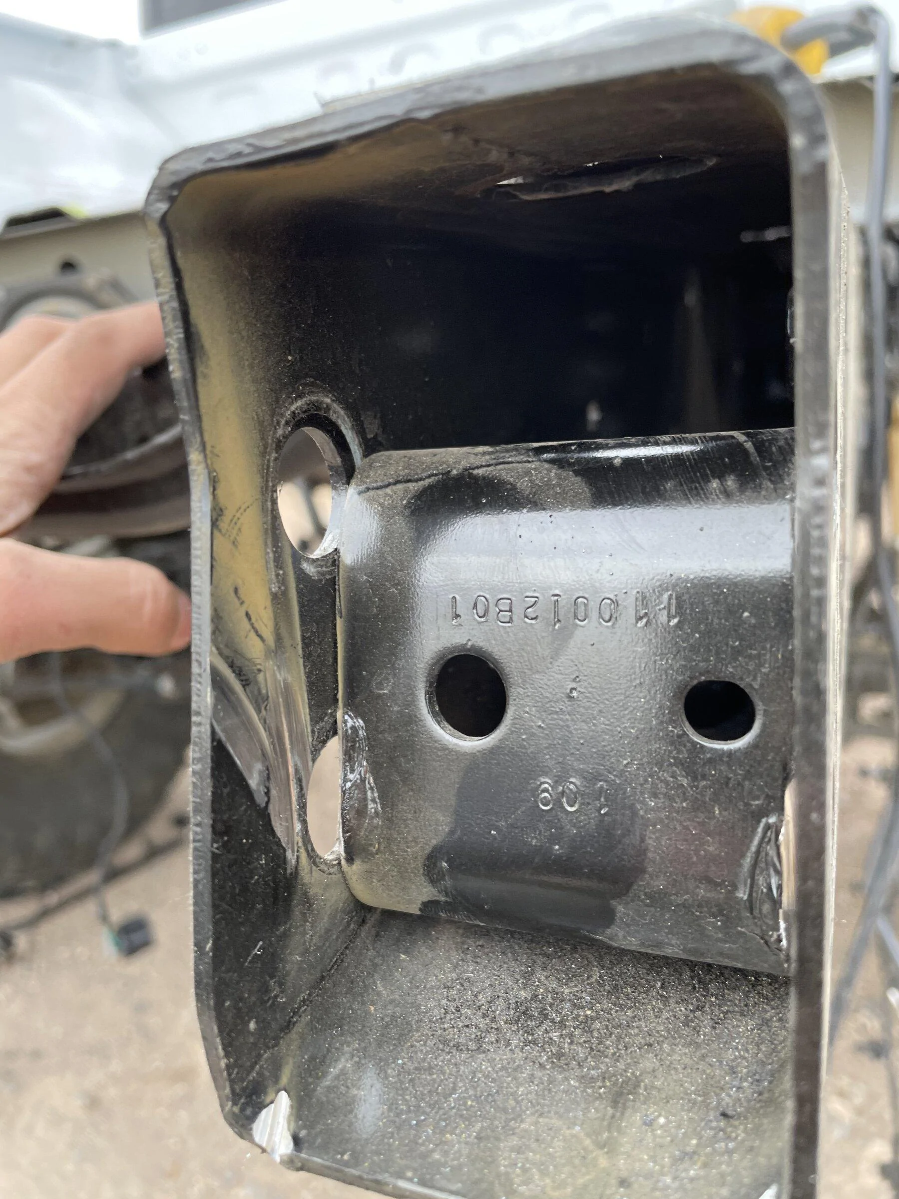

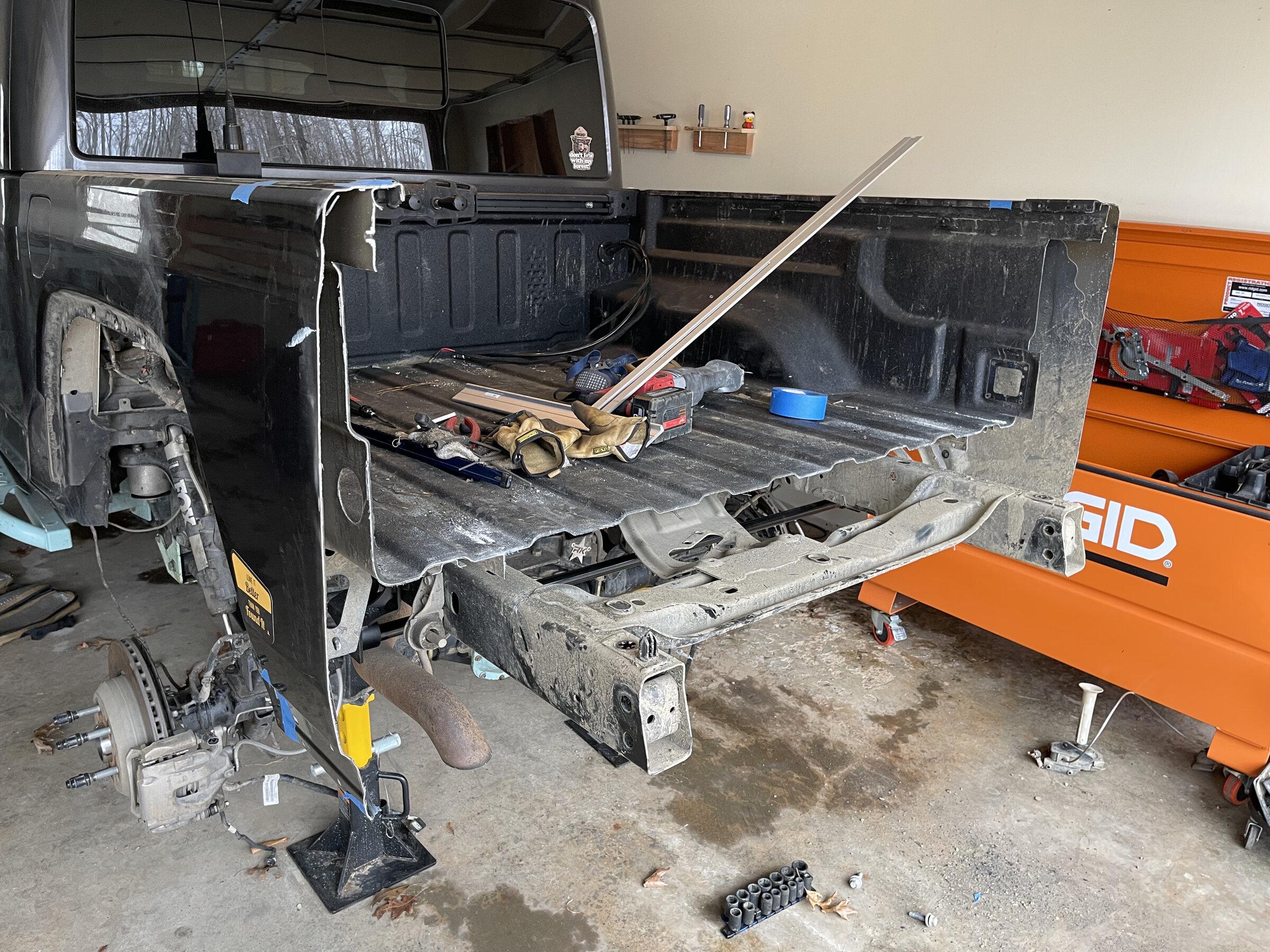

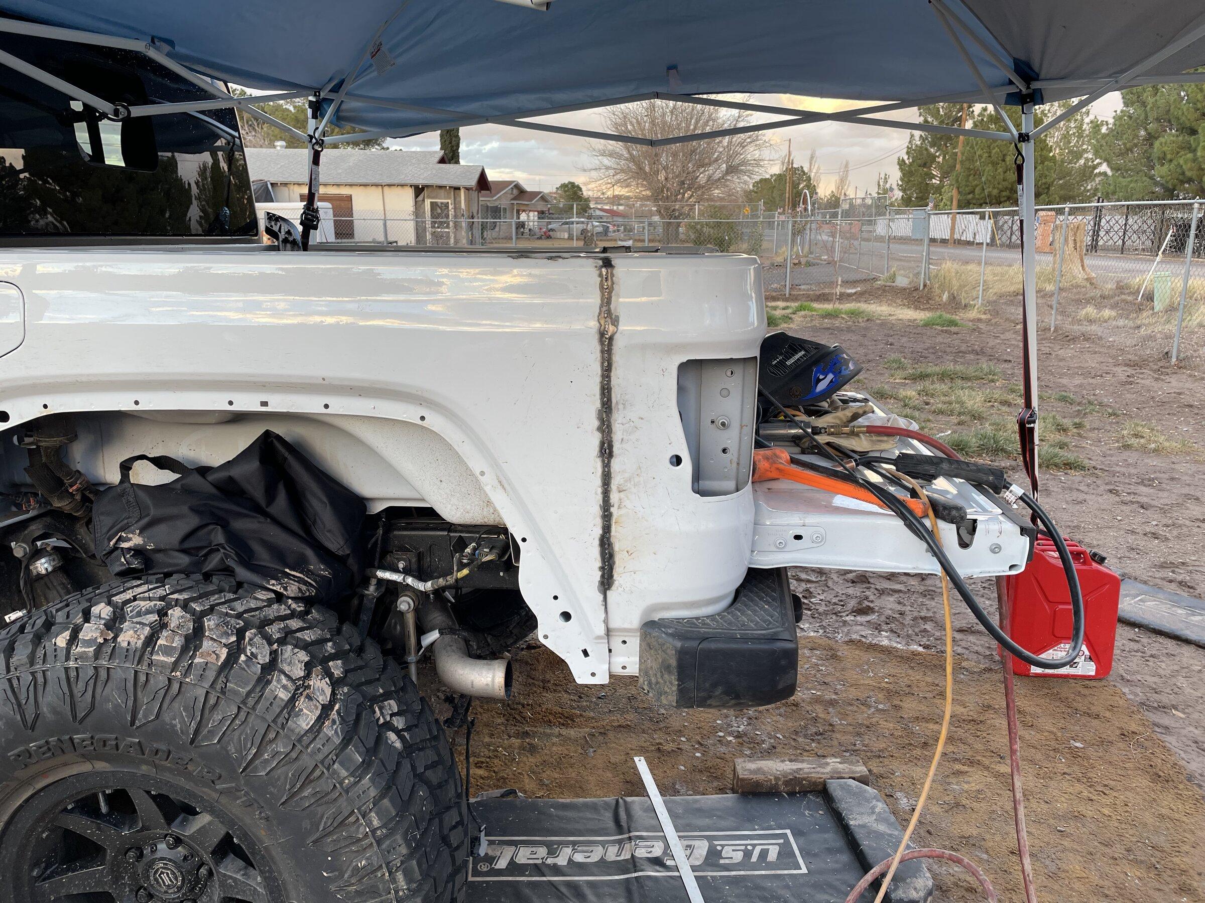

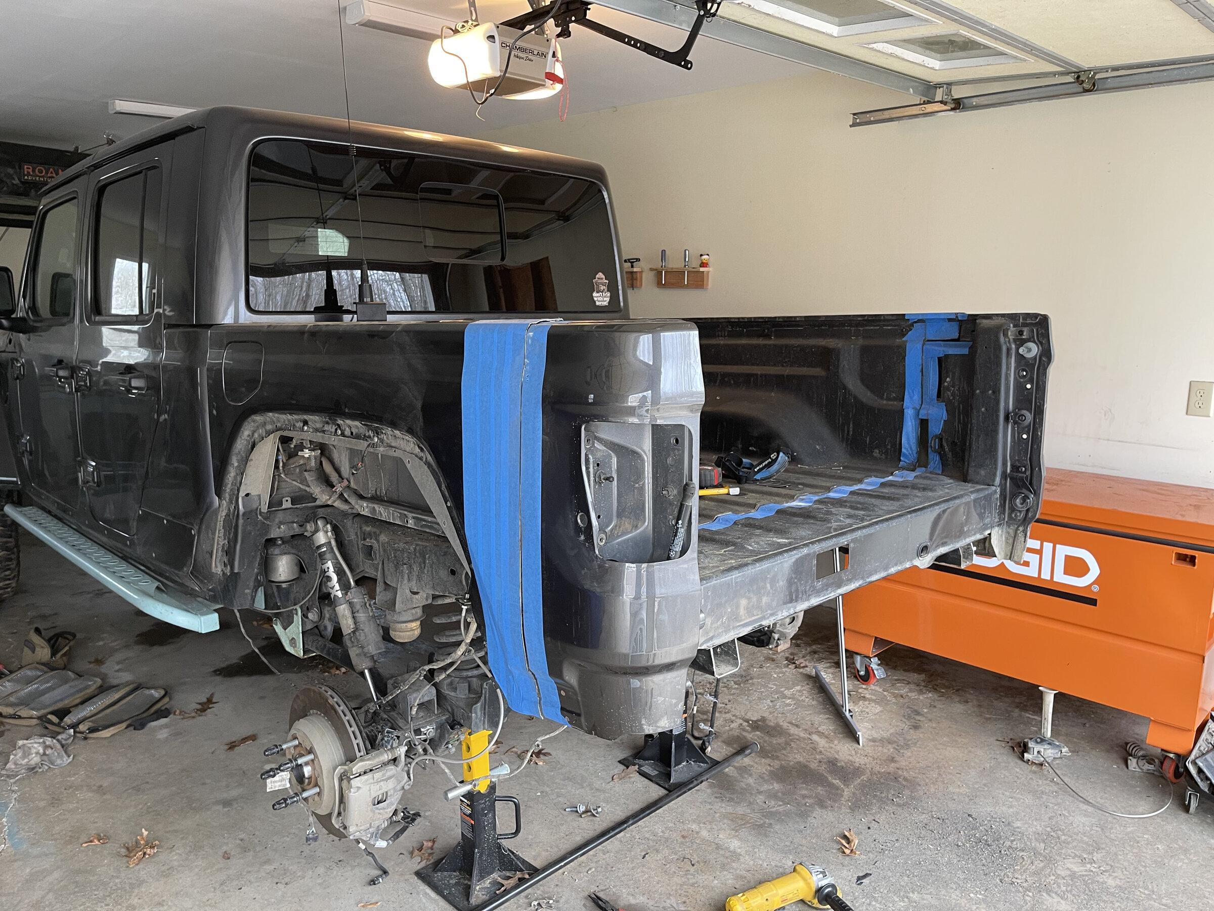

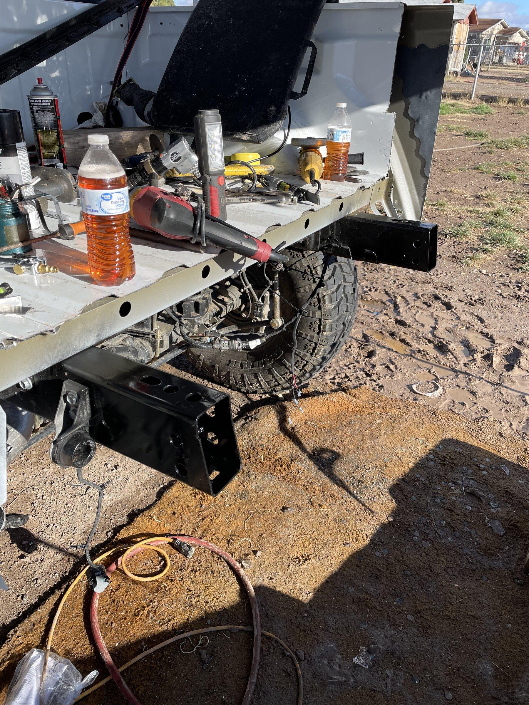

Ok, so update from the weekend. I feel like I got a lot done! I was hoping to be a little further along with the finish work, but its been kinda cold and the bondo has been taking forever to set :/
The biggest challenge I ran into was keeping the heat down for the butt welds. I tried to get fancy and it still didn't help enough to get by without bondo :/
My brilliant attempt was to do normal welds (TIG around 30-35 amps) where the metal is stronger and plastic would hide any imperfects at the top of the bed and under that plastic guard near the bumper. Then, for the rest I used silicon bronze filler at around 25 amps. In the end, the metal still deformed slightly, so I applied the bondo to make it smooth.
Note: I found that whatever material is stuck to the inside of the body metal easily starts on fire and really quickly ruins welds, so had to clean that up.
Also, I cut the hitch off the truck to gain a couple more inches, but kept the tow bar since thats where the hooks are mounted (for now). That hitch was a massive pain to get off. Ended up using the plasma cutter and sledge hammer on it. Carnage shown below for your enjoyment.
The truck is currently wrapped and waiting for the bondo to cure.

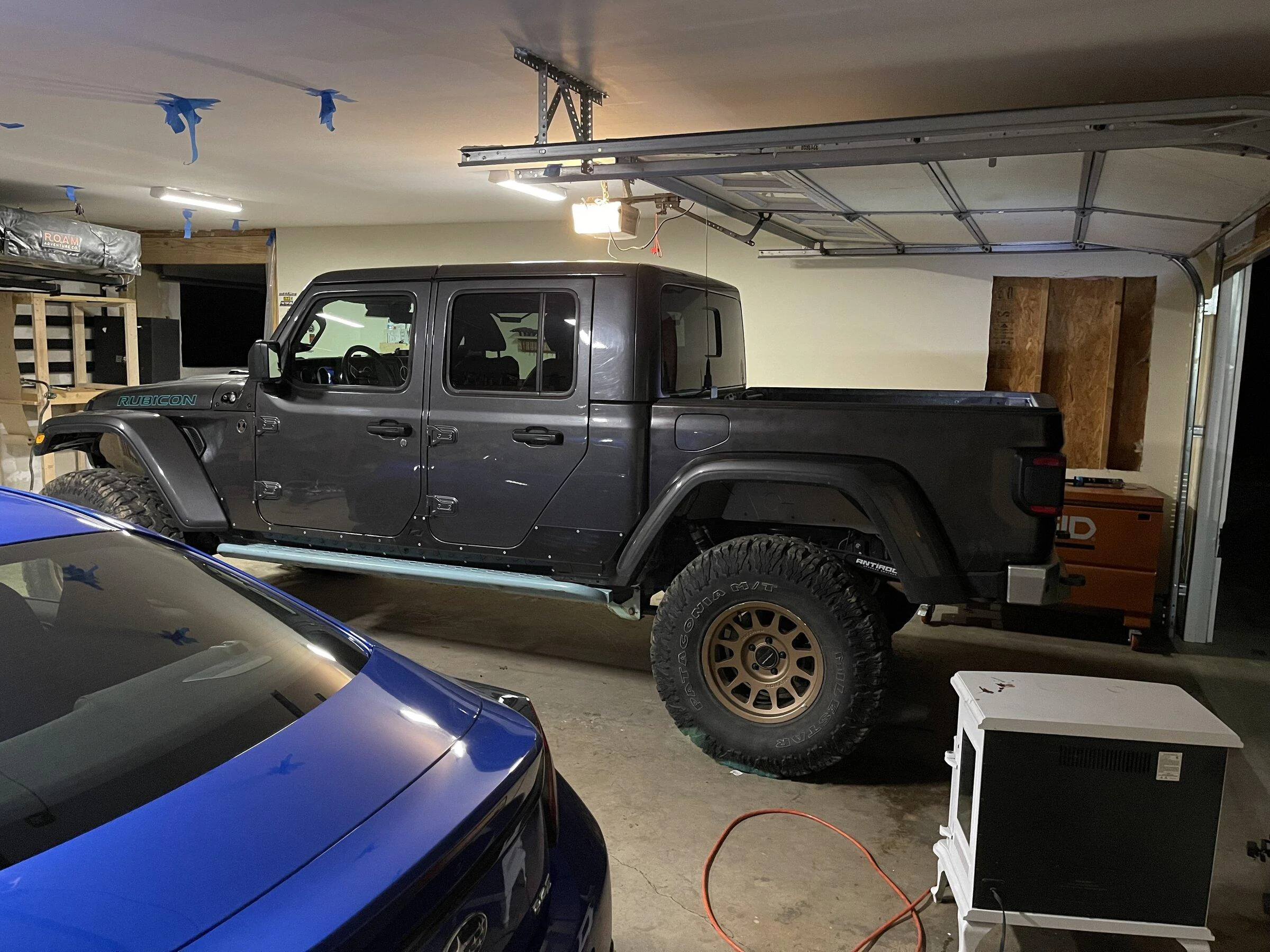

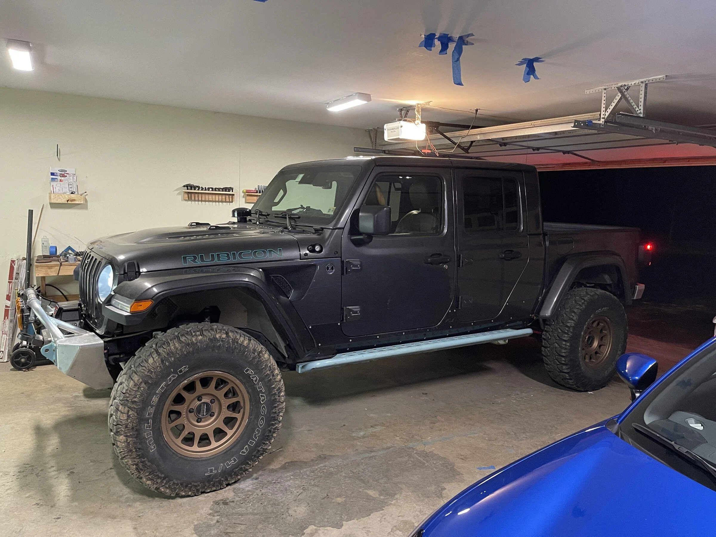

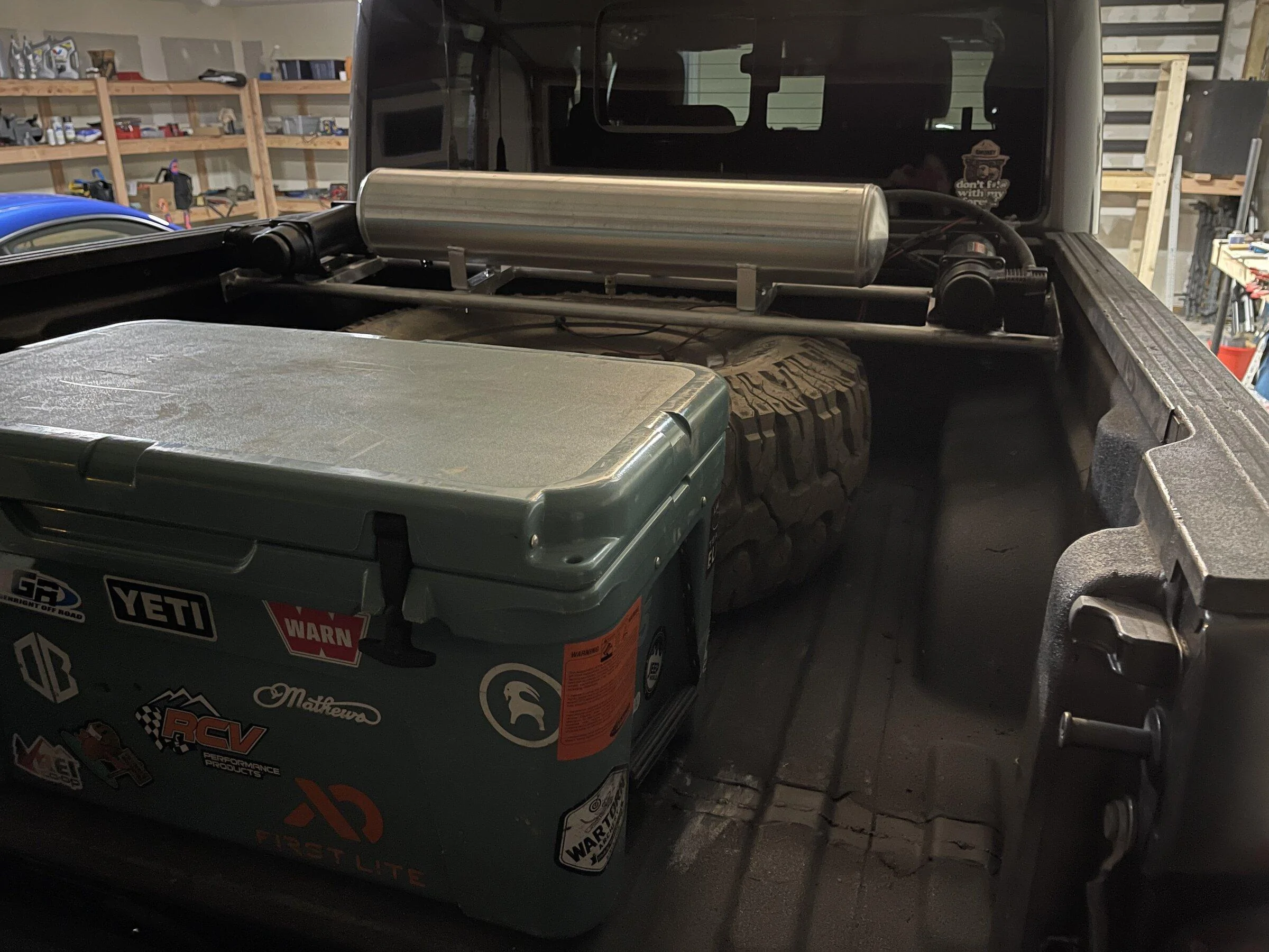

Ok, calling this modification done for now. Thanks again @SigSauerKraut for going first!
While finishing, biggest suggestion is to buy more paint than you think you need. 4 cans wasn’t enough to do the bed well. I’ve got 10 more on the way so I can mask it up and hit it again later this month, but I’m feeling good about the rest of the project.
Test fit my spare and cooler in there tonight, everything worked out as planned! Should be able to fit those plus my compressors and a few misc tools in the bed, which is exactly what I wanted.
