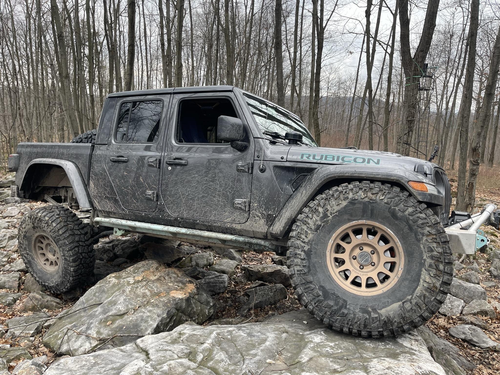

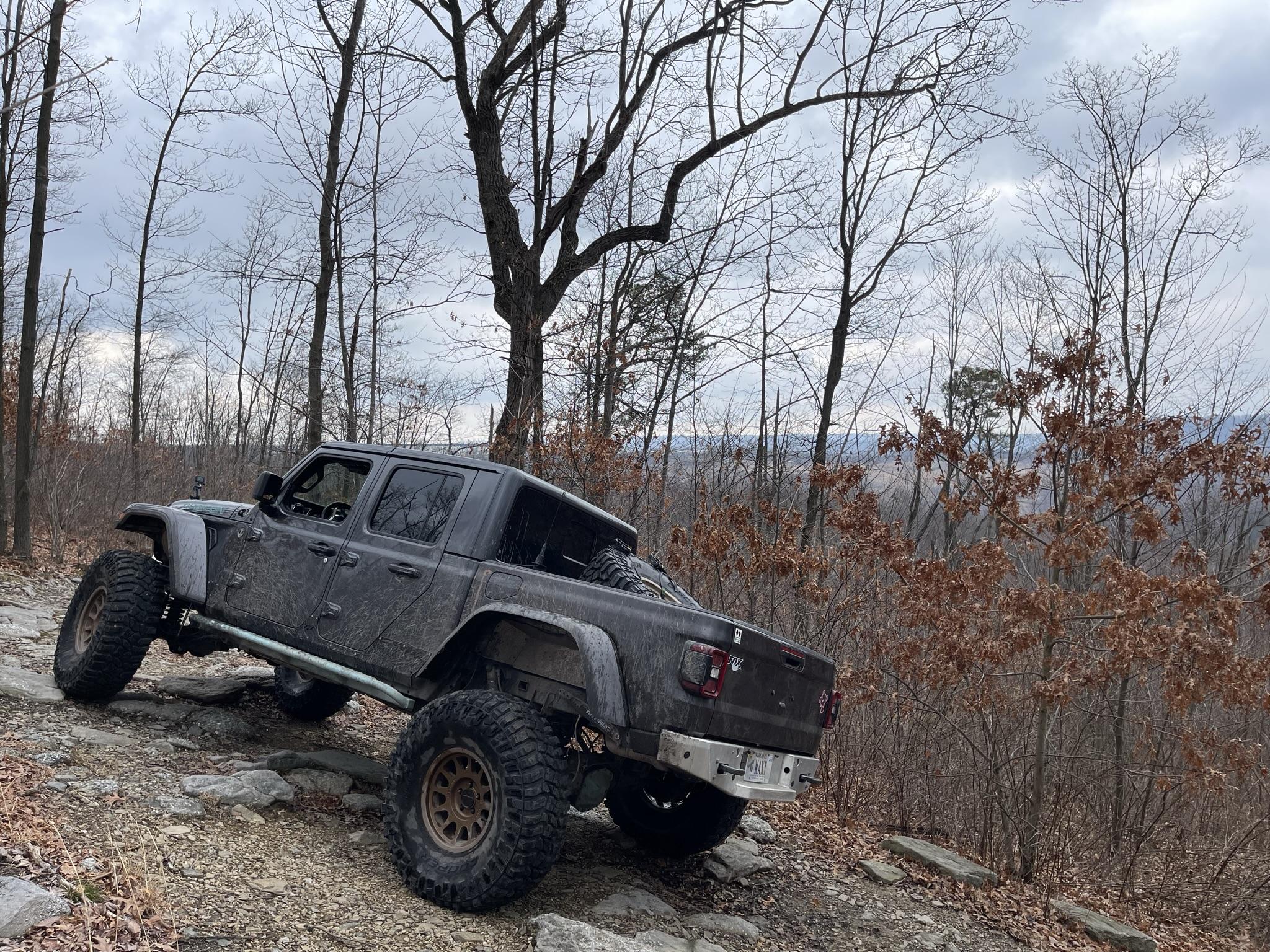

I saw their post this morning and thought: Hey! Mine is better than the Jeep prototype! Go me! At least I have a tailgate and can fit a cooler back there with my spare and air compressor :)

Looks great! For serious off roaders this is the way to go with the Gladiator.

Cool story. Love your edgy take?. My wheeling has been a lot more enjoyable without dragging my rear end on every obstacle I come down.
The break over angle has not been a huge problem but I’ll admit that having to readjust on tight turns is cumbersome. Planning ahead and knowing your wheel base is key and usually gets me through without having to back it up a tad. It’s when I focus too hard on the next step and am not paying attention to what comes after when I set myself up poorly for the next obstacle. I’m sure that goes for most rigs though.
On the trip I’m currently taking from coast to coast, having the room in the bed is absolutely necessary when my two dogs dominate most of the cab space. A 4dr JL super short bed simply would not suffice let alone a 2dr. The Gladiator with the bobbed bed is exactly the amount of Jeep that I need and want.
Thanks for pissing in my cheerios, ??!
Thanks for the write up on the bed chop. I see the bed chop becoming a common modification for the Gladiator crowd. You pioneering and documenting your bed chop mod will help many of us in the Gladiator world get started in making the Gladiator a much more off road capable Jeep. Hope you had a great trip!

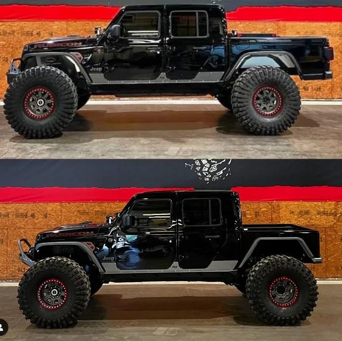

I stumbled across this on Instagram. Motobilt is now making a complete bobbed bed (46" long) for the Gladiator.
Jeep Gladiator Bed Chop??!!! bob1
Jeep Gladiator Bed Chop??!!! bob2
Jeep Gladiator Bed Chop??!!! bob3
Jeep Gladiator Bed Chop??!!! bob4
all photos property of Motobilt.
FLUndertaker
Aug 9, 2020
83
1,049
1,244
Oklahoma
2020 Jeep Gladiator Sport, 1986 Jeep CJ7
Disclaimer - no relationship with the company

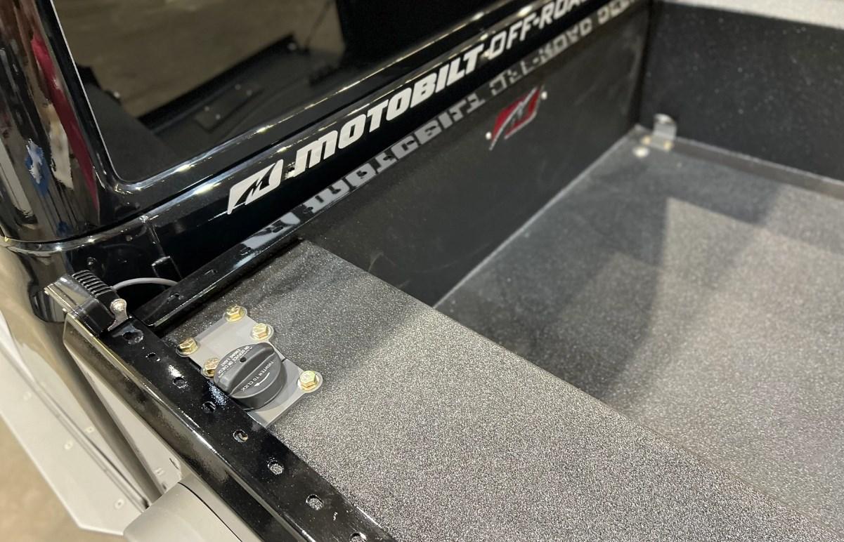

If this is available to purchase now as a bolt on versus one off all custom, I am all over it. I wonder how much of the frame gets lopped off and besides losing the spare tire space what else needs to be relocated? I don’t see a fuel filler on it.
Rockabillyroy
Nov 8, 2020
948
1,010
CA
JT
Think it's on top driver side.

Looks like they made it shorter vertically too. I bet it’s going to look really awkward with the hard top removed as the body lines won’t match up.

$5000 plus tax and freight plus you still need it painted. Easily a $8500-9000 project but very bad ass!

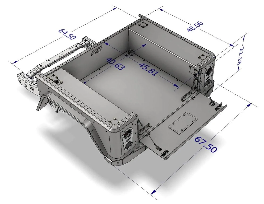

A- I wonder how much of the frame gets lopped off
B- I don’t see a fuel filler on it.
A- According to the webpage HERE "The stock Gladiator frame is trimmed approximately 14-5/8” and the total savings in length is approx 18 inches versus the factory bumper and factory bed."
B-
