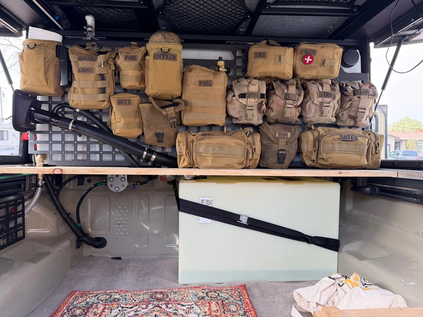

Yeah, exactly. Plumbing ended up being a bit complex as there’s the 1.5” fill tube, a 3/4” fill vent back to the filler neck (the diesel foaming and splashback if you get this wrong is shocking, ask me how I know), a 5/16” vent hose through the bed to the stock tank vent (for pressure relief), and the 5/16” fuel line through the bed to the stock fill line adapter. Sorry for thread derail…

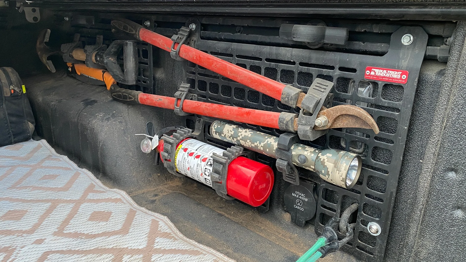

+1 to quick-fists. The hole in the middle of those is small, like only 1/4-20/M6 or so. It’s not hard to enlarge with a drill for a sturdier bolt if needed

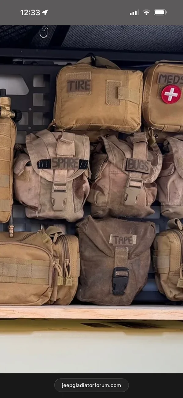

Zip ties and small straps from whatever came with them. I always have extra zip ties and something to cut with in my gear.
