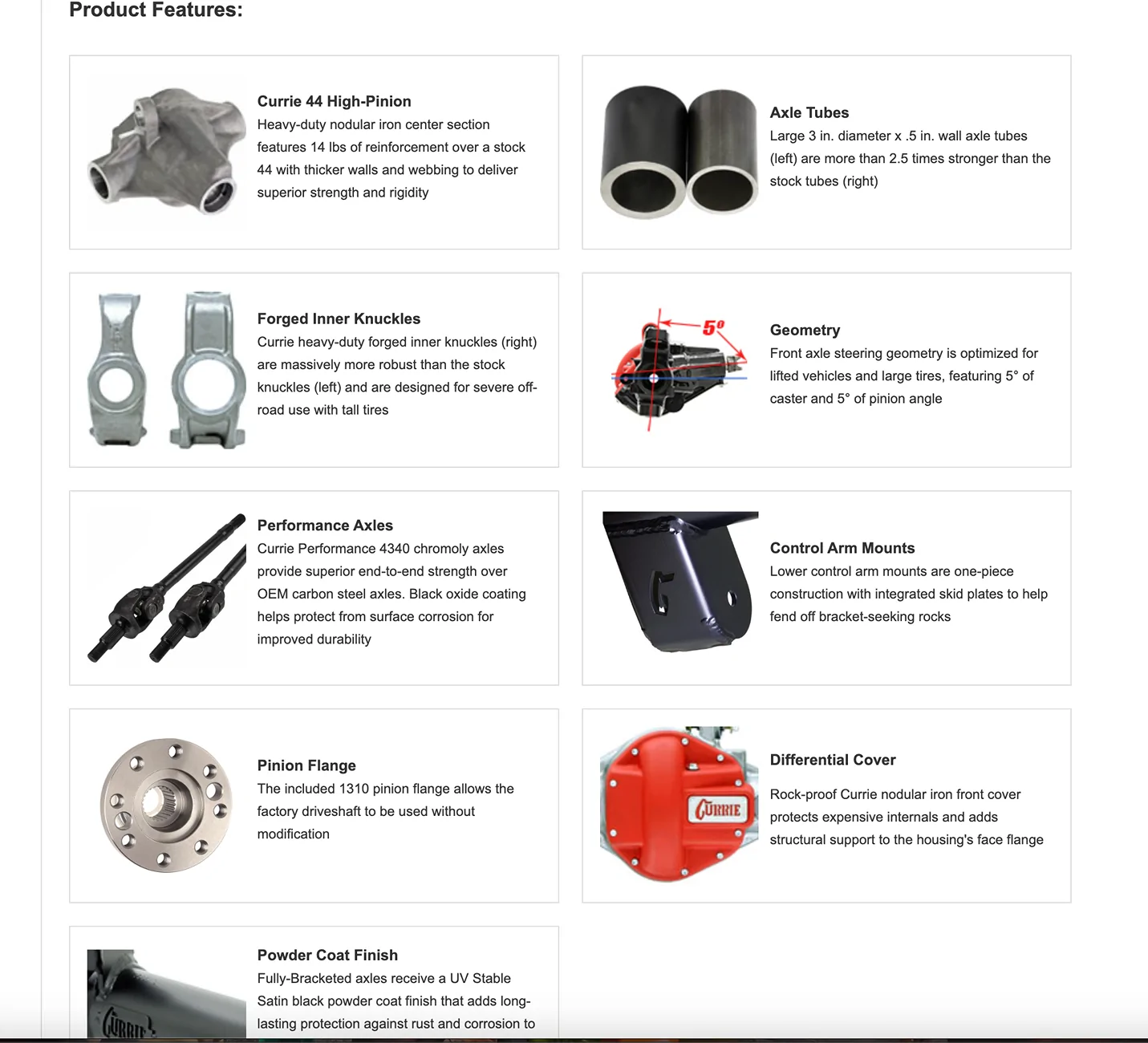

If I plan on staying with 37s for a while, ould it be better to go with an ultimate dana 44 from Currie or the hd60 that runs stock steering and brake components?
I'm leaning towards the HD60 since it is not much more. Then I can upgrade the steering later.
https://www.currie4x4.com/currie-hd60-jeep-gladiator-front-axle-assembly
ouch, that axle is $8k and you would have to regear the rear axle as it is only available with 4.56 and up gears. If it were me I would look for a take out axle or an empty housing and swap parts over with a master gear install kit. Save for tons when you are ready.

Hey Greg! I hope you are doing well buddy. I currently have 4.56 gears in my axles, so I would just pick up the Currie 44 or 60 with the 4.56 gears and elocker. I am just not sure how much to invest.

I really was hoping to find a shop that would repair and truss my axle before a full on crate axle swap. Trust me, funds are tight after our trip to Disney for my kiddo's 2nd birthday. I still may try to contact Exodus 4x4 to see if they are willing to do it because they are only 8 hours from me.
The steering should be a direct swap along with the brakes, knuckles and everything else? I think I read somewhere that I have to get an additional track bar mount for the 60 and a new driveshaft as well since it uses 1350 u joints. That adds up quick and makes the 60 swap cost closer to $10k vs the $6500 shipped to my door price of the currie 44 that is a direct swap.
Honestly, I don't want to put tons on the JT until I get another HD truck to haul it around. For now 37's get me around just fine. I still tow my toy hauler and will eventually turn my 05 TJ into a trailer queen on tons with a v8.

I get the cost is higher, but 1 is a legitimate upgrade over stock and the other is no better than a trussed stock axle in my opinion. I couldn't spend that kind of money for a slight upgrade. I'd rather find a stock axle for $1k-2k and have it trussed before I put it in than spend $6500... on a Dana44.
Yeah I hear ya, I am keeping my eye out for some rubicon take off axles in my area. I'd still have to regear the front for 4.56 (hopefully with my Revolution Gears that are just over a year old). That would bring the cost up to about half the cost of the ultimate 44 and I would still have to truss it and get stronger shafts. At that point you are better off with a brand new crate axle with thicker axle tubes, chromoly shafts, no FAD to worry about and stronger inner knuckles.
I am hoping @Northridge4x4 runs another black friday sale similar to last year, where the Currie axles were 15% off. That would bring the ultimate 44 down to $5200. Not too bad in my opinion, but I am still thinking of the 60 front for the reasons you mentioned.
