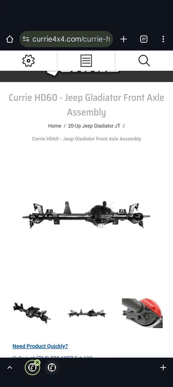

I hate you guys sometimes... Y'all talked me into getting the HD60 from Currie and the BF sale pushed me to get the heavier duty axle.
According to Currie, the only thing I'll need to swap out is the driveshaft and tie rod. The steering stabilizer should mount up with a JK stud style track bar bolt. That should get me back on the road until I upgrade the steering to the new Apex Through Shaft Ram steering.

Cool! Are you going to swap out the rear axle too? If not, how will you handle the different lug patterns?
Being stock brakes I'm guessing its the 60 that re-uses the unit bearings, knuckles, and brakes (basically the in Cs inward are new).
Zach is correct, they use the stock components. That was one of the big reasons that I went with that particular hd60.
It should allow me time to save up for the rear 1 ton (semi float is fine with me) when they go on sale next year for Black Friday.

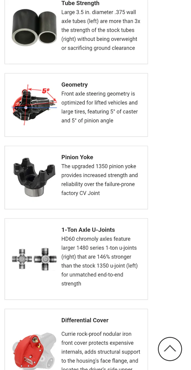

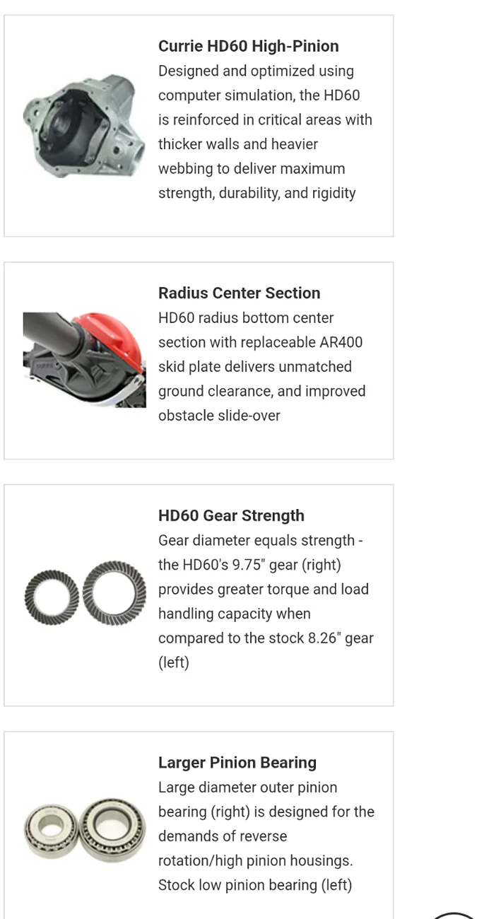

Seems pretty beefy

Seems pretty beefy
That graphic is misleading. The stock axle tube pictured is from a standard JL axle with 7mm tubes. The JT and XR package JLs get the 10mm tubes which is slightly thicker than the Currie at .395".
