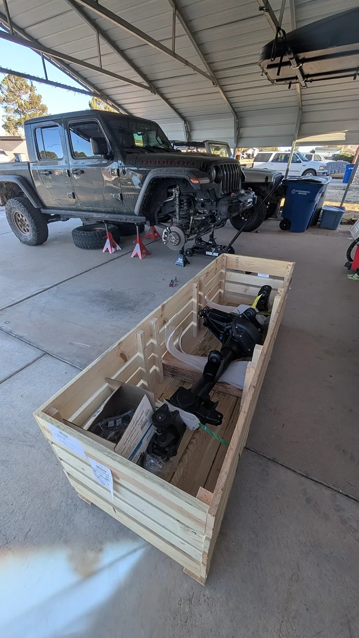

Yup, that was our conclusion earlier in the thread too. I decided to go with the dana 60 5 lug swap and it's currently under the jeep.

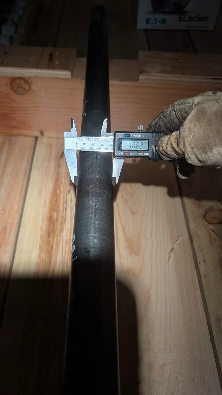

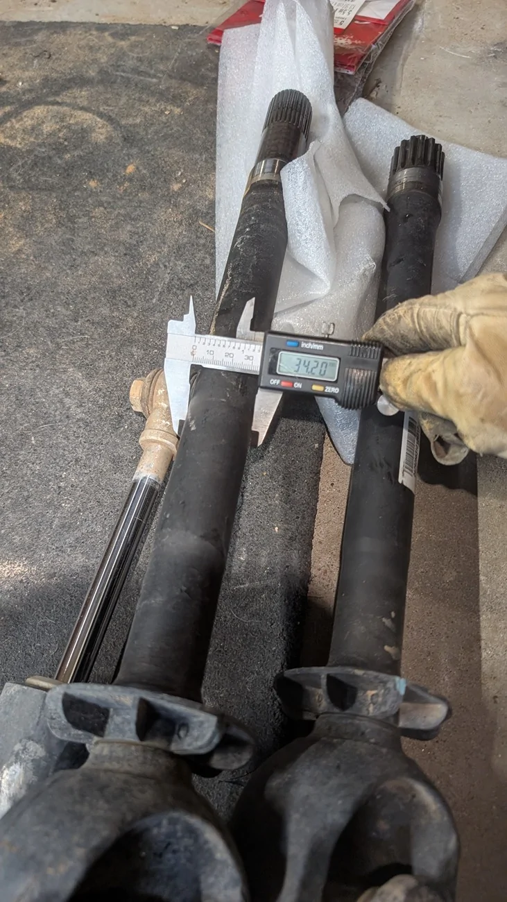

Stock Rubicon axle shaft vs the dana 60 chromoly shaft.

I guess I'll have to look into getting a 90 degree grease needle for the lower ball joints. It is odd Currie installed them with the grease fitting facing the wheel.
Also, don't be like me and install the knuckles before the axle shaft... It should be obvious that the new axle shaft is too large to fit through the knuckle because of the 1480 u joints.
Whoever pressed in that joint is an idiot.
So the knuckle has to come out to pull the axle shaft? That's a pain.
