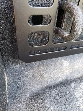

I've installed the kit on both sides. I must say the panels feel nice and sturdy, and installed wasn't too difficult except for one minor hiccup with the final bolts.
The kit shipped with 3 sets of screw/bolt/washer sets.
The T-slot nuts:
The bottom bumpers:
And, the rear bolts:
I found it was easiest to install the panels by barely threading the T-slot nuts onto the bolt, washer, and panel. Also, installing the bumpers on the bottom at this time as well:
Next, I lifted the T-slot into the trail rail at 45-60 degree angle to get the top edge in, and then pushed it up and over to seat the T-slot in the rail:
And then, I used a 10mm socket and tightened the T-slot bolts down. Finished shot:
Now, for the hiccup. I didn't have anything to have the large bolts to bite into on the bottom of the panel. I'm awaiting to find out if this is due to missing hardware or if my bed was altered when they added the bedliner. Panels still seem fairly secure, but I think the extra mount point is still needed.
They look great, and I might be adding a few more goodies here soon to them!

your bag should have had 2 big ones of these,
call Matt if you can't find em., From his install email he said, bolt-metal washer-panel-plastic spacer- box-big nut and if you don't have 2 hands use some masking tape to tape the nut to the bed then lightly thread it in.

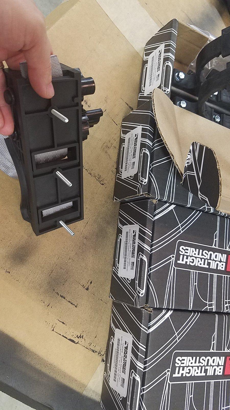

Dang it! Now you made me open the box. I was just going to put it in the pile with the rest of waiting parts. Just sides and a couple of surprises! Good, because I need to add a few more goodies to ship with the front panel. Thanks Matt @BuiltRight!
