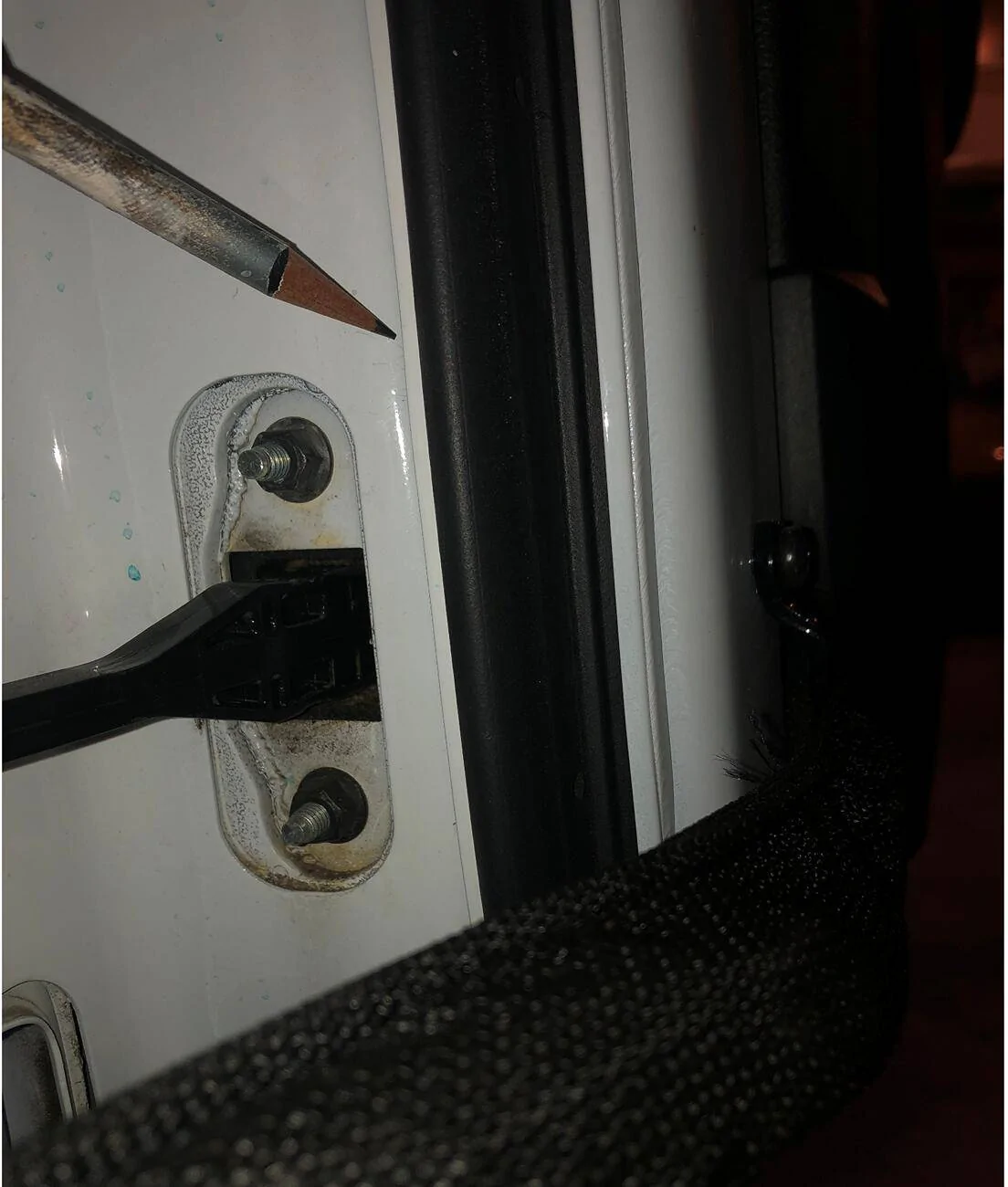

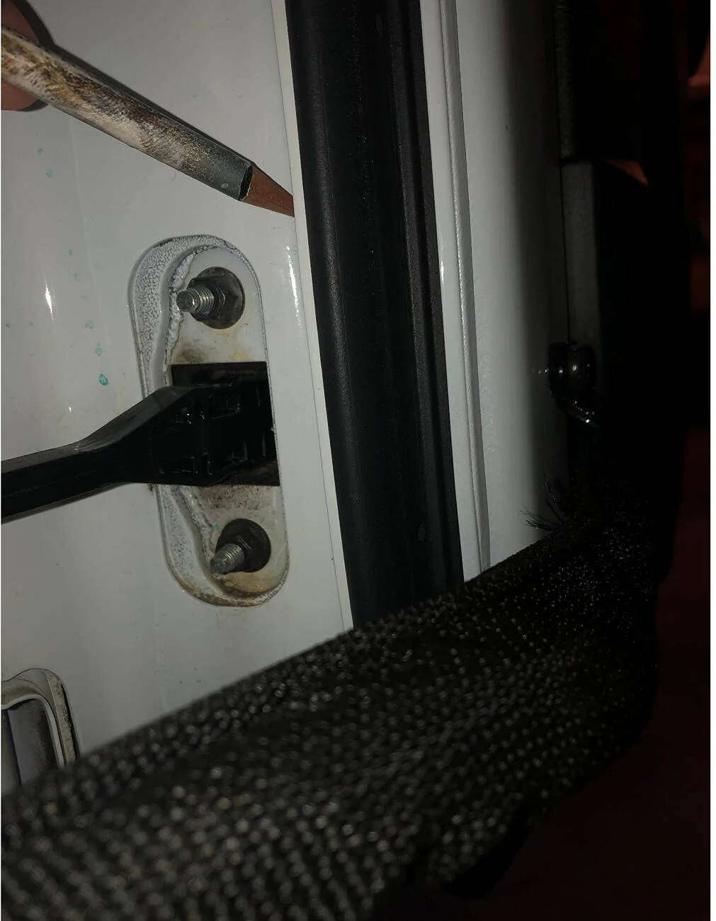

My driver's door started clicking back in 2022, when my JTM was a year old.
That was soon followed by the passenger's front door, although not as bad as the driver's door. I unhooked the door check to 'fix' the driver's door but never did anything for the passenger's front door. It would noticeably click every time the door was opened or closed.
About 2 months ago, on a whim, I applied some Boeshield to the door seam just outboard of the door seal on my clicking front passenger door. After applying the Boeshield, I opened & closed the door about 6-8 times and the noise just stopped. The clicking noise has been gone ever since. I can't believe it worked.
For those with the door clicking, you may want to try this remedy.
Here is the seam where I applied the Boeshield:
(This is the pass. side front door)
One pic shows the pencil pointing at the seam, and the other shows the pencil point inserted into the seam.
It's worth a shot.
