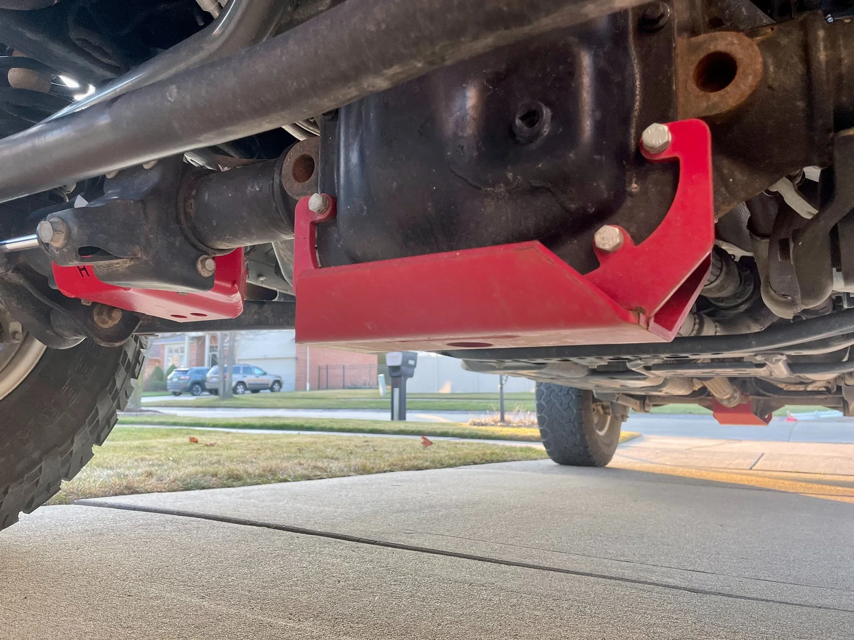

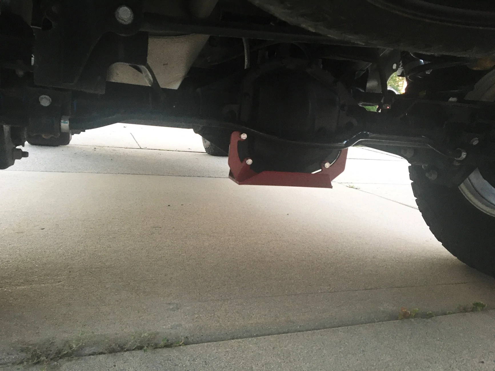

I do like the Rancho front and rear diff skids and Rockhard FAD skid. Ran the Rancho diff skids on a 2010 JKUR that I had as well.

Rancho had a nice clean install, but I like that the nvm diff skids protect the pinion.
These look really good. I was thinking on my next phase when i finish the steel skids to add dana diff covers as well a diff skid. These look clean i like it
