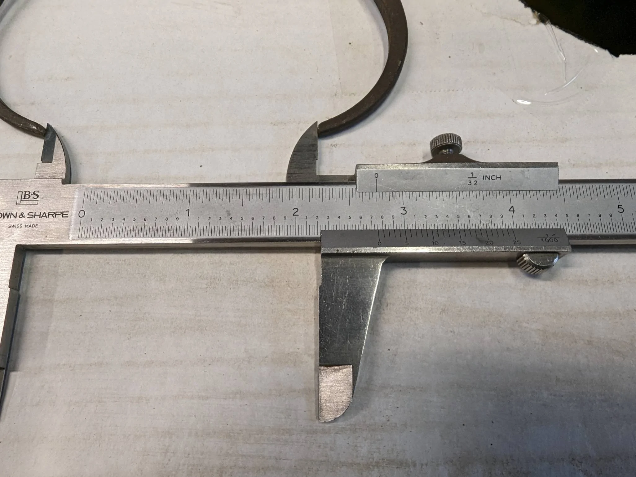

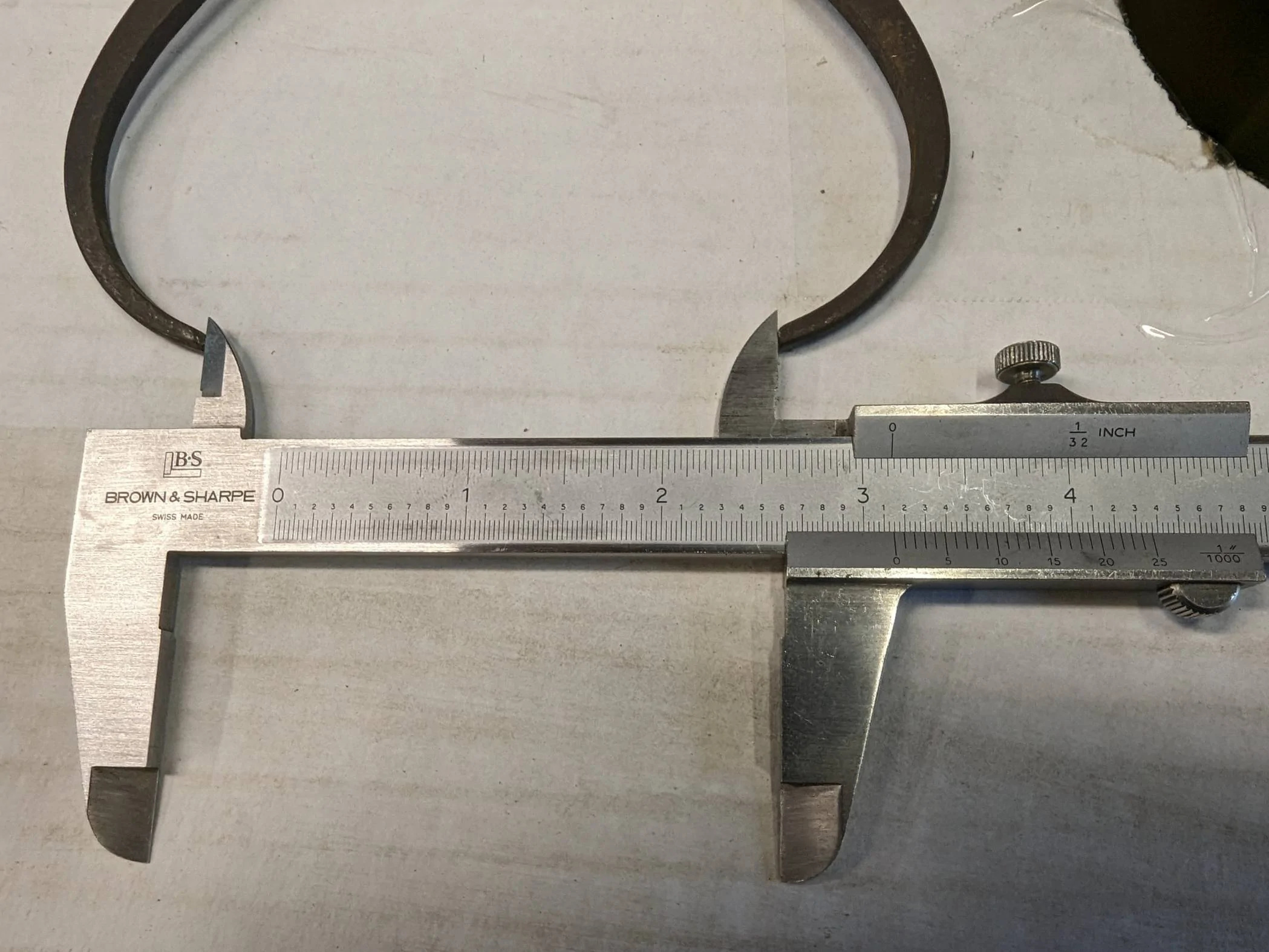

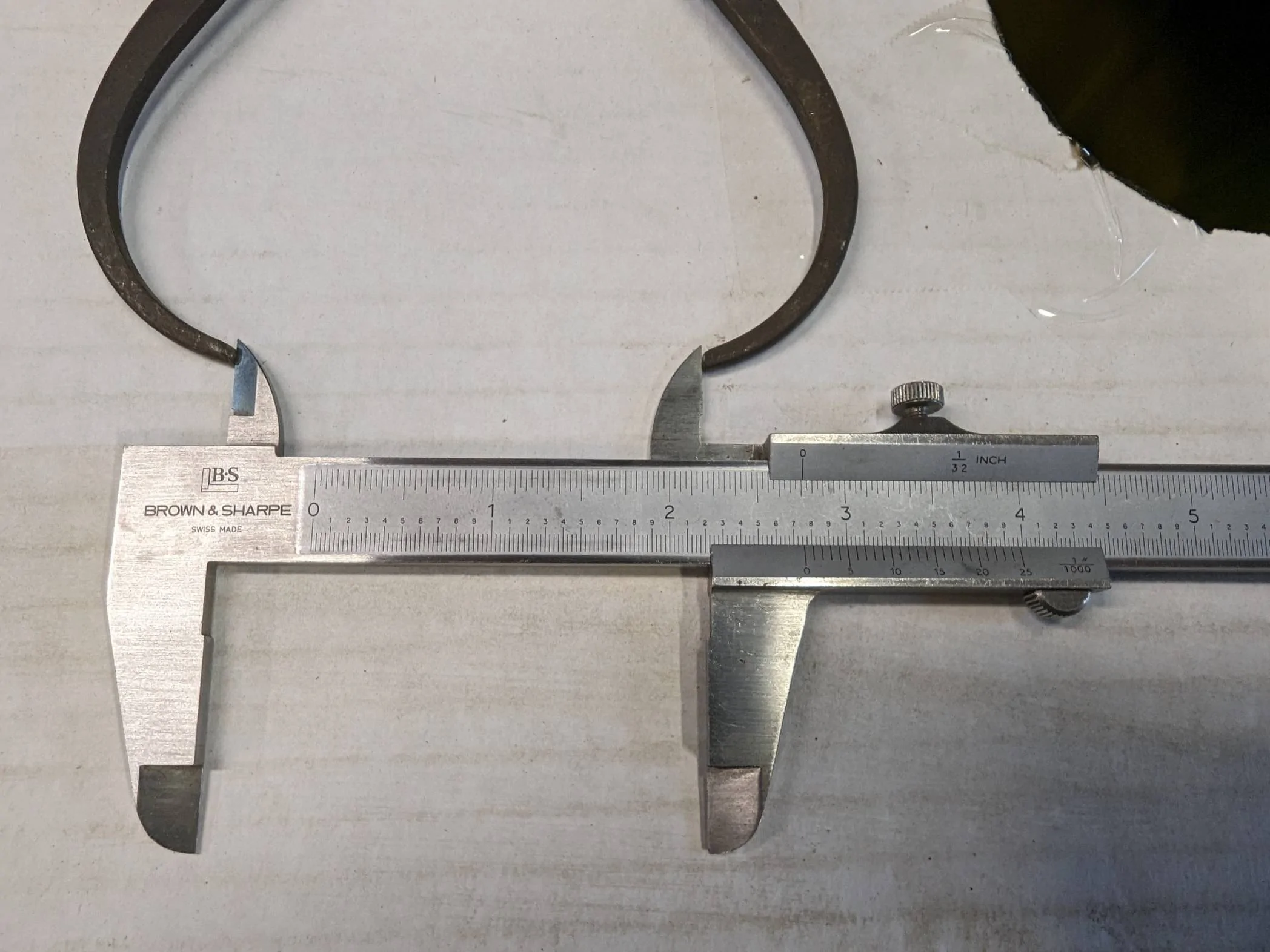

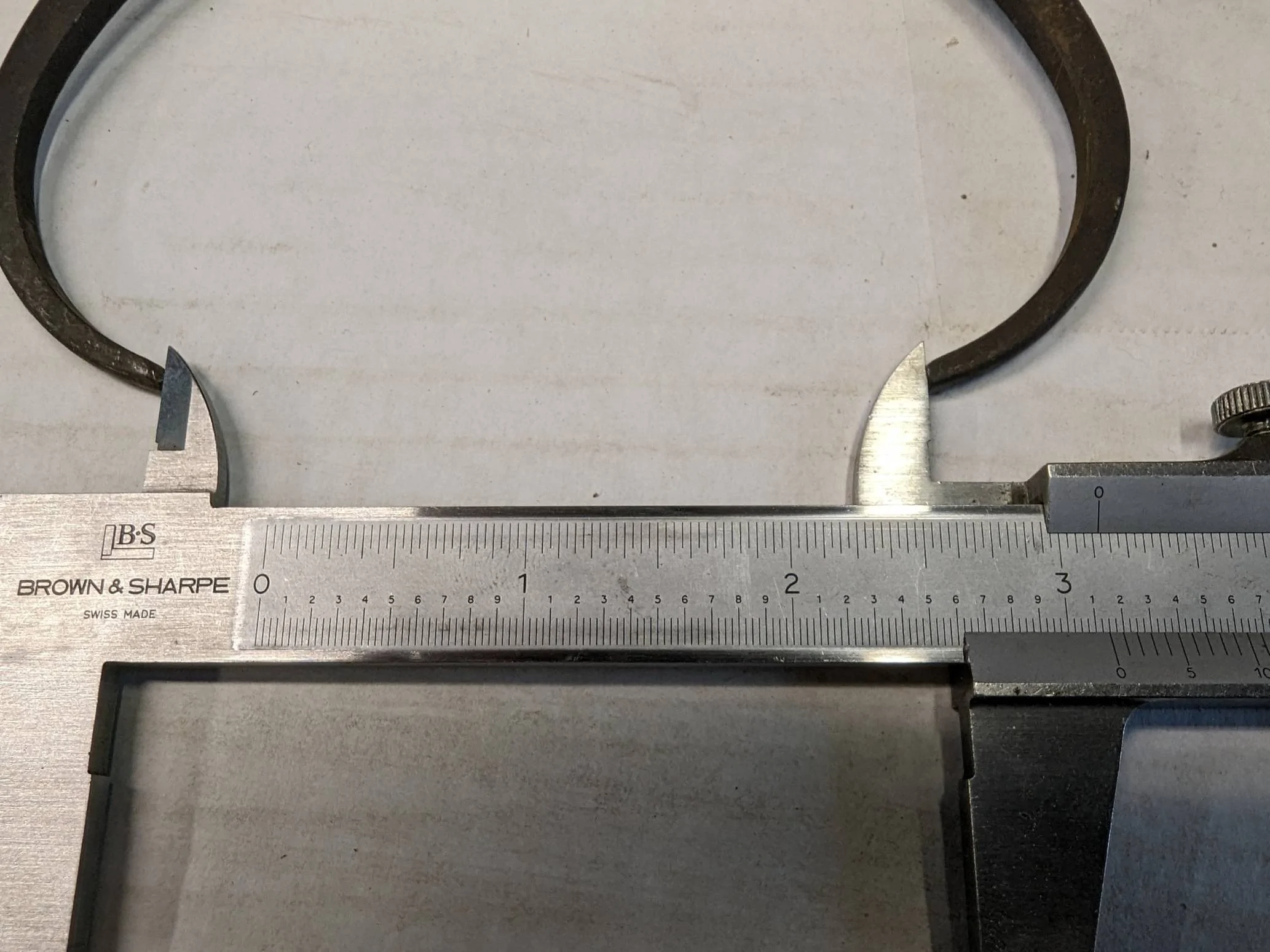

Being a very curious person............ I took my calipers and did a quick measure of the front axle tubes, and the rear axle tubes on my Overland.
One must keep in mind that the axle tubes are turned down to fit into the differential housing so they have sort of a taper in that last inch next to the cast housing.
Front axle tubes -
Jeep Gladiator Gladiator Max Tow vs Non Max tow option rip out PXL_20240406_193856585
Jeep Gladiator Gladiator Max Tow vs Non Max tow option rip out PXL_20240406_193915586

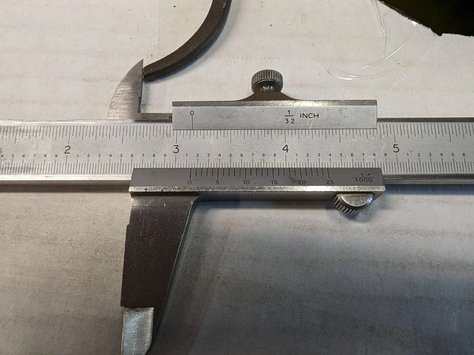

Rear axle tubes - (now if i could just remember my machine shop days and how to read this bloody darned thing)
Jeep Gladiator Gladiator Max Tow vs Non Max tow option rip out PXL_20240406_194415139
Jeep Gladiator Gladiator Max Tow vs Non Max tow option rip out PXL_20240406_194419669
Jeep Gladiator Gladiator Max Tow vs Non Max tow option rip out PXL_20240406_194423764

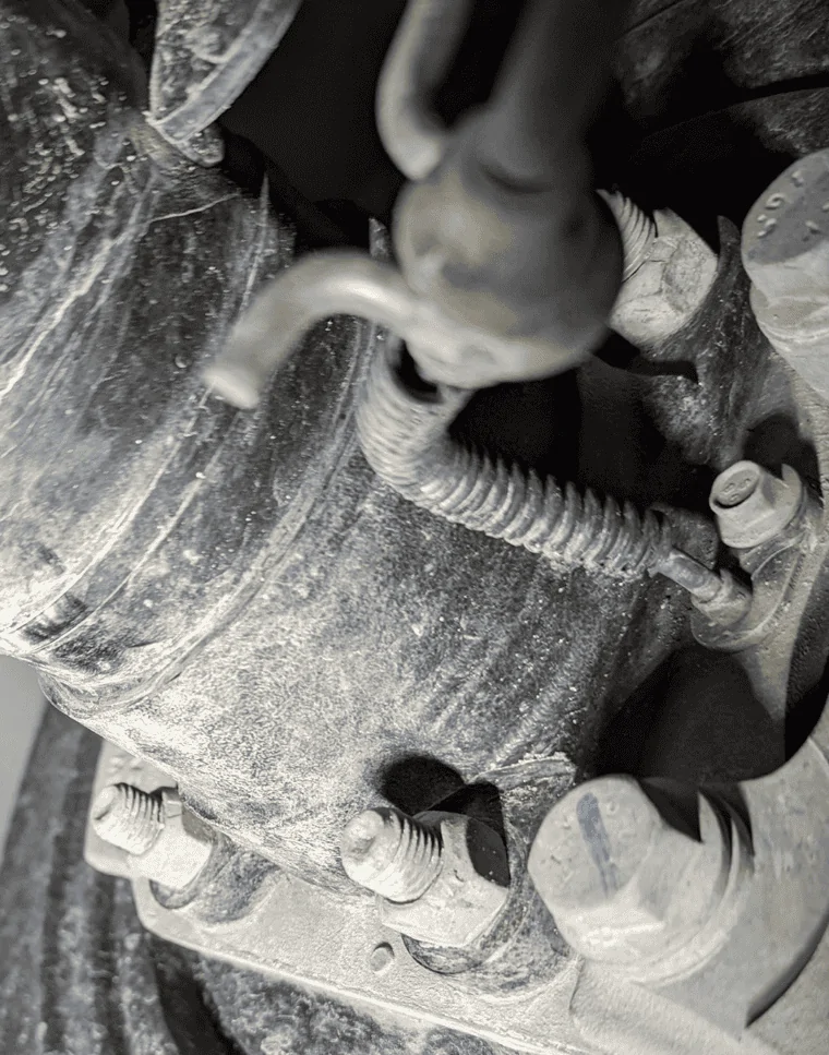

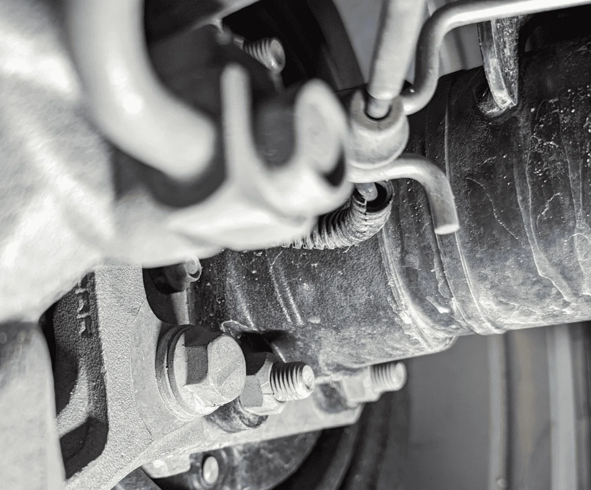

Someone at one time said their axle tubes were bigger because the bearing or seal wasn't the right fit or something - the bearing and seal don't even go into the axle tube at all - they fit into another casting on the end of the axle tube - which could be the same on all of these.
I have yet to see one where the bearing and seal fit directly into the axle tube - unless considering the INNER axle seal on the old AMC 15 and 20 axles.......
Bearings and seals go in here - not in the axle tube itself. Since this is a cast (or perhaps forged?) part, it isn't necessarily indicative of the size (wall thickness) of the axle tube itself.
Front axle tubes -

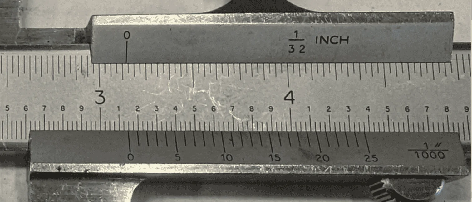

I was hoping someone really smart like @Hootbro who constantly blows me away with their knowledge (there are others here, of course, with that caliber of knowledge and intelligence) would remind me how to read my @#$% vernier caliper!

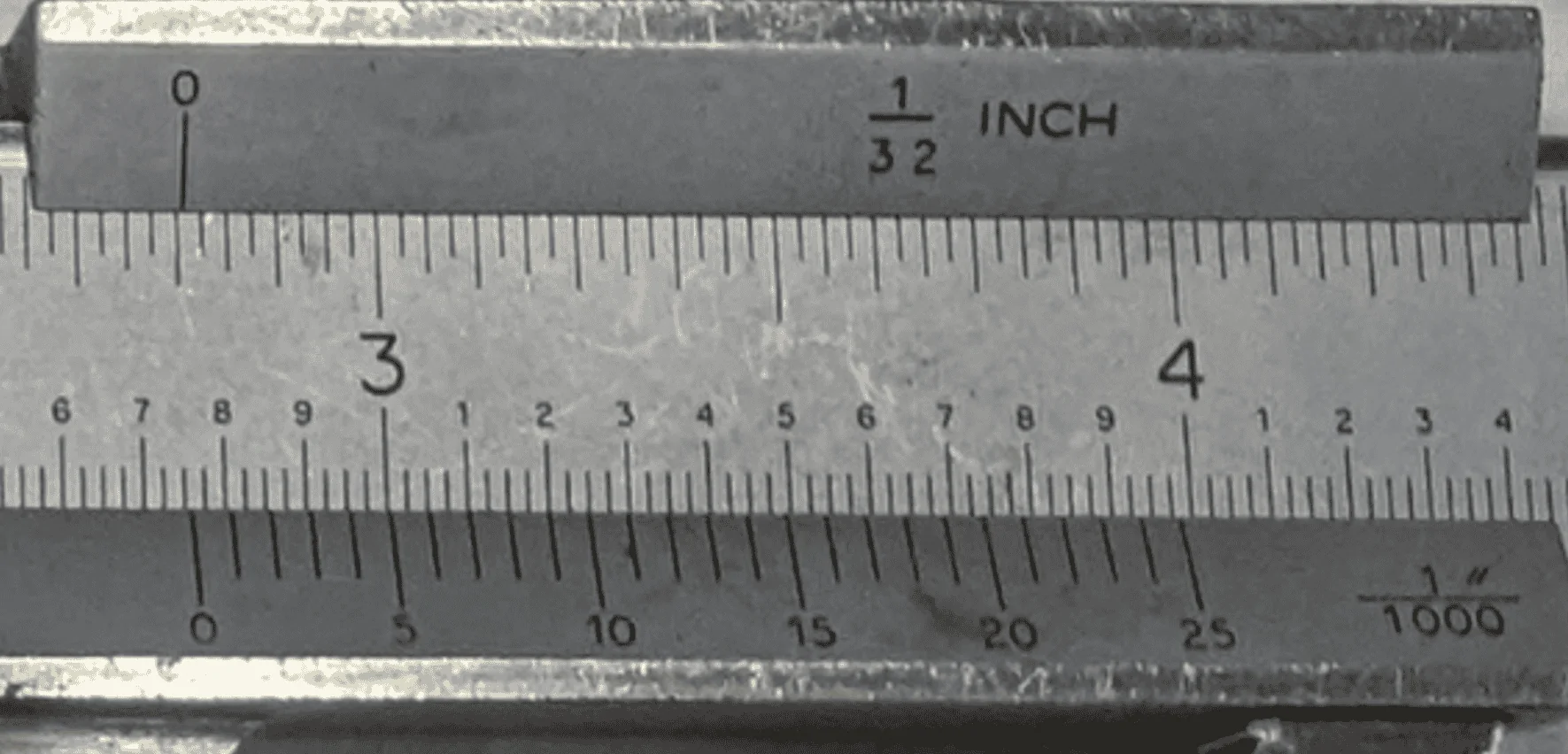

I got roughly the high side of 3 9/64" on the rears - it's just to the right of center between 3 4/32 and 3 5/32 making it just over 3 9/64 but I'll be danged, after my machine shop classes, learning these things in college and then using 'em for a while after that - I just don't use one enough to recall (and I'll blame the anti-headache drug, which has really nasty side effects)
This also has a thousandths of an inch scale (lower scale - might be able to click the pic to get a better look)
Rear -
Jeep Gladiator Gladiator Max Tow vs Non Max tow option rip out 1712499051997-53
Front -
Jeep Gladiator Gladiator Max Tow vs Non Max tow option rip out 1712499241354-1z
So I admit - forgot totally how to read the thing.
I could have gotten out my big micrometer set and pulled the 3 and 4 inch mics out but on a not really smooth tube, I figured the outside caliper would get "close enough".
Don't do so much engine building these days so the big micrometers are buried a bit. I only have the 1 and 2 inch ones handy in a drawer.

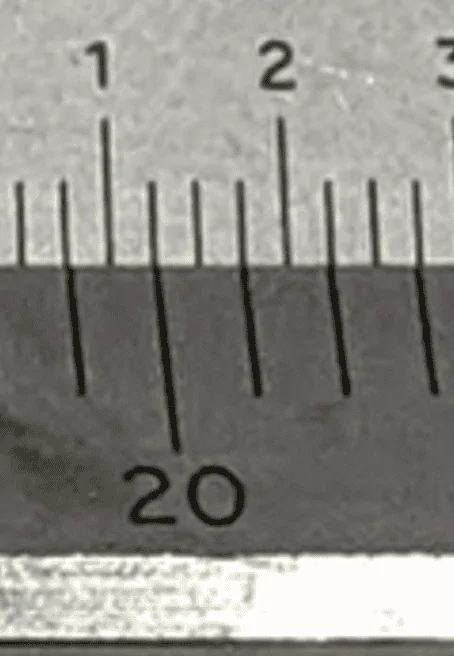

3.125 + 0.020= 3.145
You can tell it's just under 3.150, so you find the number most closely aligned on the lower scale with a graduation on the upper scale, which is 20 (it might be 21 or 22: hard to tell with parallax.)

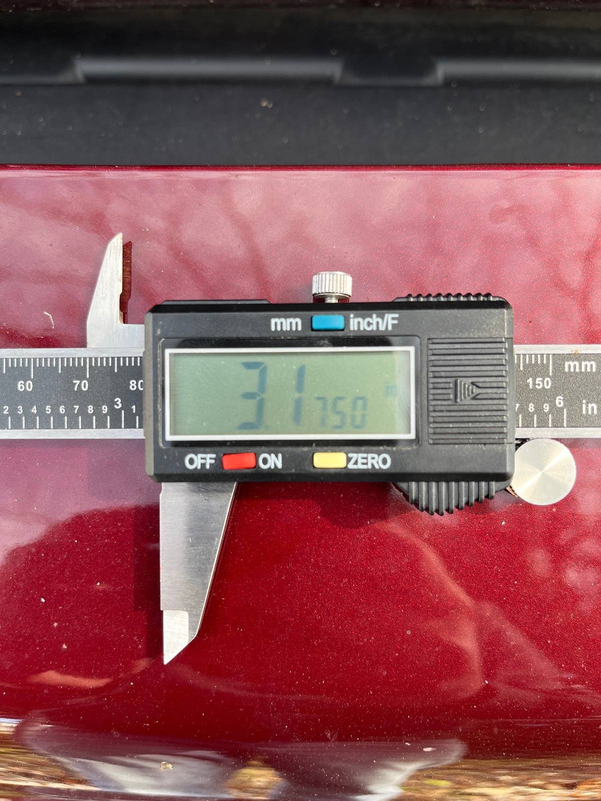

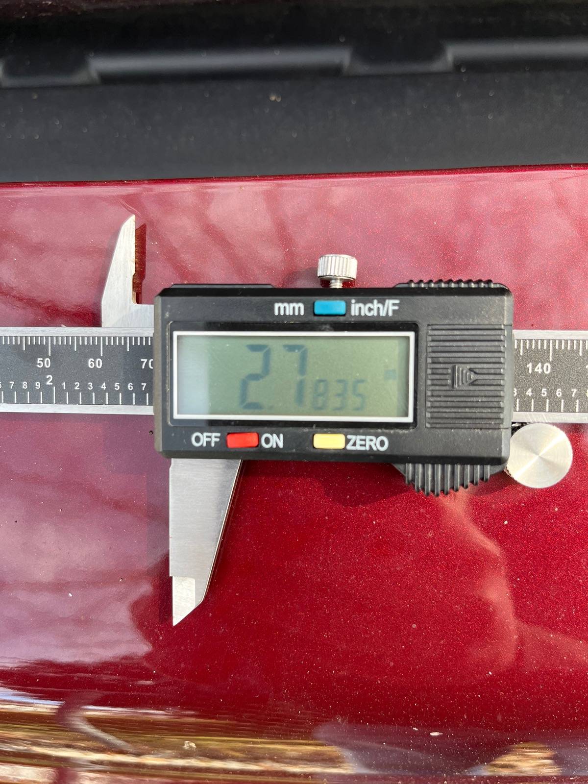

I just measured mine which is a High Altitude with the wide axles.
Jeep Gladiator Gladiator Max Tow vs Non Max tow option rip out IMG_1290
Jeep Gladiator Gladiator Max Tow vs Non Max tow option rip out IMG_1291
Thanks for that.
Grabbed another shot - 21 looks better - but then that's picking nits when we're at the ten thousandths place measuring a used outside dimension.
Jeep Gladiator Gladiator Max Tow vs Non Max tow option rip out 1712508740733-2g
3.146 = ~ 79.91mm
Ryan's -
3.175 =~ 80.65mm
So really we're inside a margin of error - not even 1mm apart.
My using outside calipers and then transferring to vernier caliper could account for some of that. Time to dig the mic out, perhaps LOL
Ryan's front axle tube -
2.78 = ~ 70.7mm
Mine -
2.759? = ~ 70.08mm
Fractions of a mm apart and within margins of error when transferring from one caliper to another.
Unless someone has other thoughts, I'd say it looks like the outer dimensions are the same?
