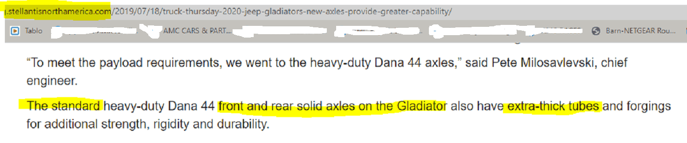

Everything I have found from reliable sources is that Gladiator got thicker axle tubes - but that it was across the JT line, not limited to Rubicon or wide axles, etc.
Like I said - the rags/blogs/magazines too often twisted the order of words and left our commas.
All you have to do is drop a single comma, or ignore a pause in speech when someone is talking about them to mix things up.
Listen to someone speaking and saying "Gladiator gets axle tubes 10mm (slight pause) thicker than Wrangler.
Suddenly in the game of telephone/journalism, that becomes something that it isn't.

This is easy to confirm. Someone with a Rubicon measure the outside of there axle tube and someone with max Tow measure theirs and someone with a Mojave measure theirs.
Unfortunately I painted my rears with very thick POR15, so my measurements wouldn't help us ..
That will confirm the outside diameter, but not the tube thickness.
I get a 404 error when I try to access that web address.

No, not 10mm thicker, it's 10mm compared to 8mm of Wrangler.
And I have screen shots of articles stating that all Gladiators got that.
People keep saying "10mm thicker" when it's 10mm, not 10mm thicker, and it's compared to 8mm Wrangler.
The Wrangler has 8mm thick wall axle tubes.
Gladiator has 10mm thick wall axle tubes.
Mojave has thicker - but 10mm thicker would imply 3/8" of an inch added to an already 3/8" thick tube wall making that front axle tube 3/4" thick!
All Gladiators are supposed to have 10mm thick axle tubes - that was compared early on to the Wrangler at 8mm. Jeep said "Gladiator gets 10mm thick axle tubes" - that's compared to Wrangler.
Imagine axle tubes over 3/4" thick because 10mm is over 3/8" thick and if you say "10mm thicker" than an already 10mm thick axle tube you are adding almost 7/16" to an already over 3/8" thick wall because 10 mm is over 3/8", almost 7/16" thick.
2 mm thicker makes perfect sense. That´s 20% greater thickness and likely, strength. Any more than that really does not make mathematical or practical sense.
If it is 2mm wall thickness the outside diameter should be bigger. It the wall thicknes was just going inward they would have to use completely different bushings and bearings.
I could also measure my JLU tube outside diameter to see if that is the same or different than the gladiator
Now the final question is, Is that 2mm difference between the JL Dana 30 and the JT Dana 44 or between the JL Dana 44 and the JT Dana 44
