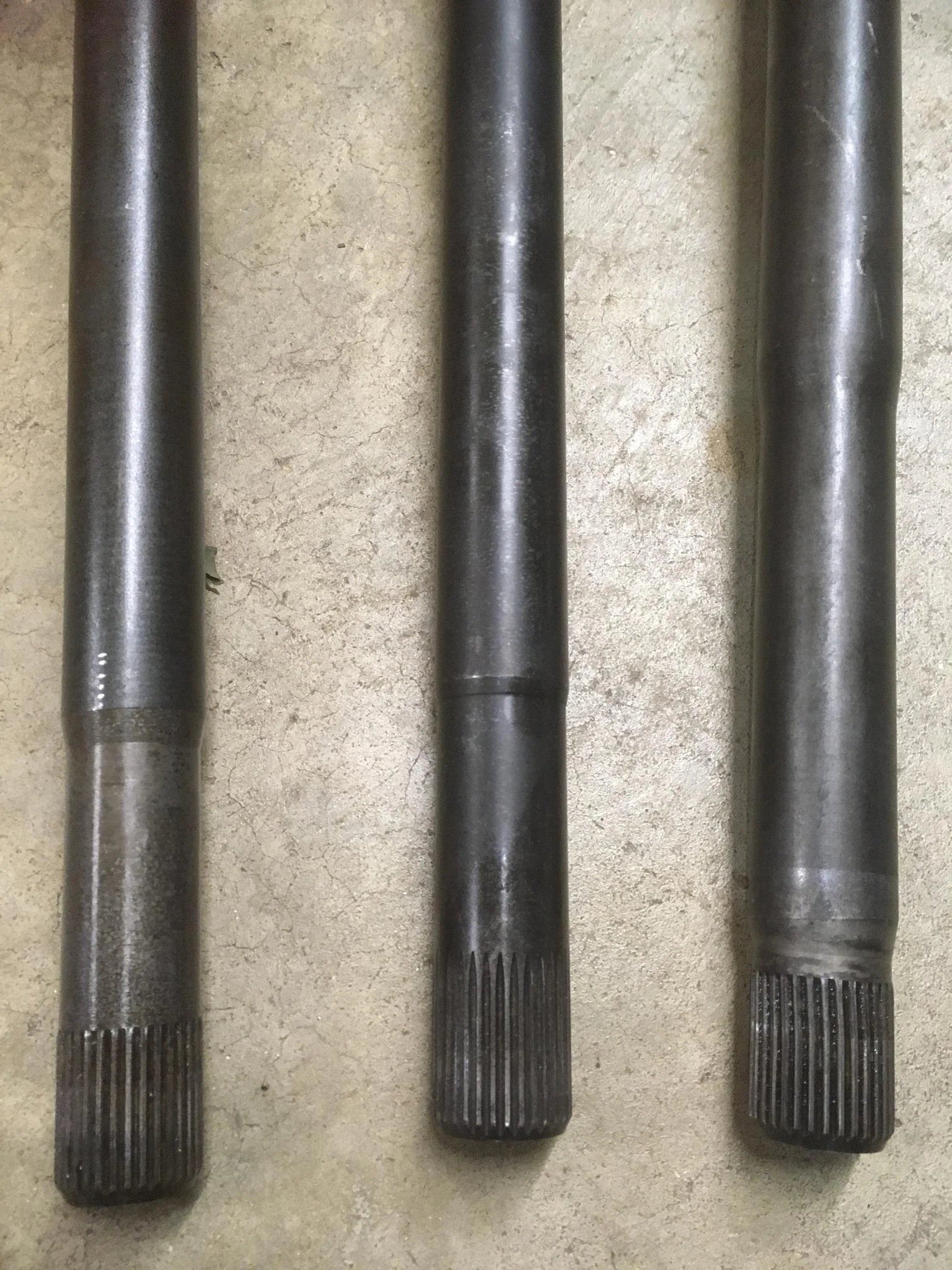

Well the stock shafts from the rear of my Jl fit the jt. Both rubicons. I assume internals are the same on each. Thanks
The shafts will interchange between the JL and JT, but the JT rear shafts have a different profile (JT shaft is on the right, JL shaft on the left, and Dana chromoly in the middle). I used some rear JL shafts temporarily after bending the flange on mine. I’ve also swapped the stock fronts with a JL, and they are identical.

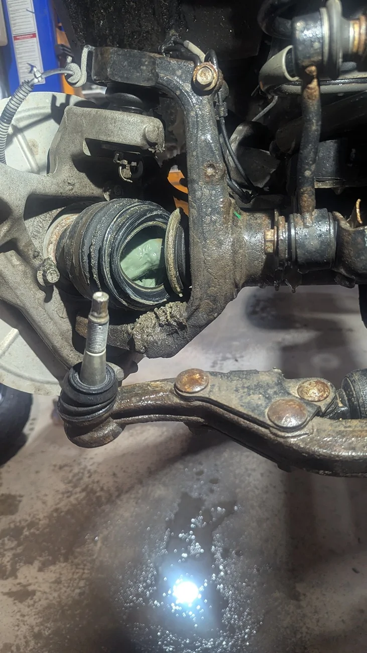

I'd rather not have it. My second one I'm replacing. Can't buy a CV boot separately, and the whole axle is on back order and expensive.
Sorry to see that. I didn’t have any issues with mine. Have you looked for an aftermarket boot, and have you confirmed it can’t be ordered with @AllMoparParts.com (Benny)?
