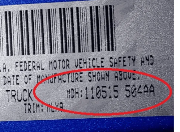

Likely a running change, meaning that the BUILD date will be the determining factor, not model year.
Some 2022 may have u-joints, some may have CV, most likely based on when it was built.
Show the MDH from the sticker on the door jamb -
for example, this 2020 was made November 5th (2019) 1500 hours (3pm)

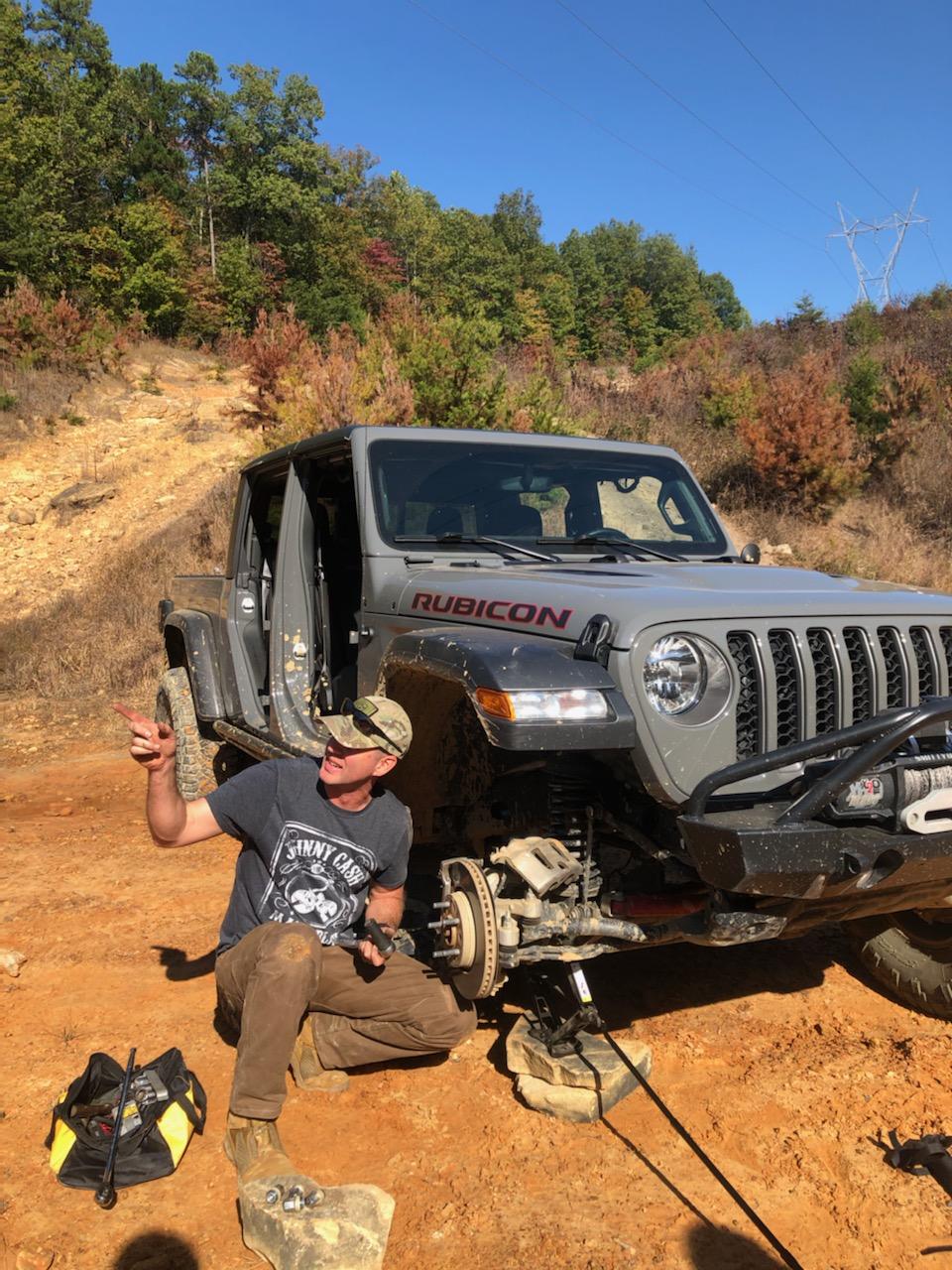

Having ejected multiple c-clips which resulted in broken u-joints (even had one half installed from the factory on a JK), I’ll take a slightly less-strong CV over a jerkey u-joint.
